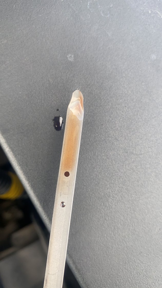

Ok well I’ve been reading and searching on more on google cause the threads on here pop up easier lol..anyway…So we’re gonna do my fluid change 3x3 and one post said not to drive it just go through them for 30 seconds/drive on the freeway 15mins/drive slow going through all the gears then come back drain and fill…etc. does anyone have a more solid answer or proper way to do this? Or is it all gonna do the same? Thanks Y’all in advance…I’m trying to keep 🃏 going strong lol…also this is the fluid I think prior owner kept it up to? What y’all think?

Fluid looks fairly clean from what I can see.
some people may say that doing a 3x3 without actually driving is just wasting perfectly good fluid, and that you should maybe do a 1x3 every oil change, while others may disagree.
you're going to get a mix of opinions, but there's no true correct way.

Oh very true sorry about that. She’s a 2007 type-s and at 103,867 miles.
as far as regularly not sure that why I posted the pic I got her about 2 months ago. They did the timing pump and tensioner before I got her but nothing about the fluid

I did it both ways with my 07.
Sometimes I would just do when I did the oil change (1x about every 6000 miles for 3 cycles), and sometimes after a few hundred miles (3x and then lets it go for 30k - 40k btw changes).
My transmission was at 305,000 when I sold the car and it was in great shape. I think the key is to keep it clean. Keep and eye on it and when it starts to change from red or you get to 30k or 40k, do it again. With the dipstick the job is super easy.
The 07 were much improved from earlier years, so take care of it and it will run forever. Enjoy!
