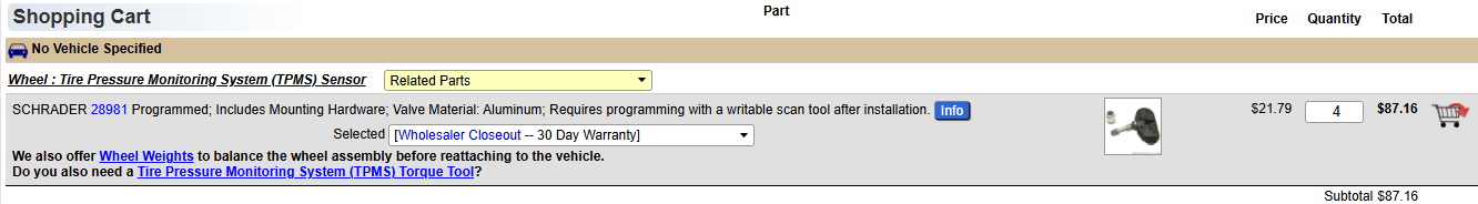

Just an FYI, do yourself a favor and try and find any aftermarket part you purchase for the 2008 TL on RockAuto first, before pulling the trigger at a local convenient auto parts store.
You may save large $$; however, if you insist on giving them your hard-earned cheddar, then by all means.
These state that they need programming though; therefore, they probably won't suit your fancy?
I take that back, since it states 'follow OE relearn procedure' below?

No programming required on the 3g TL for TPMS
