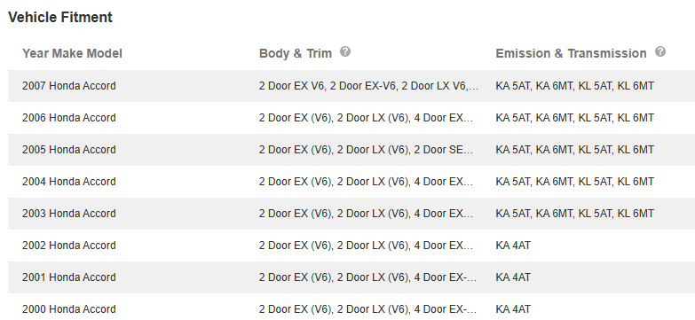

I'm presuming the J30A engine you have is one of those low mile JDM's (Japanese Domestic Market) that are on Acura/Honda replacement engine websites??
What's different about the VTEC valve between the two??
J32A3:
2004-2006 Acura Tl 3.2L V6 J32A3 Engine and 6speed DEC6 Transmission | eBay
J30A:
2003 2004 2005 2006 2007 Honda Accord Engine 3.0L 6 Cylinders J30A (VI – Dmv Jdm Motors
the VTEC valve is in a different location than the original J32 engine in my Acura TL
Which part is in a different location on the J32A3 #10 spool valve assembly versus the J30A??
Not meaning to add further 'insult to injury'; however, you would of been better off asking here first (before engine purchase), what other engine than a J32A3 could have been 'swapped' into my Base 2004 TL??
The reply would have been an upgrade to a readily available USDM J35A6 out of the 05+ Odyssey (LX/EX only) which is almost a direct drop in.
