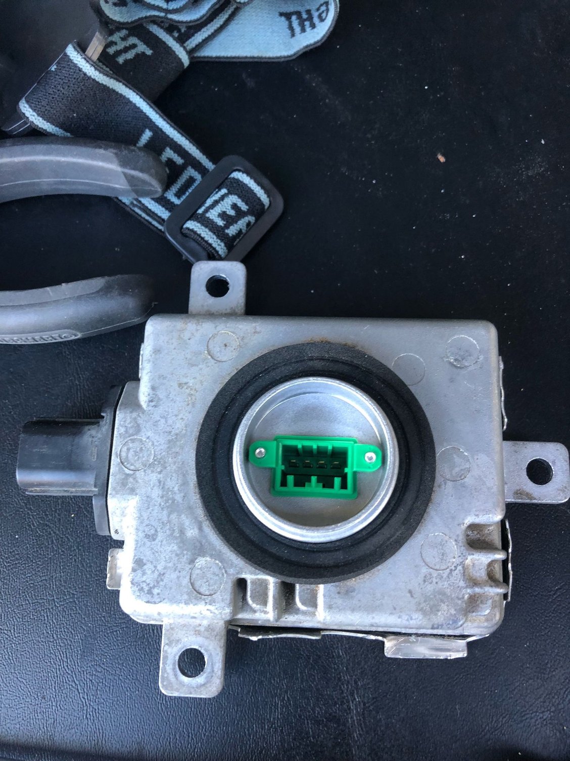

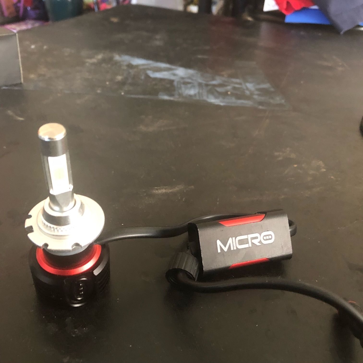

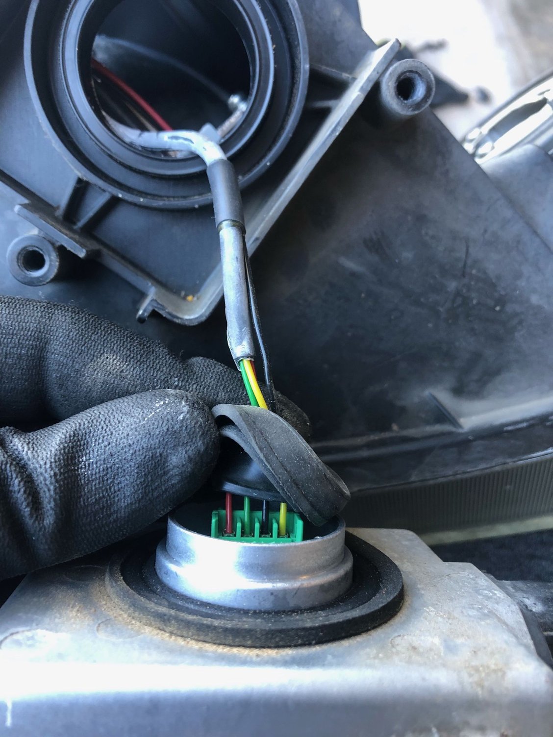

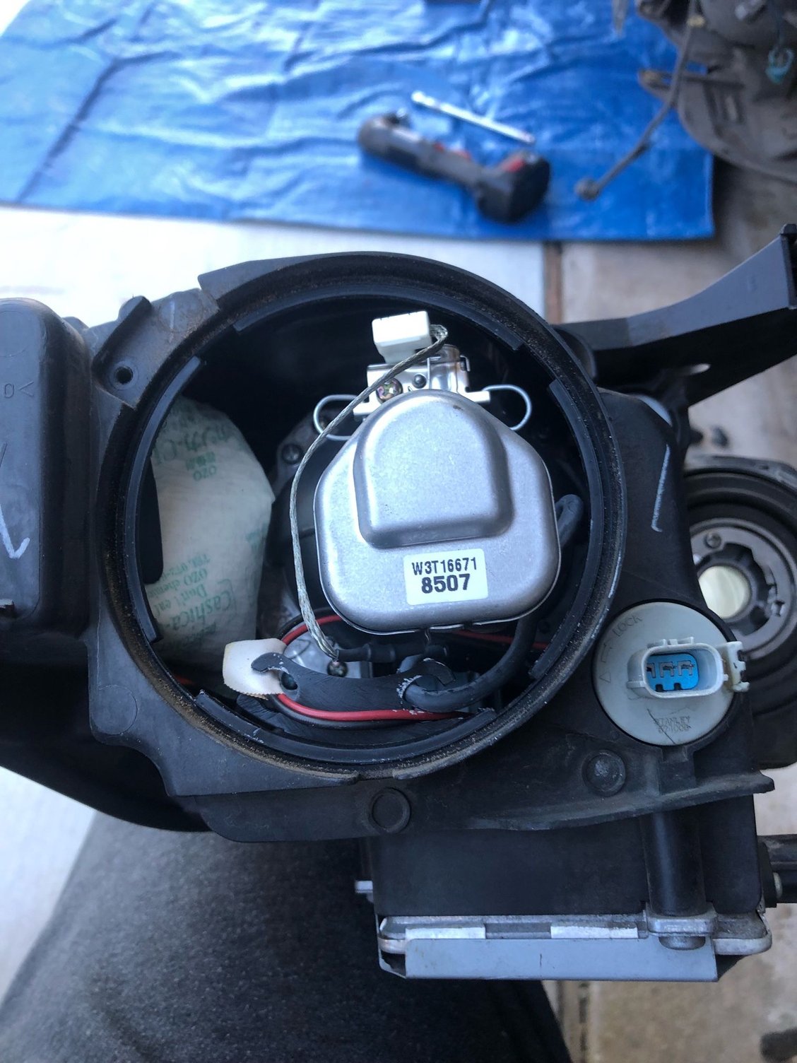

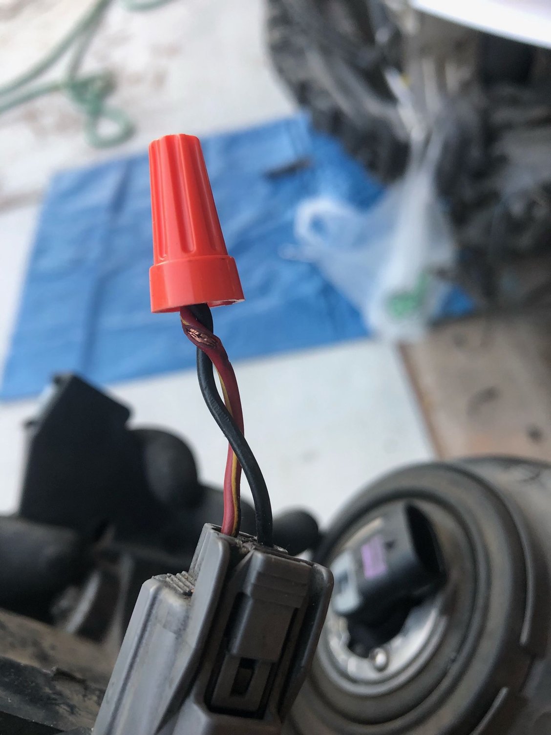

First pics are the sealed connection wire, wire that taps the HID harness, and bulb.
HID with ballast underneath

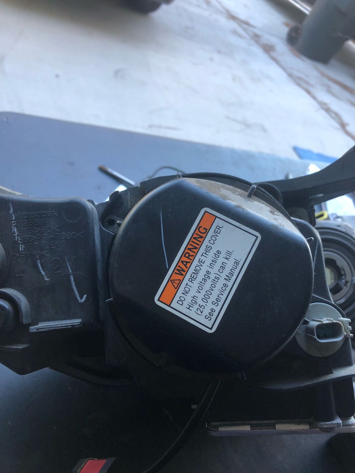

Removed the three screws holding the ballast, disconnected the standard connector, and removed HID bulb / socket from housing

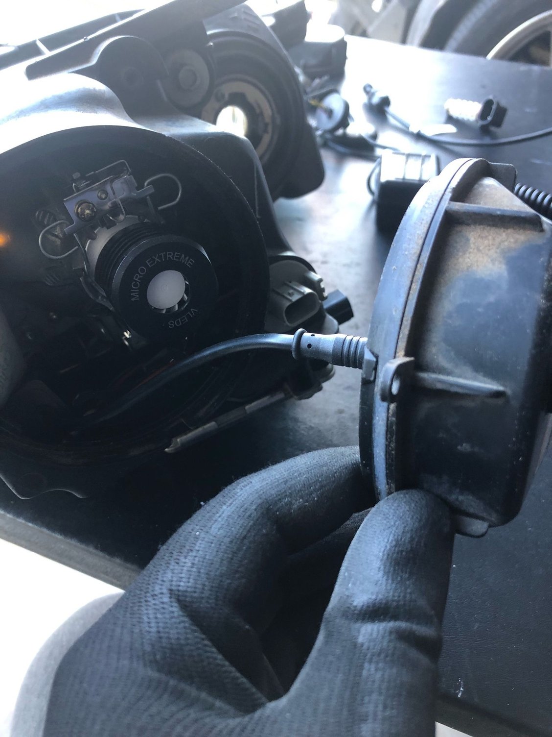

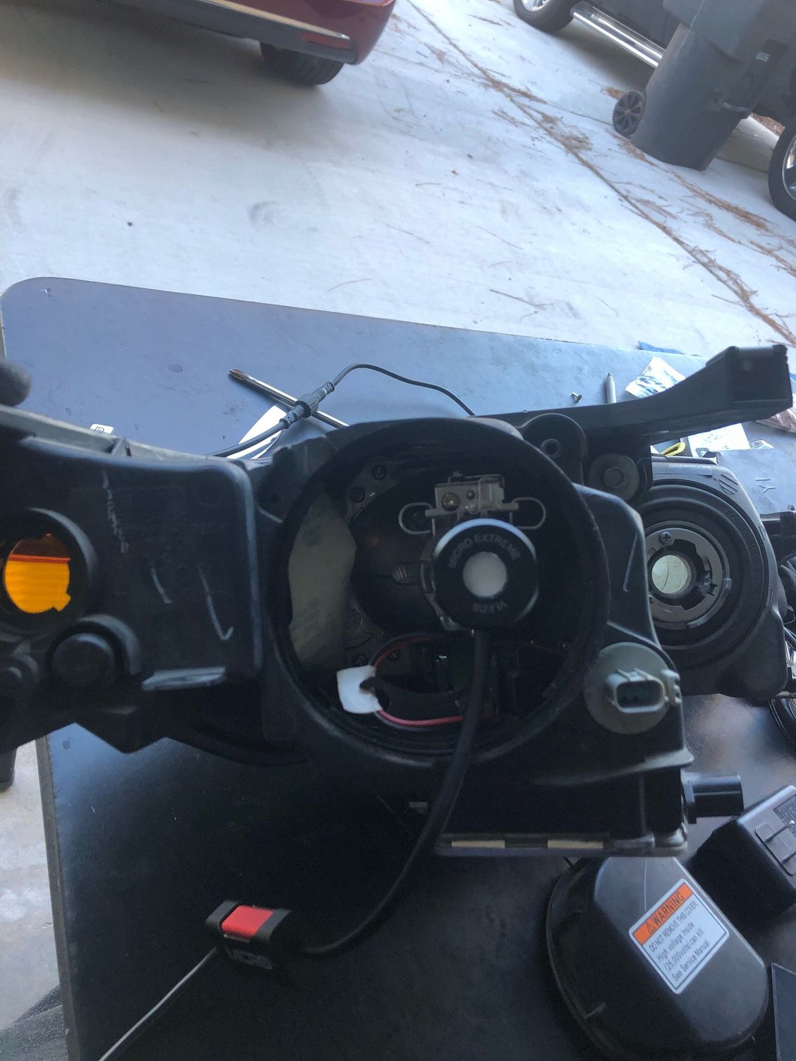

Re-attached ballast (to avoid moisture) and inserted the LED with zero modifications

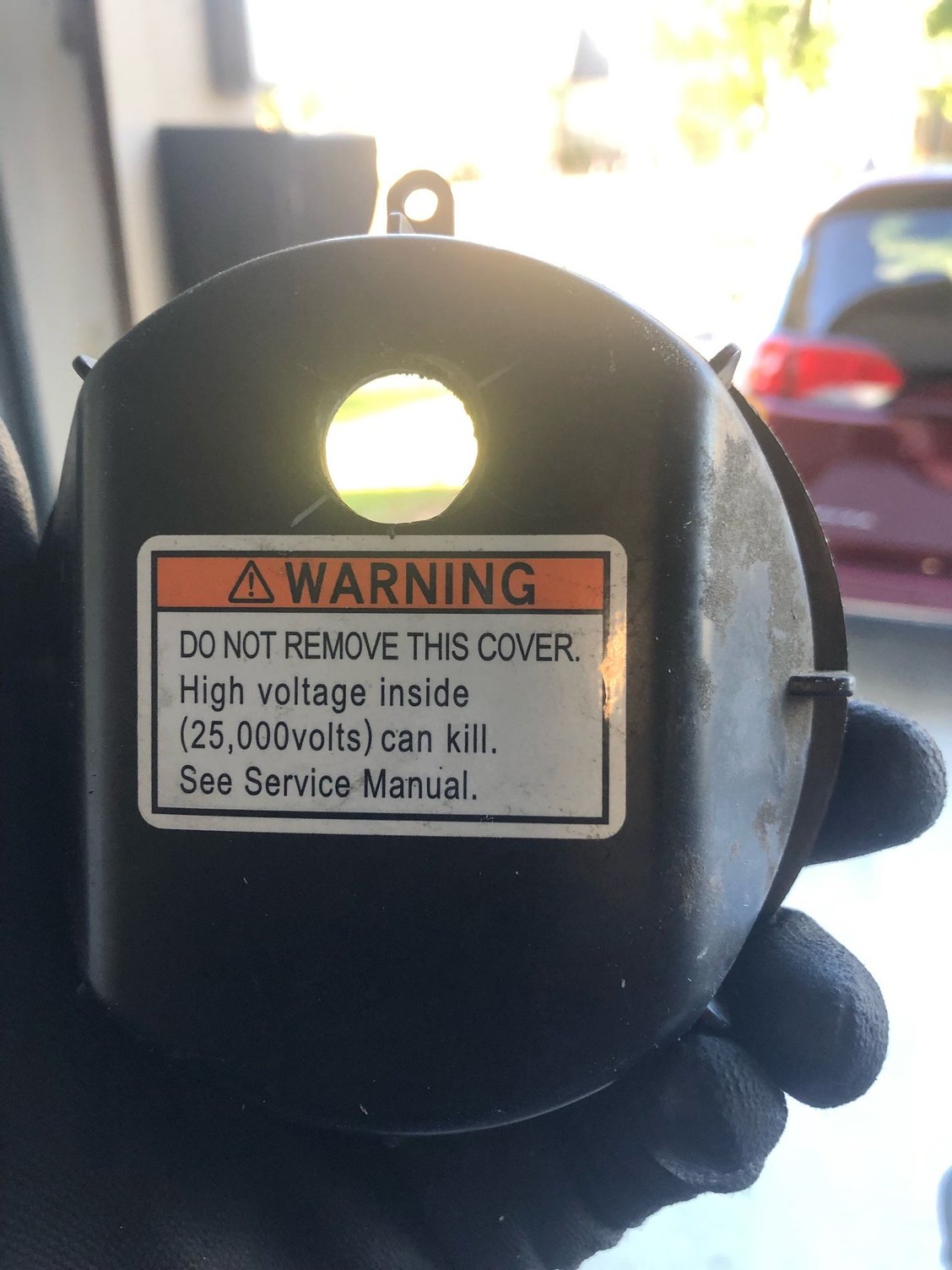

Had 2 concerns in this project. First was the dust cap clearance but luckily, goes on unobstructed. Second concern is towards the end
To avoid drilling into the housing itself, I dremeled a hole into dust cap in the area left of LED. Guessing every WARNING label is placed the same on every cap so right above it
Double-sided taped the MICRO box running from the LED and placed it on flat area right beneath the projector housing

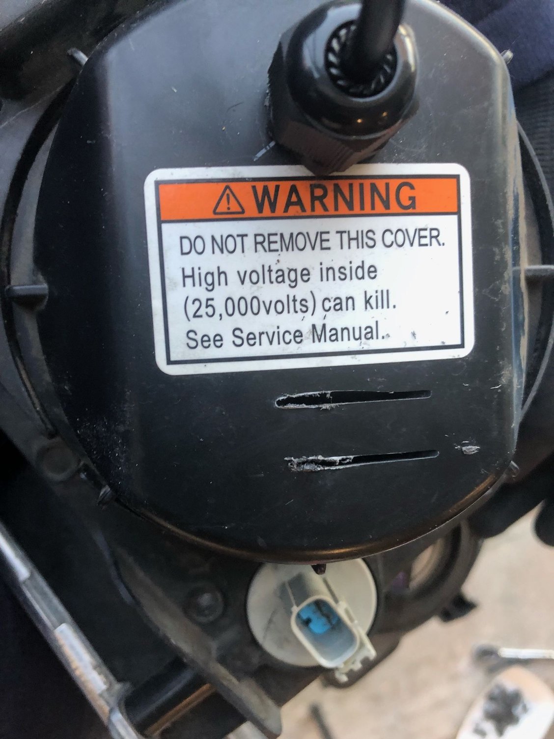

Kinda defeats the purpose of 100% sealing the housing, but cut two slits into caps so the LED fans have somewhere to exhaust air. Can cover slits if they become problematic

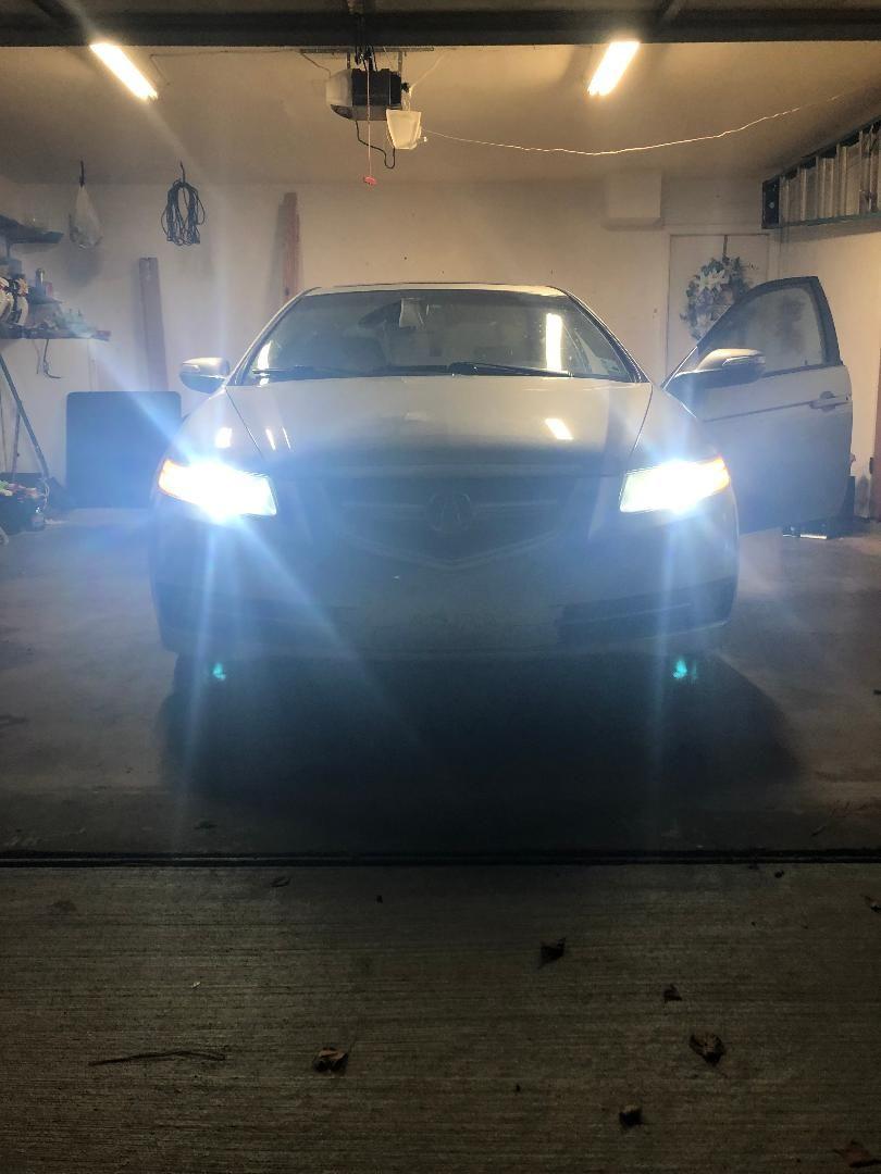

Lights shine just as bright and throws about the same output to me.

thank you for the write up! How is the cut off with the new LED bulbs? DO you notice more brightness at night when driving? Can you snap a few pics with the lights on, with the car on the street/parking lot?

OP can you also take a pic from 25ft back from a wall or garage door to see the cutoff?

You are right about the water! OP, you might want to put a mesh screen or something to prevent water/bugs from getting in.

But why use wire nuts though?

I have holes in dust caps since 7 years and had no problems with 💦 Just drilled the caps, put the wire through without any sealing.
