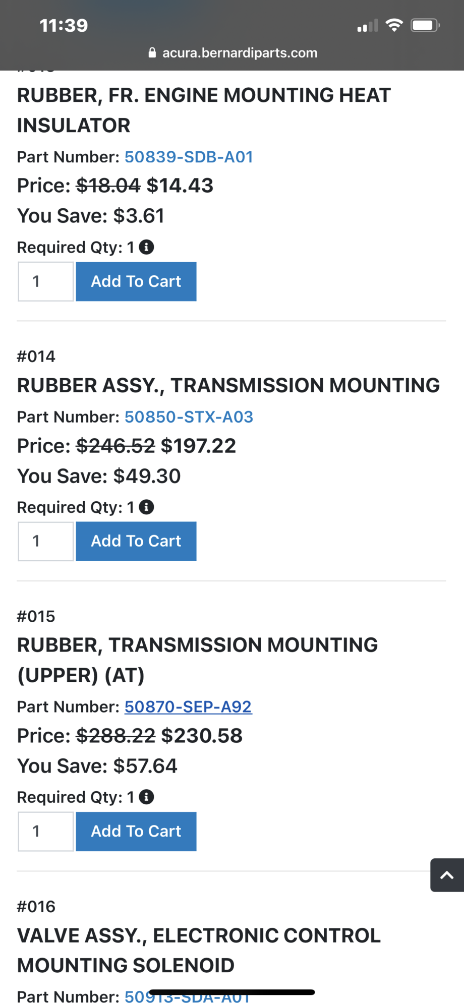

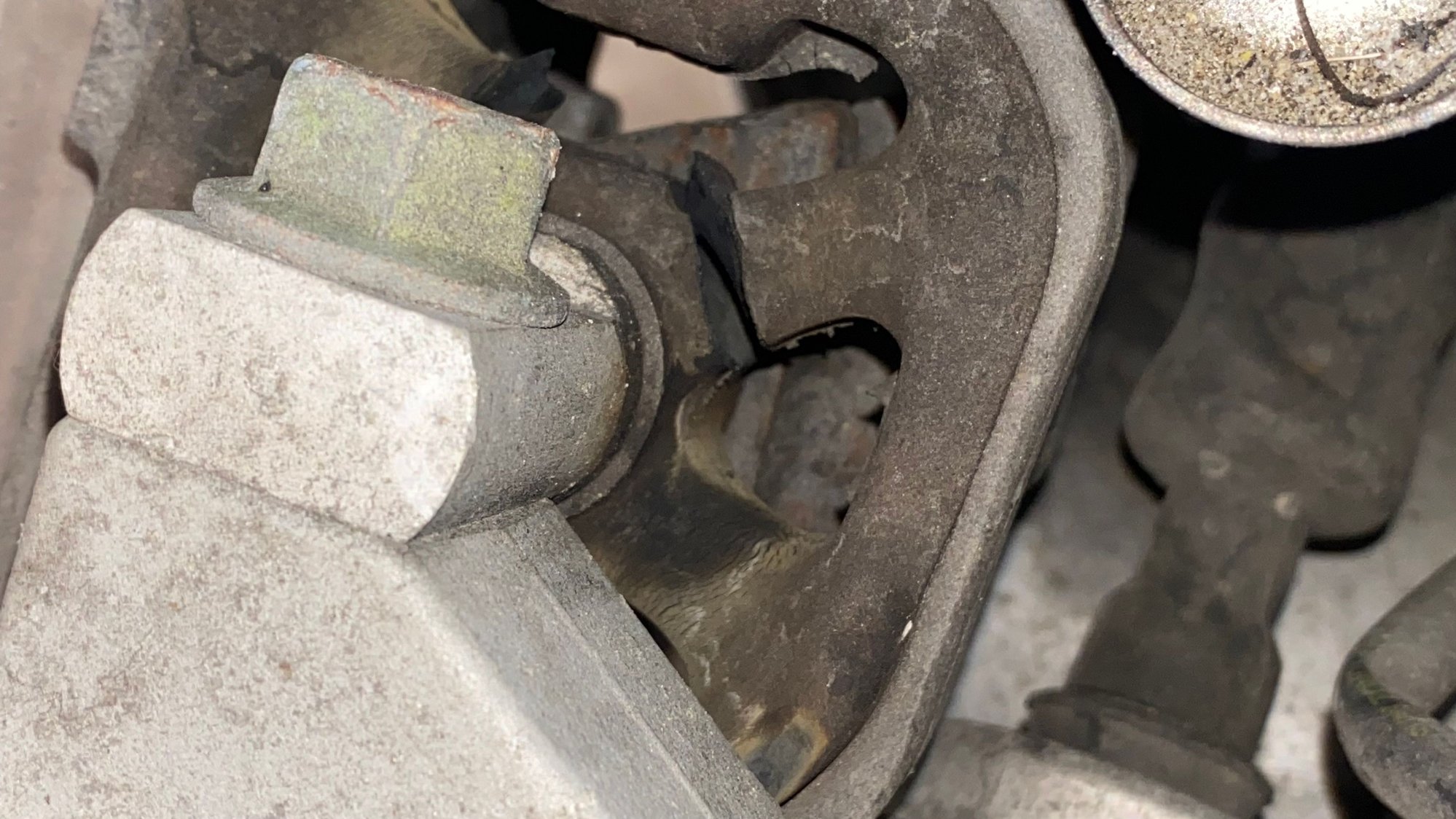

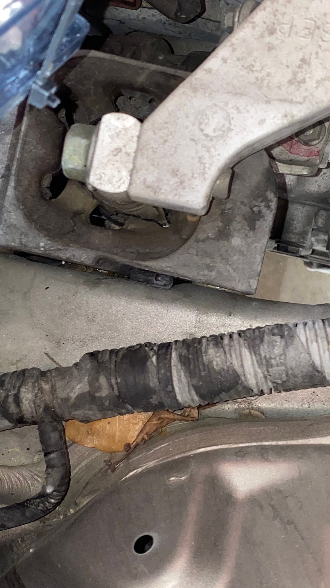

So I looked around google Honda and Acura sites…not 💯 sure about the cross referencing. I know my upper trans mount is cracked. . I seen similar tranny ones on Honda sites way cheaper but say for the 3.0 v6. So basically has anyone used 1. Aftermarket ones from auto parts I get awesome discounts at my friends store…I get really good discounts 2. Know how to check if it is the same part kinda do want to stay OE..and 3. Would there be a big difference if I would get the aftermarket part obviously the premium/best one and the OEM one?

Easiest way to cross reference between Acura & Honda:
Find the Acura OEM part #'s for the mounts you want to replace.
Go to a Honda online vendor and enter the Acura OEM part #'s into that site.
If there is a Honda part# that matches the Acura one, you've found your cheaper alternative.
In addition, you can also use those Acura OEM part #'s on rockauto to help find compatible aftermarket mounts.
The choice is yours on how much you want to spend.

Well I had tried that with the tranny mount and nothing came out but when I put Honda upper trans mount on google or the site the diagram pic looked the same but you know the sites well the ones I seen it’s kinda more an outline lol. I will try that again though thank u 🙏. As for $$$ I mean if mad like to stay oem of course. Not always an option but also don’t want to let something slide cause $$$ is an issue the have more things happen you get me?

How they work out for u? You like the feel? How long ago did u do them? My other mounts look fine the car still very smooth at idle and driving but I had notice shifting reverse to drive sometimes it felt a little I guess rougher and when I did the the intake saw the mount in the pics I posted

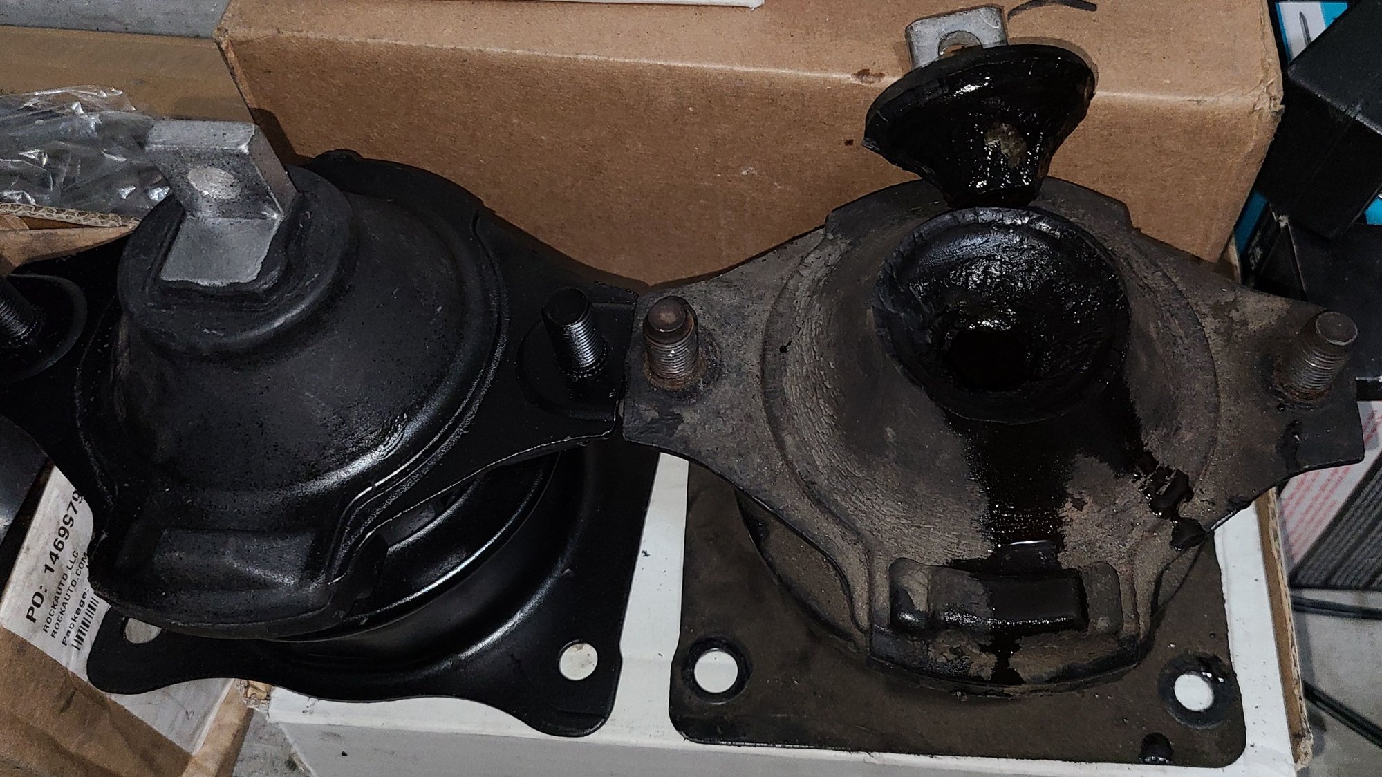

Honestly, I didn't notice a difference in any feel.
The fit was direct drop in.
Pic of front :
Beck Arnley - Left OEM 160K - Right
Didn't take a pic of the trans mount. But, it looked pretty similar in design and weight .So don't know if new oem would be worth the extra cost.
missed one response, this was a couple months ago. I've put just over 500 miles on them.

Pic of front :

Oh I also wanted to add putting Honda and Acura part numbers online didn’t work…the 07 accord has the same part even when looking online seeing which vehicles the mounts fit I looked em up cause they didn’t pop up on either site the numbers do change. So I forgot who commented above bout this but didn’t work out lol the middle numbers changed but ima double check at Honda just to makes there the same part before getting the oem or non oem part.
