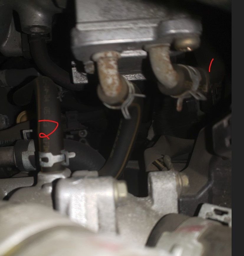

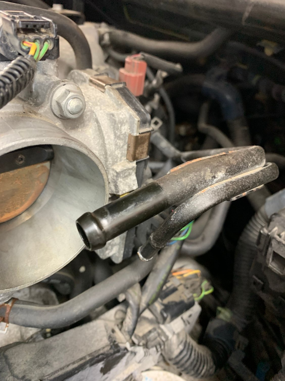

While doing some maintenance on my sons 2006 TL with auto trans, I noticed a hose missing from both ends of the smaller metal tube shown in the picture. The larger tube connects to the intake tube, but could not find anything missing a hose. I spent quite a while searching the internet for vacuum diagrams that would show it, but have yet to find one so posting here as I’m sure this will be a lay-up for many on this forum. Thanks in advance.

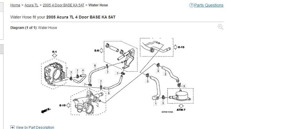

Your missing hose seems to connect the coolant passage to the throttle body. I don't know why they would need connecting.

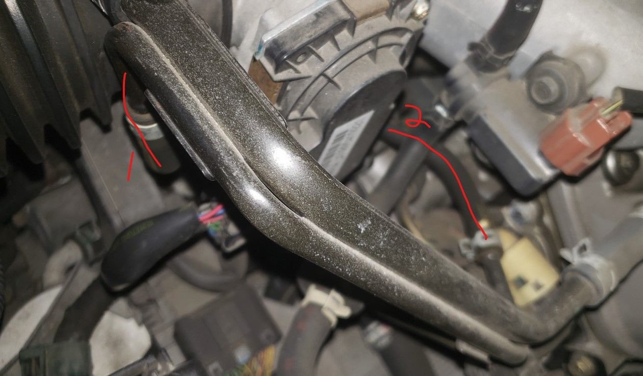

I found better diagram. It seems you are missing hoses 5 and 6.

Thanks for the response and pictures, this is helpful. Not sure why this would have been disconnected, but will look into it and add the hoses.

Someone did a coolant bypass for the throttle body.

I've heard it's there to prevent the throttle body valve from sticking in really cold climates.
