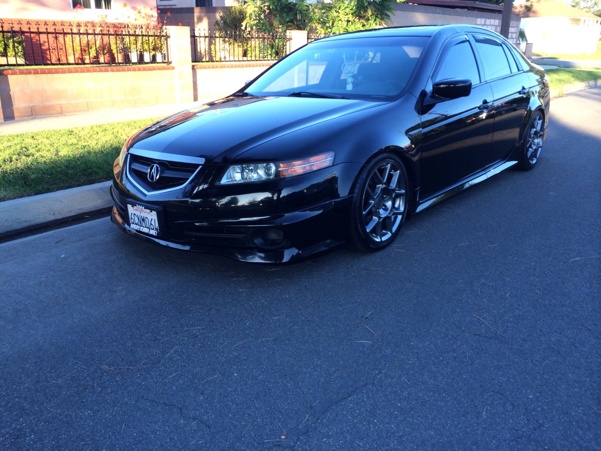

Heres my 06 base model TL with an 07/08 a-spec lip.. Theres placement for my foglights on my lipkit, however it doesn't correspond to my bumper / fit correctly. I'm just trying to install my oem TL foglights but my bumper doesn't allow it.. How would i make this work?

FYI there is no difference in the fog lights of the 07-08 base and type-s.
OP as you stated, it doesn't correspond to your base bumper; so your options are to either modify it i.e. cut an opening so the fogs will fit or buy a 07-08 bumper.

Installed Type S a spec bumper, you'll need Type S fog lights
I already have the 07-08 fogs but it won't fit because of my bumper
