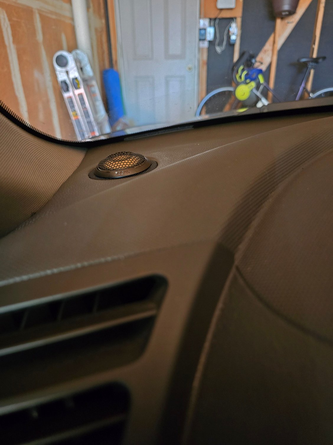

Figured I'd update this. I took the car in this week to get upgraded Focal speakers and a new amp. The installer knew some extra tricks. He installed a 60 Hz (maybe 68) resistor in line between the original nav screen and the Kenwood Nav/AndroidAuto unit, et. voila, Original nav screen and clock control are back. L Now I have everything. Pretty excellent

pictures of install?
