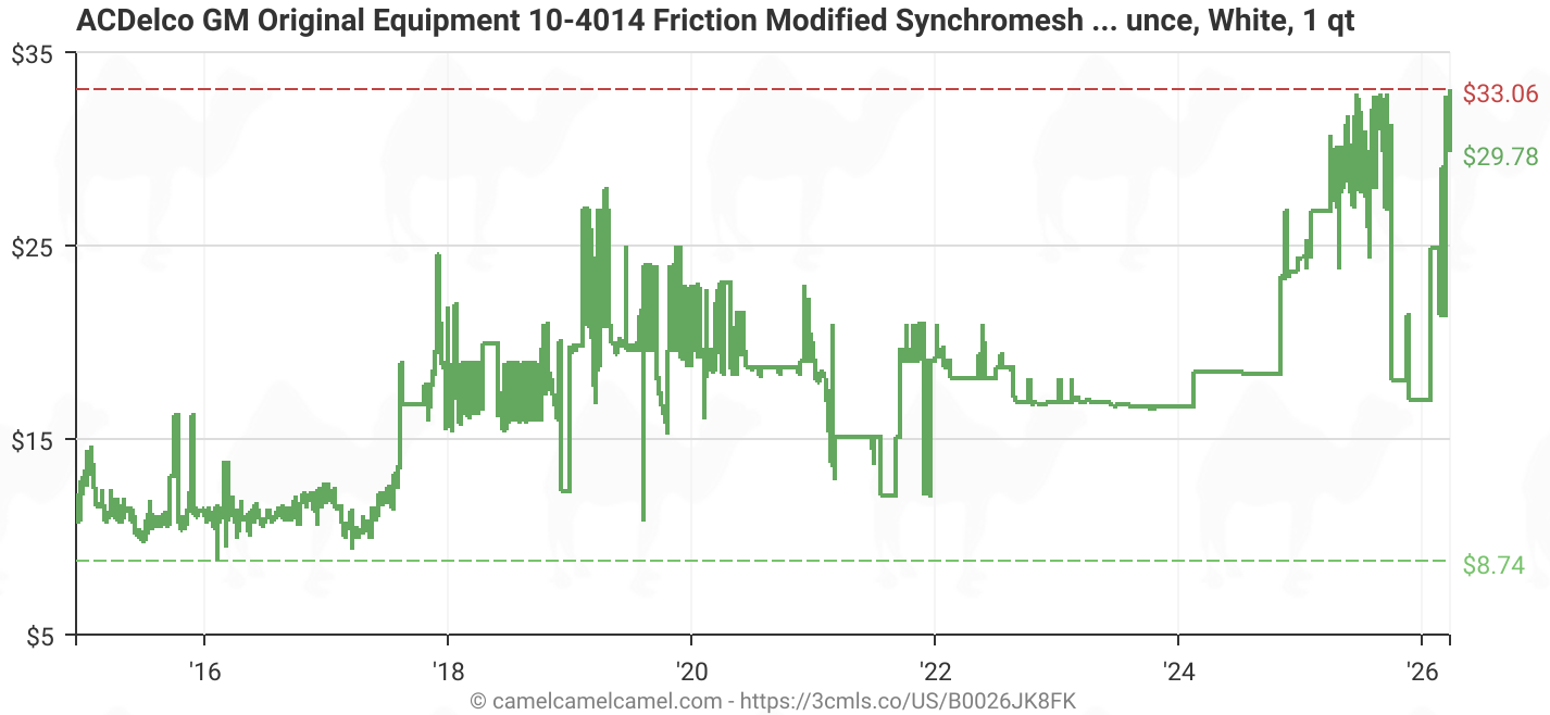

Since I'm not sure exactly which product you mean when you say, "75-80 synchromesh from ac Delco", the de facto standard manual transmission fluid for the 3rd generation TL is - according to the Amazon name for the AC Delco-branded product - "ACDelco GM Original Equipment 10-4014 Friction Modified Synchromesh Transmission Fluid" (ASIN B0026JK8FK).

The RockAuto price, even with $8.99 USPS shipping is cheaper than Amazon with "free" shipping, but the price has gone way up recently.
