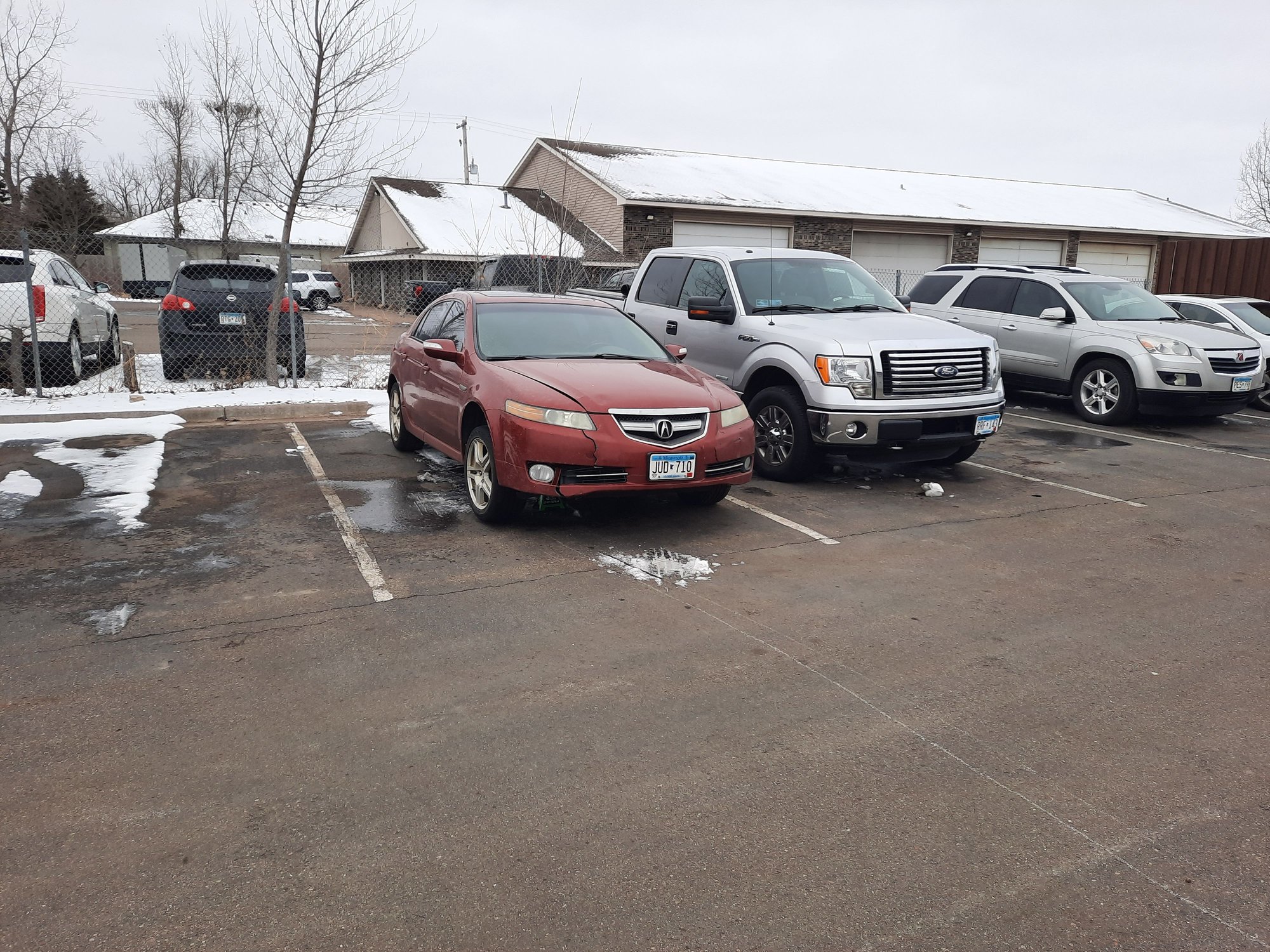

This is where my car was parked. Above one give me 2 warm days to fix thing. There was mud Sunday and Monday but not water. Big pool of water is there again today after snow past night. If would not fix at Monday would not fix for weeks. Of course I had to fix passenger side lbj and cv axle.
From some reason no knock from left wheel today so far. Maybe because of colder weather moving in.
