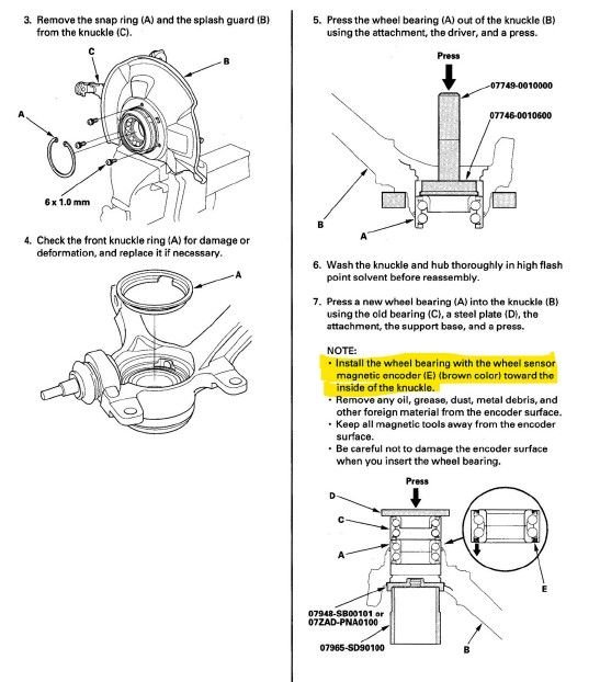

Im pretty sure it migh be the wheel bearing? as thats whats used to measure speed?
Old Feb 12, 2024 | 05:30 PM
Posts: 6,898
Likes: 2,208
Right you are:
Magnetic encoder is at issue?
Old Feb 12, 2024 | 05:33 PM
MRTL06's Avatar
Vtec Powaa
Joined: Jan 2024
Posts: 28
From: Ancaster, Ontario
Originally Posted by zeta
Right you are:
Thank you very much for this diagram. Do you think it would be okay to replace the bearing with this one here:

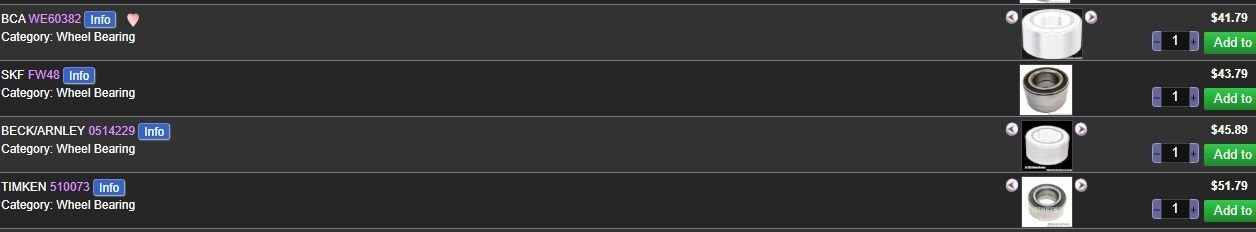

Old Feb 12, 2024 | 06:37 PM
Posts: 6,898
Likes: 2,208
Thank you very much for this diagram. Do you think it would be okay to replace the bearing with this one here: https://www.amazon.ca/gp/product/B08...?ie=UTF8&psc=1
Best choice: Full price NSK OEM $105.49.
Same best NSK bearing price cut in half from ebay.
My choice.
However, if I had to pick between your lower cost amazon bearing and the 'middle of the road' ones below from rockauto, I'd probably go with the SKF or Beck/Arnley.
Good Luck

Old Feb 14, 2024 | 06:02 PM
sweeT n Lo's Avatar
Joined: Dec 2016
Posts: 133
Likes: 20
What do you think about ACDELCO?
Unless I'm looking at it incorrectly, the NSK wheel bearing is listed on Rockauto for $30.79 right above the other ones mentioned in the other screenshot.
Old Feb 14, 2024 | 06:35 PM
Posts: 6,898
Likes: 2,208
You are correct!
I overlooked it in may haste.
