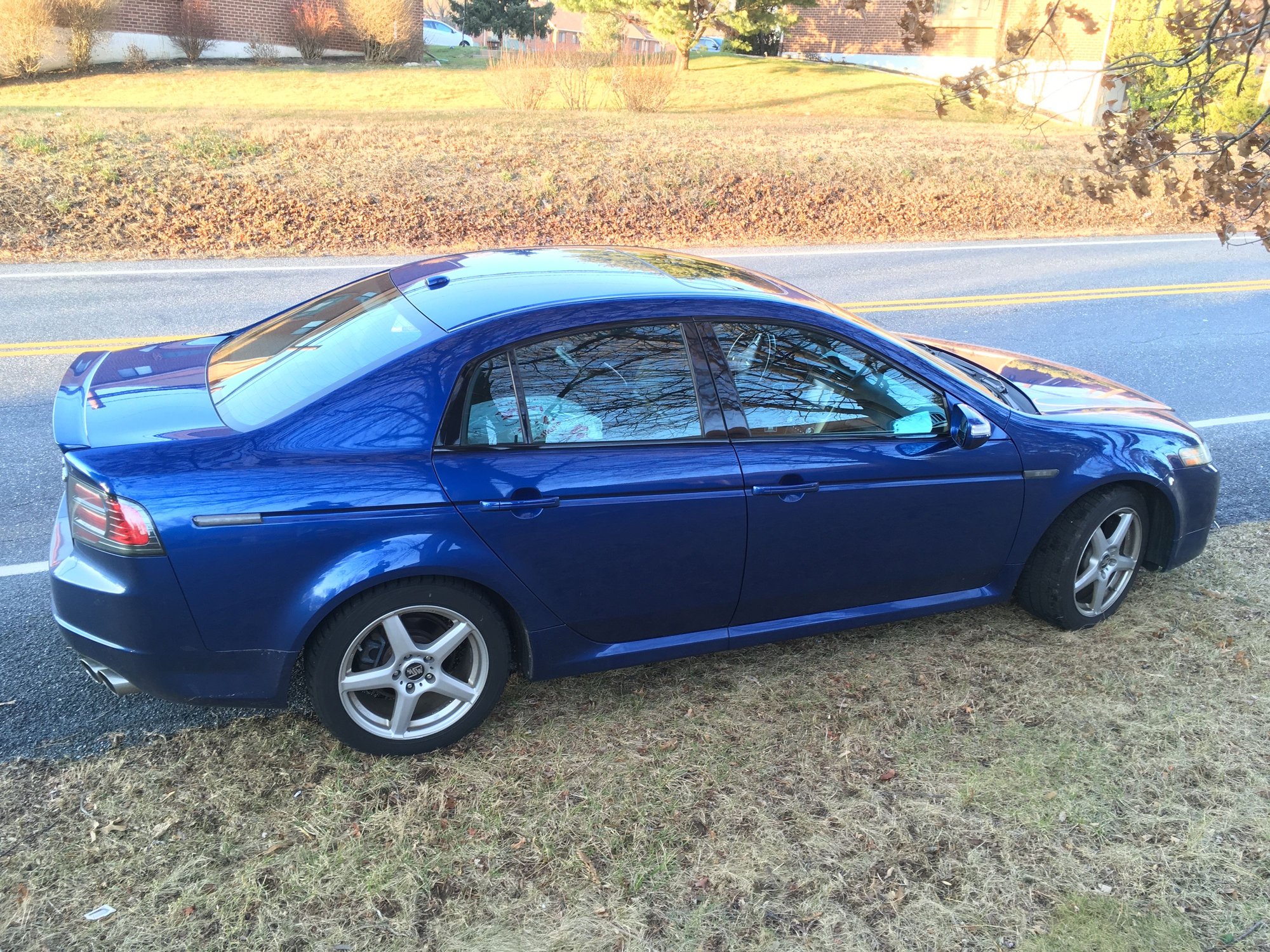

So we aren't talking just in abstract terms, here is a photo of my TL from late last week. The snow tires / rims are on in this picture, but I switched back to the stick rims to have he car appraised.

Brad...are those "winter wheels"?

They are. The stock rims have high performance all-seasons and the 5-spoke rims in this photo have Blizzaks on them.
