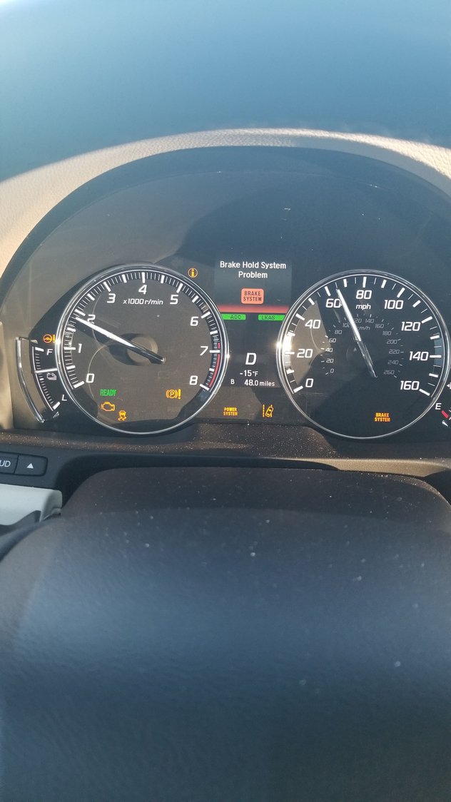

Any updates to this? I had the same problem. All warning lights on the dash were on for a few days and the car has been feeling underpowered and not as smooth. Idle is rough too. All warnings spontaneously resolved.

rick_sambora - the dash lights look quite similar to what I experienced. But -15 degrees! That's cold. Just take it to the dealer and have them check the code. The Acura dealership cleared the code, test drove, everything came back fine. I took the car home and that same night the lights came back on. Went back to dealer and dropped it off. Found a bad wheel sensor. Replaced part. No issues since!
Was your car in limp mode while the lights on dash were on? Max speed should be governed at 75mph (in limp mode).

Yes, it went into limp mode for the time that the lights were on. Thanks for this info. I am dropping it off on Monday. I understand that our cars have a very complicated drivetrain but I would assume Acura did cold weather testing before releasing this technology to the market. I will report back when I get more info from the dealership after the diagnostics.
