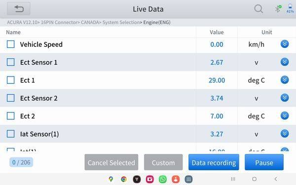

I had a look at the Live Data that was available on the RDX using my Anyscan A30M tool. LINK.
It looks like there are 2 Engine Coolant Temperature (ECT) sensors. I can't be certain, but I think one might be used by the gauge and the other is used for engine management. I can't explain why one of them reads much higher than the other . This screenshot was taken only a minute after starting the engine with an ambient temperature of about 2'C (Canadian). If this is the case, then monitoring this data to see if it also fluctuates may help in your diagnosis.

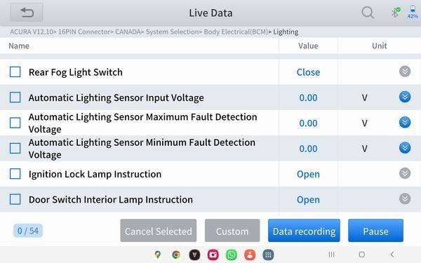

There is Live Data also available from the Body Control Module (BCM), Lighting section, which shows the signal from the Automatic Lighting Sensor. Monitoring this would also help in your diagnosis.

Those are probably the 2 ECT sensors my code reader displayed in my earlier image.
The RDX had been sitting in the garage for at least 8 hours, in an ambient temperature of about 2'C, and one sensor read 7'C after the engine had been running for a couple of minutes (a reasonable value) while the 2nd sensor read 29'C (a warm summer day). I will monitor these sensors while driving to make sure they are both reporting updated values, and not just stuck at a fixed value.
I would think that the radiator temperature sensor would just be used to turn on the radiator fans, while the second sensor would be used for engine management, and likely the dashboard gauge. I'm not sure how either one could affect the actual heating rate of the engine, since the thermostat seems to be strictly old-school mechanical and not computer controlled.
