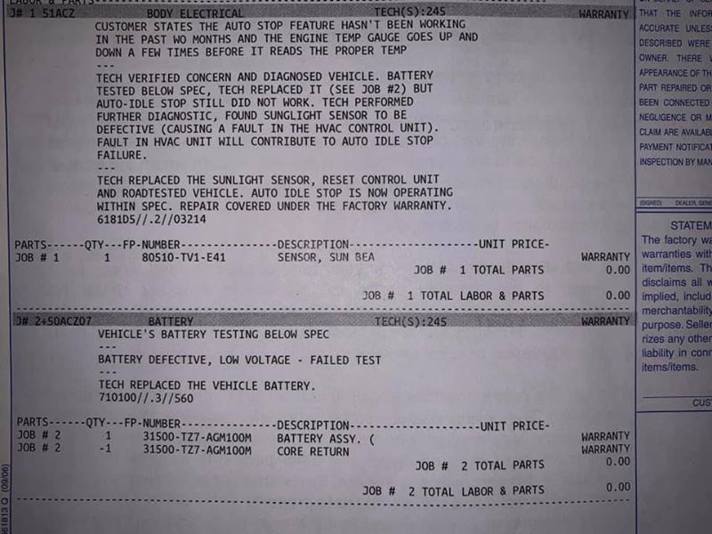

My engine temp gauge usually sits at the 1/3 when warmed up. The problem is that my engine gauge has been fluctuating up and down while warming up. Sometimes it will show 1/10, then go back down to 0, then come back up, etc. It also.takes abnormally very long time to warm up. I've had it sit running in my garage for 15 min and the engine temp gauge still says 0.
Anyone else have this problem?

Well I brought my car into the dealership because the AIS also stopped working around the same time, and they diagnosed the problem as a sunlight sensor issue. The technician found a problem with the battery that produced low voltage and replaced it but the issue did not go away. They then localized the issue to the sunlight sensor which wreaked havoc on the HVAC system which then disabled the AIS. Interestingly enough, this also did fix my engine temp gauge and now it warms up within 5 minutes of driving. I've never felt that there was a problem with the HVAC system to begin with and temps were fine in the vehicle.
Before, I would be idling and/or driving for more than 15 minutes and the engine gauge still stayed at 0 and the gauge would fluctuate up and down until it reached operating temperature. I've tried different ways of getting the car to warm up including the suggestions listed above.
