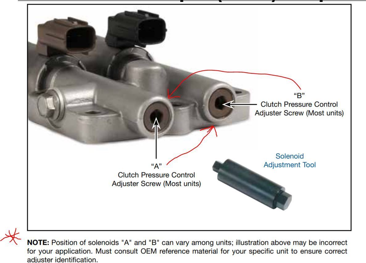

That switch is on the side of the transmission . You can see it behind the drivers side wheel. I replaced those about at 65k-70k miles and I did not see any difference. I now have 99.5k miles.
last month I replaced all 4 "Shift solenoid valve A, B, C, and torque converter". And I put in 1 can of Seafoam Transmission flush to supposedly "remove varnishes".. The seafoam says to leave it in at least 50 miles. I left it in for 150miles than did a 3x3 fluid swap.. And there may be some progress but its still not 100% fixed. (note the seafoam says you can leave some in as a conditioner, and you pretty much have no choice because the whole process of a 3x3 drain and fill, does not flush the entire transmission, so some remains.). So, it has been about 500 miles now.. And some of the seafoam is still in there. It might be not as hard a shift or as often, but it is still there if I left off the gas at the right time, just as it shifts from 2nd to 3rd.
My effort will be to remove the dual linear solenoid panel on top of the transmission and make sure it is clean enough to slide those pins.
I have a HDS on my laptop. And I did a check on the dual linear solenoid plate , which is A and B, and it said it tested out "Ok" and there were no codes.
Then I did a test on all 4 of the "Shift solenoid valve A, B, C, and torque converter", and when those tested, I heard Clicking. But I did not hear any clicking on the dual linear solenoid plate. So is that bad?
I would just replace the dual linear plate, but I think they have an adjustment screw on each solenoid, but I do not have a pressure gauge. Plus an OEM one is over $300. So I just thought about cleaning it first and running through a different kind of test that Checks the OHM reading on each solenoid, AND you also test it by connecting 12v to it. You should hear it click. All these videos are on youtube.
I have a fluid filter I may swap out too, if it get back in there again and fiddle with that dual linear solenoid panel.
I also have enough fluid for 1 more 3x3 drain and fill. So I was contemplating adding more of of that seafoam.. But I dont want to get too much in there.
One thing I notice is that based on SOTP, I have an increase of horse power and it shifts faster. And downshifts faster. So, I like it.. But i need to keep doing whatever it is that I am doing. haha Throwing the towel at it. Trying anything that can be related to the 3rd gear. But I also have a hard reverse.
Interesting, the Helm book says if you have excessive shock on ALL gears, then start with the Dual linear solenoid , then replace the Speed Sensor.. which is pretty cheap on ebay. And It mounts near the dual linear.. And it also calls for the ATF temperature sensor replacement. but still, I have no codes for any of that. So I have not done it.. I dont mind throwing money at it, if it is not too expensive, but I dont want to do the work for nothing either. haha
