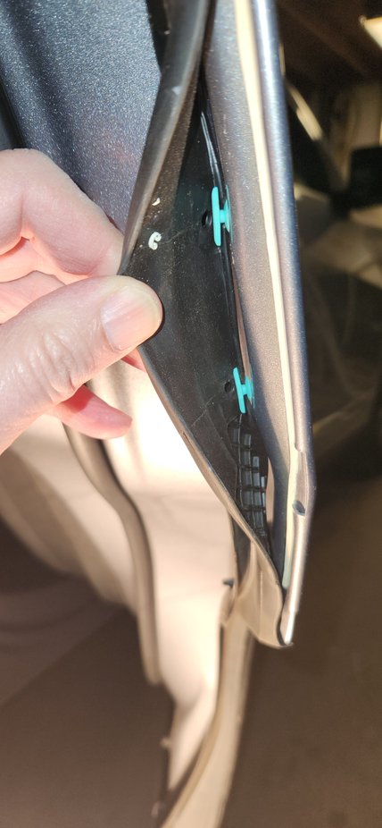

I finished installing the guards and here is what I learned.
First, you push the tool down for the left side doors and pull it up for the right doors. It took a brief "duh" moment to realize this.
For the 2022 RDX model, I didn't use any of the clips provided for the rear door gaskets. I was careful not to pull out the clips from the door, rather I unhooked
the gasket from the clip. It was easier to then stretch the gasket back onto the hooks. They blueish hooks insert into the holes in the gasket.
The trim tool provided in the kit is not so precise. It cuts deeper than needed, so you end up with some of the caulking exposed.
Perhaps this is why the instructions recommend touch up paint.
As others have pointed out, take your time and, in my case, don't cut too deep into the caulking.
The rear doors take more time and patience.

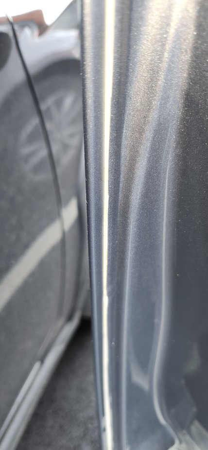

Are the OEM metal door edge guards useful or effective in preventing dings and paint transfer to the car next to you?
I just received mine, and was surprised that they were metal and not plastic. It seems that the painted metal of the door edge guard is no different than the painted metal of the edge of the door itself. Maybe the the more rounded shape of the edge guard helps a little?
I got them so when my kids inevitably bump the door into our other car in the garage, that the edge guards would hopefully protect the other car.
I'm debating trying to return the OEM edge guards and just using the clear 3M protection film instead.

I had the same thought when I got them.
Haven't hit anything yet but time will tell.
The stickers feel like they will peel off eventually, or get scratched. At least I can touch up the metal ones.
