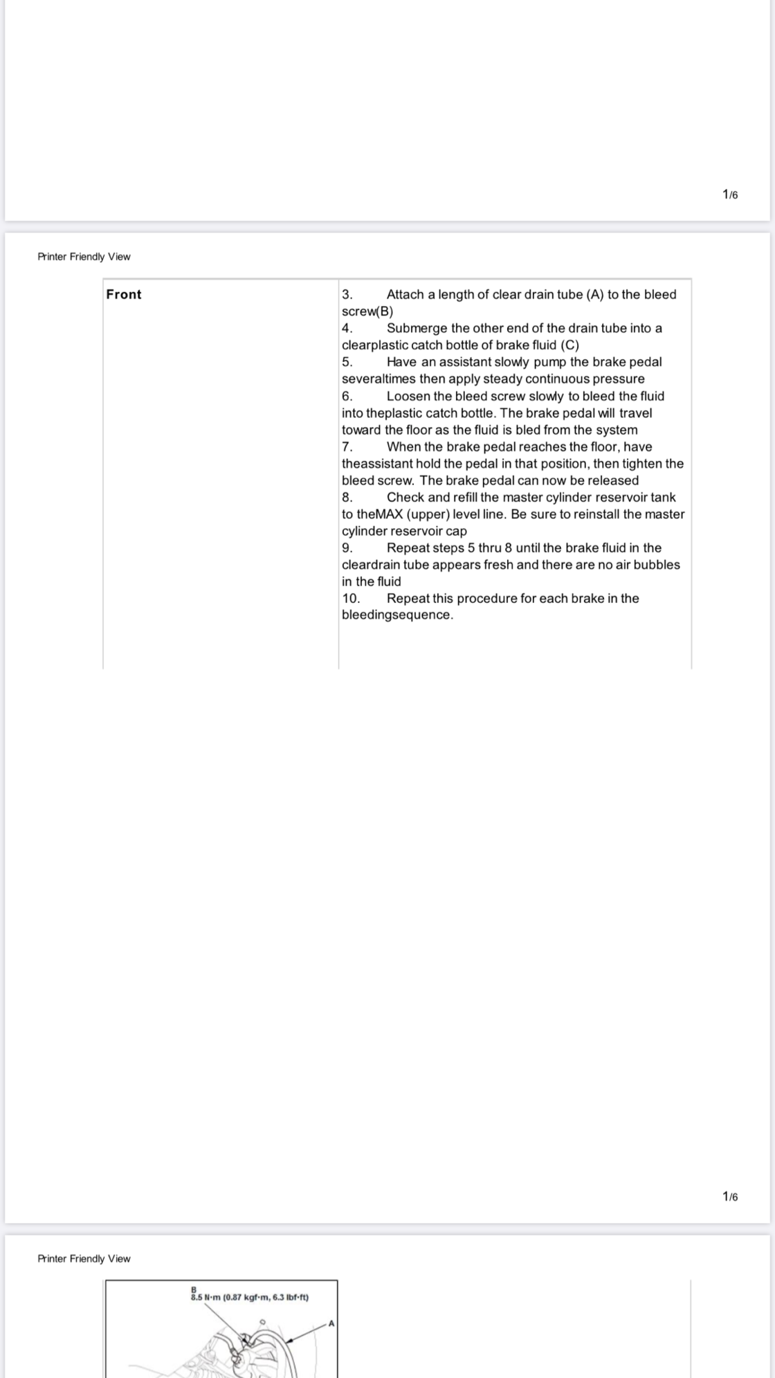

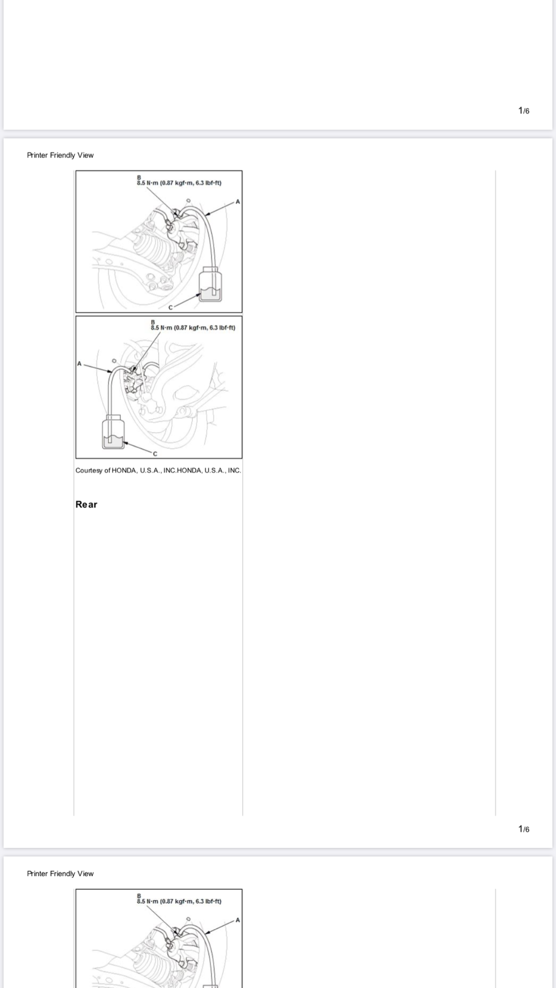

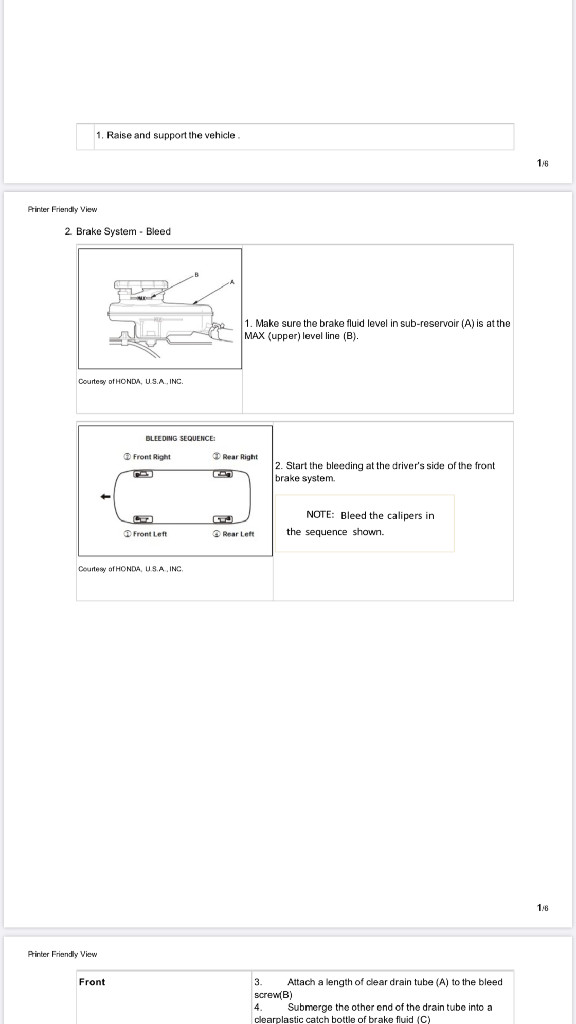

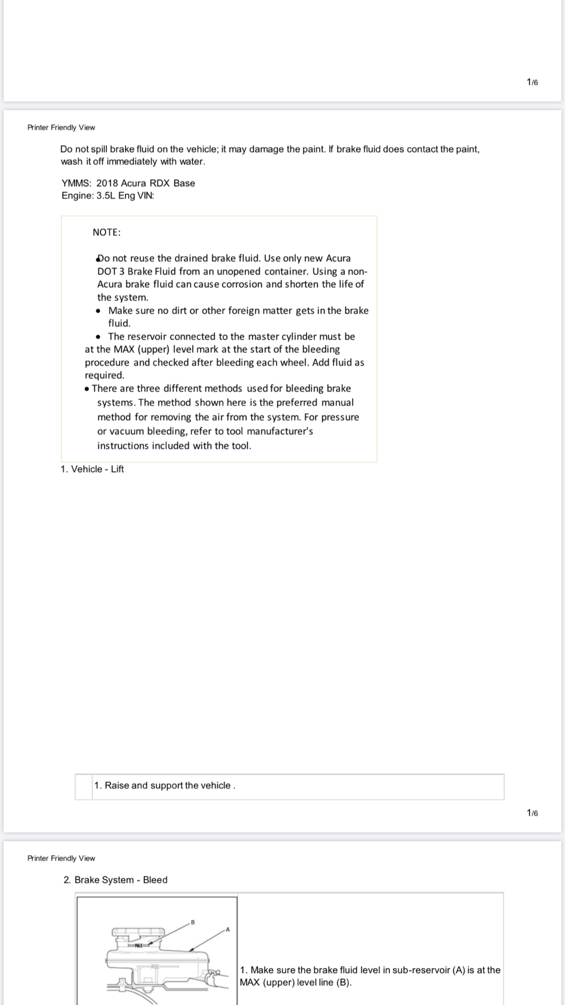

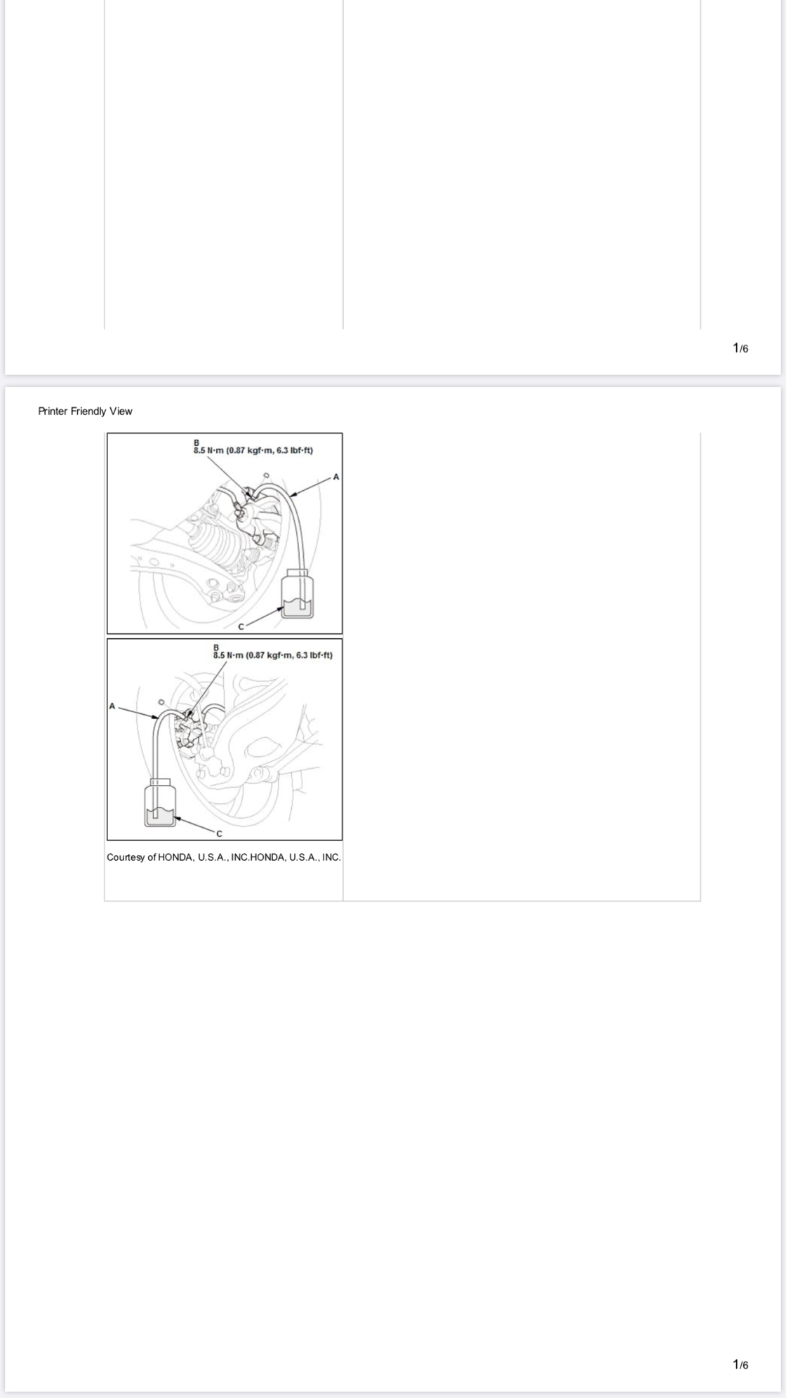

anyone can post the service manual instructions for the brake fluid bleed/refill? much appreciated. B7 on mine... only 8K at 25 months... will attempt myself
This is the bleeding procedure for the13-18 RDX, should be similar (I believe) for the 2019+
