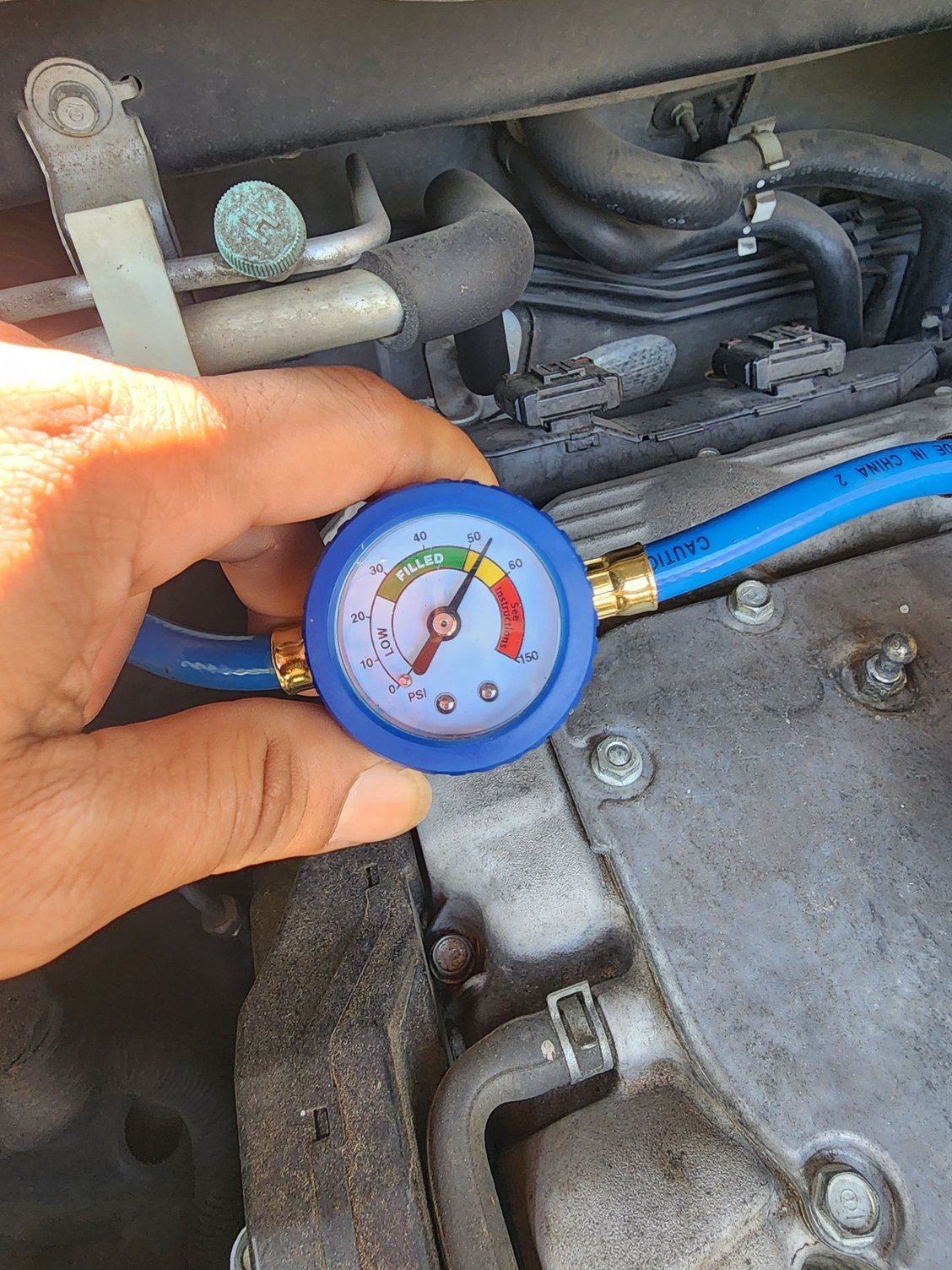

Well I checked the freon and is good almost passing the full line.

Originally Posted by deltaflow13
Thank you for the info.
if the ac has a "sight glass" (something that was common in the 70's, though they had quite using them) you should see NO bubble in the glass when the AC is running, Bubbles=low freon. If it doesn't have a sight glass, where are you checking the freon level?
And when the compressor goes out the gauge goes up
Which fan is the one for cool the condenser? Cuz I only seen the driver side fan working.

have you had the AC recharged lately? with that pressure I wouldn't expect the AC to cycle when idling if everything is functional. Now some AC units will shut off if the pressure gets to high. the low side presure you are seeing is in the ballpark for ambient in the 85F + range. If operating correctly, the pressure will drop with lower ambient temps.
However to fully see if the system pressures are as expected you also need to check the high side pressure, but that's not a task for someone without proper tools and understanding, since the high side pressures should be in the range of 150-350psi, highly dependent on temperature. something best left to a shop to analyze.
I got the tools to do it I'll try tomorrow
Ill.trh to keep updated
But im sure that my fan condenser its out...
