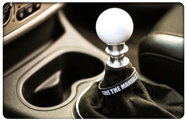

Old May 2, 2015 | 10:50 AM
  #792
Username 0's Avatar
I like cars.
Joined: Jul 2006
Posts: 866
Likes: 163
Would anyone be interested in buying one of these wrist bands if I get a bunch of them?
Old May 2, 2015 | 12:27 PM
  #793
iCrap's Avatar
TSX AMG Type //M i-VVT
Joined: Jun 2013
Posts: 4,578
Likes: 858
I would if i had a manual.
