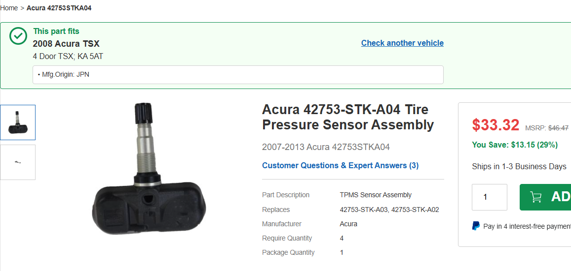

man, typically i try to confirm fitment before buying parts..
https://www.oemacuraparts.com/oem-pa...or-42753stka04
is your car listed under "Vehicle fitment" on the above?

42753-STK-A04 is only compatible with the 07-08 4 cylinder TSX as shown below and on the vendor link thoiboi provided above.
42753-TL2-A52 only appears compatible with the TSX models shown below.
The ebay vendor's 'compatibility' table appears to be in error based on the OEM data above?
