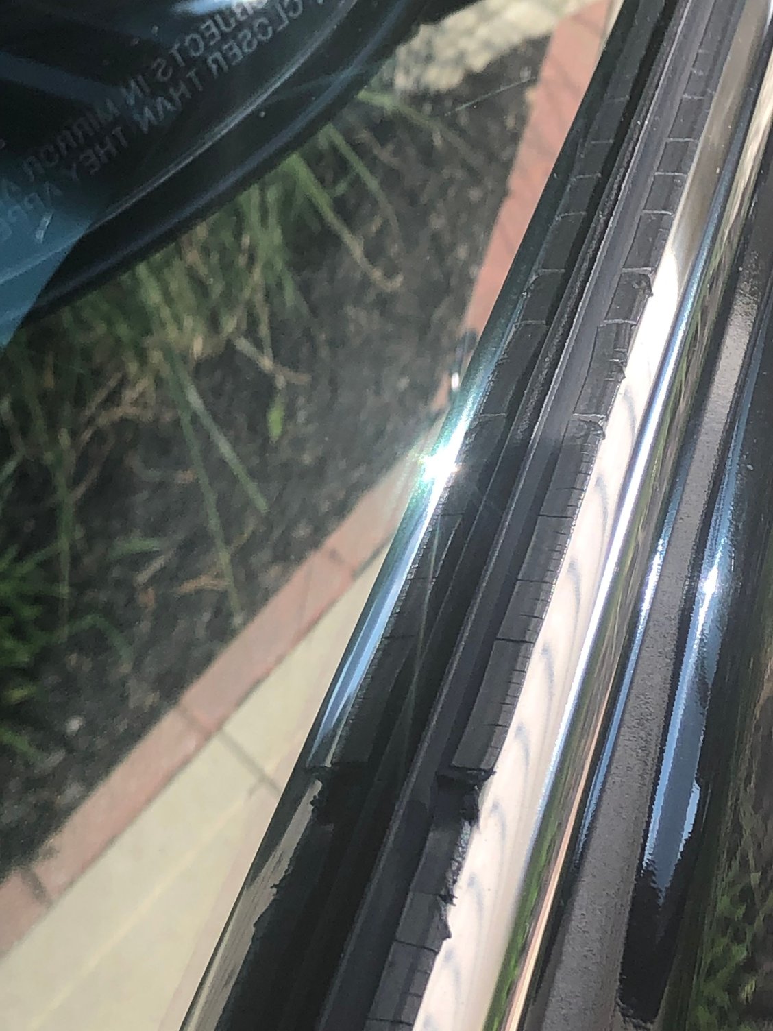

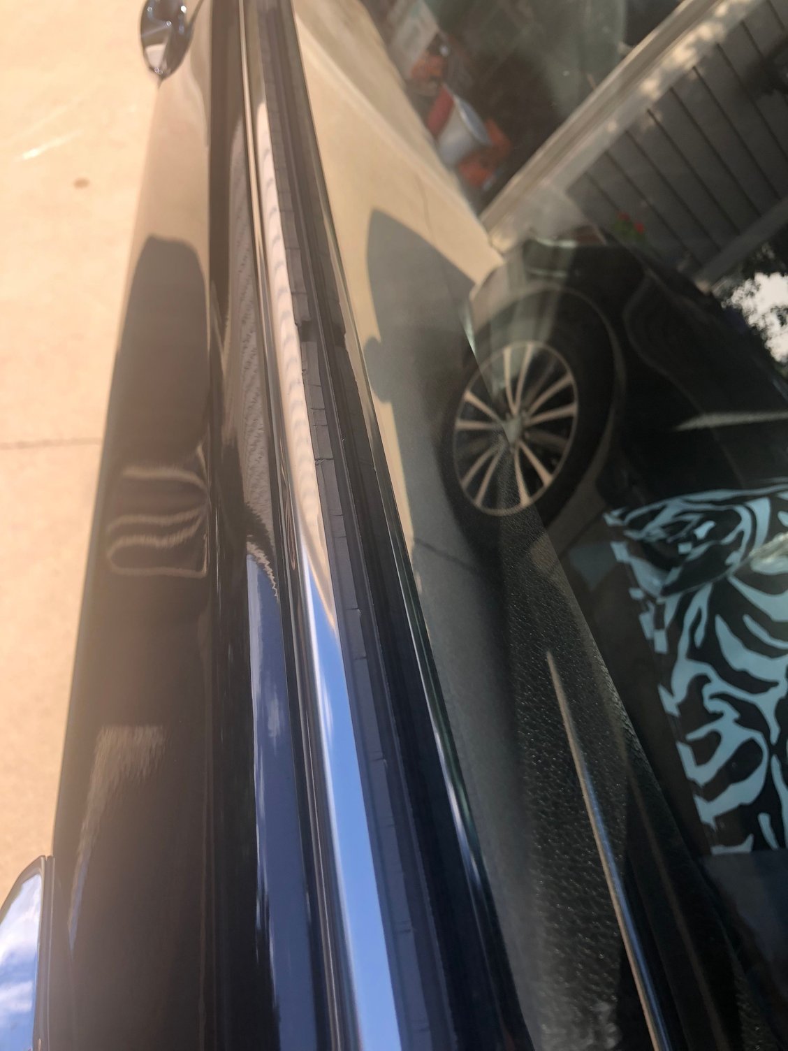

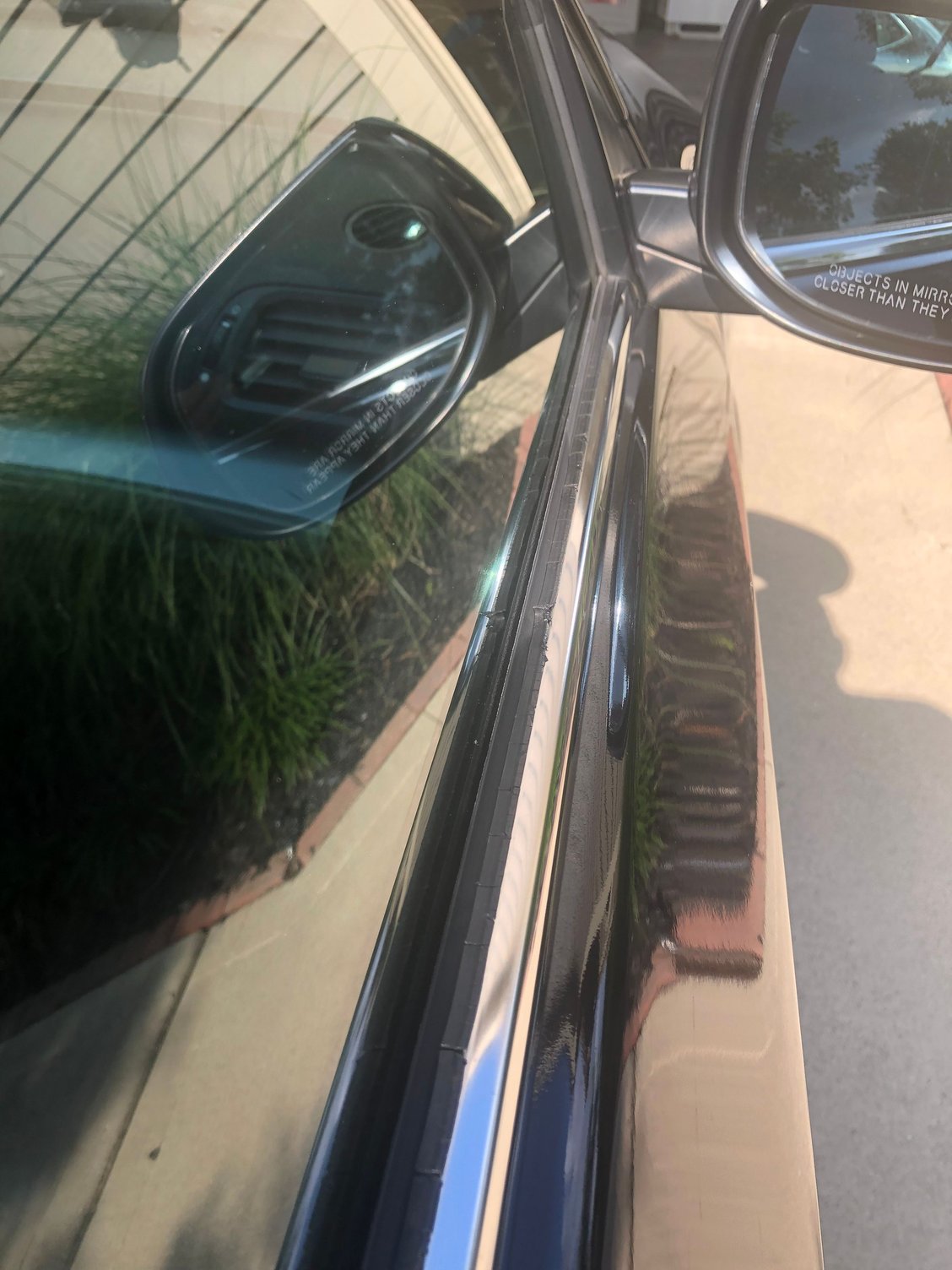

2010 tsx window weather stripping
What specifically do I need to replace these in all of my windows. The original weather stripping is cracking and is all sticky. Is it hard to do?
Old Jul 25, 2019 | 10:54 AM
TexasHonda's Avatar
Posts: 2,877
Likes: 128
see link. for search "auto window weatherstrip"
good luck
Old Jul 25, 2019 | 11:00 AM
cu2wagon's Avatar
Joined: Aug 2014
Posts: 28,432
Likes: 7,772
From: Dirty H-Town, Amerikkka
Every vehicle I've owned has been basically the same. Roll the window down, grab the trim, and pull up. There are a few clips that hold it in place.
Look at the new part you're replacing the old one with to see where the clip points are since that's where the resistance will be, and then yank there.
Pop the new one in and yerdun.
If you put a warm beer in the freezer before you walk out to do it, it'll still be warm when you go back after wrapping up.
It almost takes longer to roll the windows down as it does to replace the trim.
