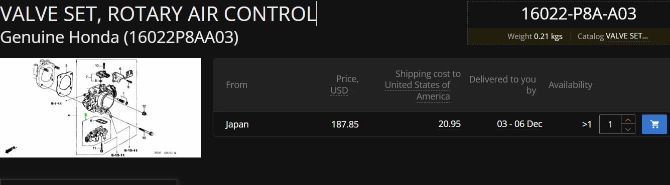

I called my local Honda dealer for the part# you mentioned (16022-P8A-A03). Guess what? The good news is that they have it in stock, but the bad news is that they want $403.89 plus tax.

Originally Posted by DBL
But sometimes you just have to bite the bullet.

Originally Posted by zeta
They called me back and mentioned they can match price as long as I can bring a print out from a Honda parts dealer's site.
The cheapest retail, and still over-priced, OEM 16022-P8A-A03 I could find was $208.80 shipped from Japan arriving between 03-06 Dec if ordered today.
Good luck finding new OEM in the U.S. lower than that, unless you have the 'hook-up'.
