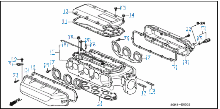

Also, if I want to go through with the valve cover gasket replacement job, I have a few questions"
1. Would I also change the coils?
The current coils are aftermarket but I guess they are fine - I never get engine light/codes. I just always assumed that Denso or NGK coils would be better?
2. Would I also change the intake manifold gasket?
Is it recommended to replace the intake manifold gasket during valve cover gasket job? The intake is pretty much exposed/up or am I incorrect?
3. In the image I am attaching, are these the full set of upper plenum gaskets? Also in the photo, is this set including valve cover gaskets? I was going to purchase the Felpro valve cover gasket set, which includes grommets and tube seals.

1. I wouldn't change coils unless I suspected a problem with the coil.
2. I would change all the gaskets.(use the one throttle body gasket that fits, there are 2 use the correct one that matches. They include 2 since there are 2 configurations).
3. This set does NOT include valve cover gaskets. You will need to buy those separately. As mentioned before you will need to remove the whole upper intake assembly to get to a couple of the valve cover bolts, The air chambers cover them on both the front and the back. Replace the gaskets at the same time.

Jon - on the diagram you posted, where are the F&R Intake Chamber Gaskets? In the diagram, I see valve covers, valve cover gaskets, upper intake plenum gasket, and intake manifold gasket. I am thinking the "mechanic" may have pinched the intake chamber gaskets...

The front and rear intake chambers are part #'s 3 & 4, the gaskets are #'s 5 & 6. Unless you are loosen the bolts on these you probably don't need to replace them unless you see damage, or hear air leaking, or want to take them apart to clean them. You do need to take the entire upper intake manifold off to get to the top bolts for the valve cover. Fel-Pro is a a quality gasket. The OEM's I think are better, at least for me they lasted longer than others. Just don't get a no name from Amazon or eBay.
If you replace the intake gaskets you can see if any are damaged but at that point you are replacing them so it won't really matter. Just make sure you have a nice clean area for the gaskets.

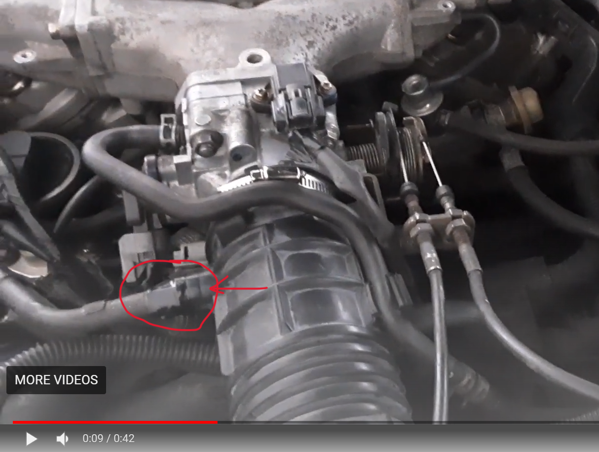

Originally Posted by Domenic Ricci
You're sure the breather cable is securely plugged in?

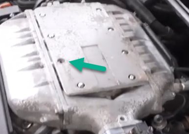

Domenic, The video is what I would expect for a vacuum leak. I did notice what looks like a bolt missing from the top intake cover. It could just be the camera angle though. If a bolt is missing you can have a leak right there.
You can use carb cleaner, water, etc on the outsides. The bottom of the intake manifold is basically unreachable. Replacing the gasket is the easiest way.
The vacuum solenoid I mentioned it the control solenoid for applying the vacuum to the motor mounts. you can follow the vacuum line from the motor mounts and it will connect to the solenoid, Driver's side, near firewall around/under were the sway bar bends.

That plate/gasket will definitely expand/contract at a different rate that the surrounding area and be inconsistent (in terms of sealing) as the engine gets hot. i.e. vacuum leak! Nice eye Jon.

Will check breather cable. I think in the past I thought it was "not in all the way" (in to the tube).

Nice catch! Recently, when I took the plenum plate up to clean the area and EGR port, I tightened that bolt too hard and it snapped. It is snapped off, inside.
Just weird that it was fine for over 2 weeks, and now is pretty much every day.

I have no idea how to get the bolt out.....was going to have the mechanic handle the snapped bolt issue when I had the valve cover gaskets (and ALL upper plenum gaskets) replaced..........

UPDATE: The breather tube was clearly not inserted in its entirety. I just inserted "all the way"........

When the car warms up the metals expand without the gasket being good a gap would occur and then the vacuum leaks. As far as the "new" throttle body, I can guess a few things, the system was ECU was reset when you disconnected the battery, the computer then was able to compensate for the new pieces. After being on for a while the maybe something recently bolted or reconnected (tubing) loosened just enough that the ECU can't compensate. Maybe when removing and replacing the throttle body you jarred something and moved just enough to close the vacuum leak but after running the car for a while the vibration has moved it back. I don't know the condition of your car etc so these are just possible guesses they may not be probable. I would have been replacing all the gaskets and the vacuum tubing to be done with it. Did you do the vacuum test with the throttle body we recommended?
