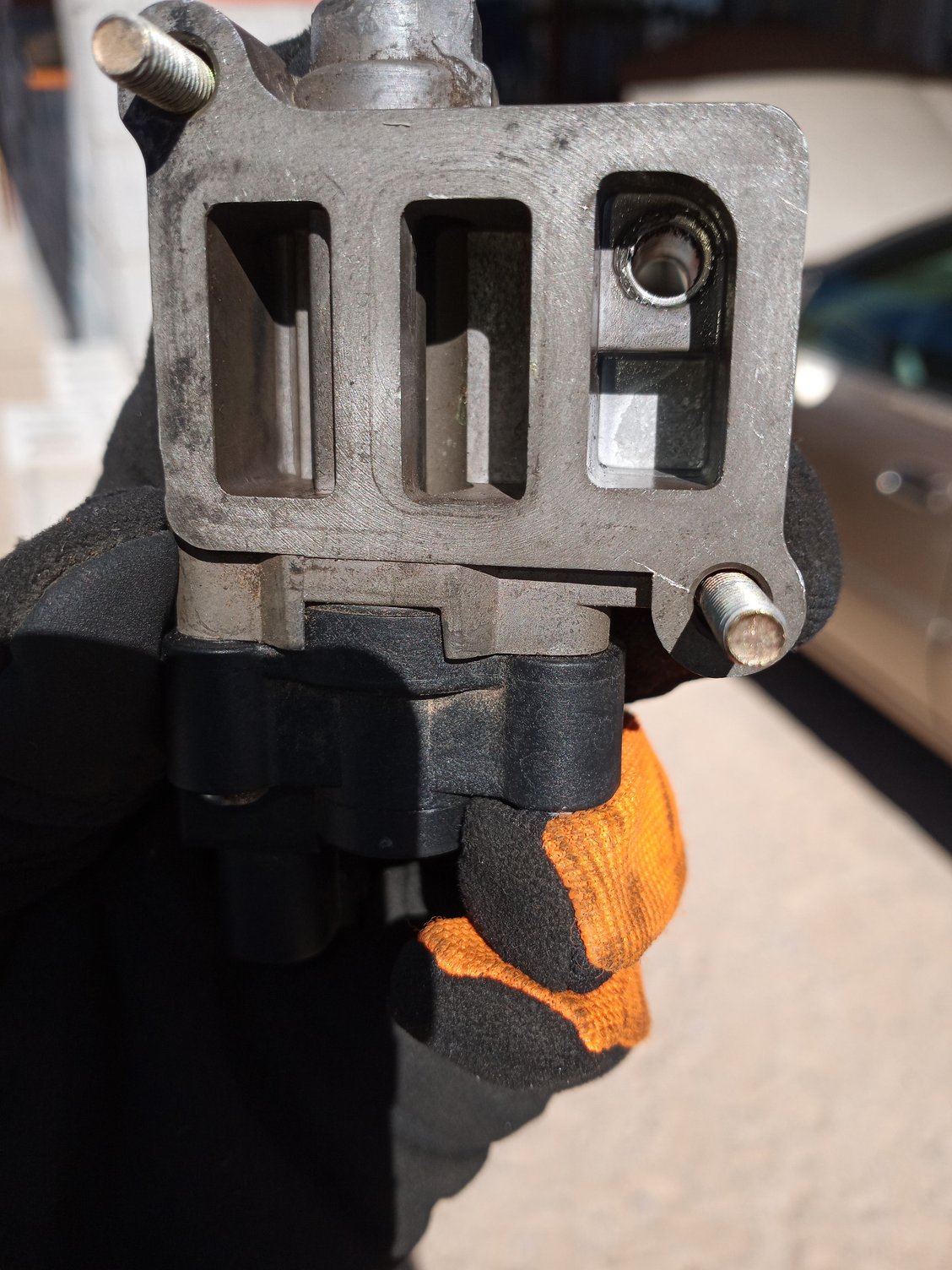

2000 acura tl automatic v6 3.2L
Any update Dominic? I have the same issue on a 2000 acura tl v6 3.2L with the idle surge (revving up and down). The codes that showed up for me were p0135 and p0505 . The auto zone solution i got printed out said to replace oxygen sensor bank 1 sensor 1 *before the catalytic converter, did that and it did not fix the idle surge. I checked the idle air control valve, it look clean but, i guess it needs replacing...i don't know. Does anyone know the solution to this?
The person i bought the car from said it could just need the computer reprogrammed. A non dealership acura and Honda specialist mechanic said you don't do that, it's probably needing coolant or could be a solenoid.
Anyone have any do it yourself solutions before i take it to that acura and Honda mechanic? Thank you.

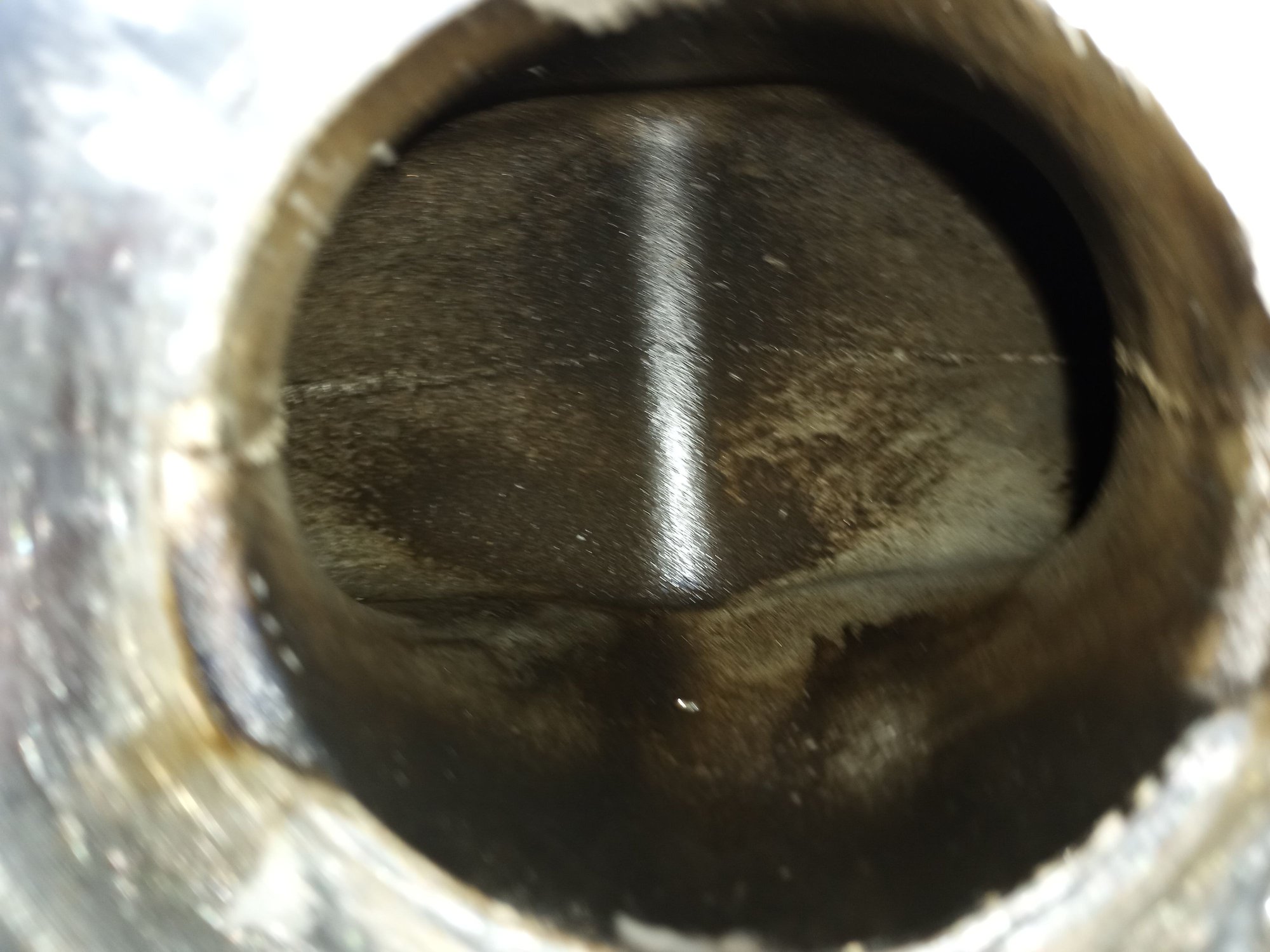

Make sure the vacuum tubes at #11, on the link below, are securely connected. The upper one goes down for the engine mounts as shown on the diagram. The lower one runs to the rear of the intake manifold.
Engine Mount for 2000 Acura TL SEDAN | Acura OEM Parts
Sometimes cleaning the throttle body can help if it is dirty or full of sludge. Or you can either have the mechanic clean the existing IAC valve or replace it.
Make sure to get a quality aftermarket one, like the one below from RockAuto. They are about $66 shipped:
More Information for STANDARD MOTOR PRODUCTS AC229 (rockauto.com)
The OEM ones are about $250 shipped.
Good Luck!

Going off by the picture i couldn't tell which was the part but, i didn't find any disconnected or damaged lines. I will be replacing the idle control valve in about 2 days, a youtube video showed then replacing it on a 1999 acura tl v6 3.2L and it fixed the problem! I'm on a budget so I'm looking for help on youtube. I know it didn't help Dominic unfortunately. As far as cleaning sludge from i think you said manifold, I didn't think I had to but I'll send pictures. I'm not too experienced with cars, I just got this 2000 acura tl v6 3.2L automatic car a week ago and seemed like a opportunity, paying 1500 for it, only having 168k miles and looking like it only needed motor mounts and the idle surge fixed. I wouldn't be able to go through the money spending process like Dominic, great guy explaining to us the troubleshooting process in his case.
*To help him and others with this problem in their 2000 acura tl v6 3.2L automatic, does this car have a (cold fast idle), like their is on 97-99 acura integras? I saw a popular youtube video where they find it under the idle control valve, take it out, adjust it and it solves the problem!
Anyone know?, thank you.

2000 acura tl v6 3.2L fixed idle surge *up and down revving
Update, and thanks zeta for the help. I fixed the up and down revving by replacing the idle air control valve, then doing a (idle relearn procedure). The video is at youtube channel (mods forever) 15 minute video with a throttle body as the thumbnail, enjoy! I think these relearning hacks are the hidden knowledge mechanics aren't helping us out with.. well secrets out! Enjoy everybody!

Update (Oct. 2022)
Let me refresh the situation - this all started following a local mechanic replacing a valve cover gasket. Once the mechanic put everything back together, the car started having the revving idle problem.
I have been dealing with this problem ever since....for approximately 2 years. It has always been intermittent. I dealt with it. I found ways to make it stop temporarily or I ignored it.
A few weeks ago the problem stopped being intermittent and became constant. It was affecting the way the car would drive and it was revving while driving; using alot of gas. It happened every time I used the car. Constant.
So...I purchased a new IAC (InterMotor) and attempted to replace. However, the screws holding the IAC to the throttle body were stripped and would not come off. I used screw extractors. I used a drill. Nothing. They were on there for life! Went to junk yard and purchased a throttle body. Took it home....cleaned the F out of it.....made it look brand new.
I installed the new IAC on the junkyard throttle body. I performed idle relearn. The problem is now GONE. The problem has not come back (over 1 week), even if I am in park or neutral. No matter how hot or cold the engine is. No matter how far I drive. The problem is 100% gone and the car actually runs GREAT - - - it is more calm and idles as if it was brand new.
There is something to add. Recall above when I told you the local mechanic performed a valve cover gasket replacement, and put EVERYTHING back together? Well when I purchased the vehicle in 2016, I noticed the cruise control cable which connects to the throttle body, was off. I never thought anything of it. Because I never needed cruise control. When the local mechanic put everything back (as did other mechanics since), he reconnected the cruise control cable. This time, for whatever reason, I decided to leave the cable off. So......was the fix the InterMotor IAC? Was it the throttle body? Was it the cruise control cable? Beats me and I am not going to try and find out. All I know is that FINALLY the situation is resolved! FIXED!
The next item "fix" I am going to handle is having both valve covers gaskets replaced. (Apparently the last time I had this job done, I used cheap ebay gaskets and they are leaking). Leak isnt affecting the amount of oil on dip stick. Honestly, I only want to do it because of the smell. And sometimes I get a bit of light white smoke from the oil leaking from the gasket onto a hot engine or exhaust part. I know that when someone does this job for me, I need to buy a very good quality (Honda, but pricey) valve cover gaskets with tube and plug seals, both plenum gaskets, new plugs and I may get new coils (I want Denso coils....the ones are there now are aftermarket).
Thank you for reading!!!
