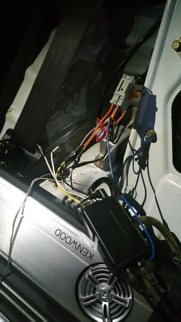

What I did so far is connect the line converter where the factory amp suppose to be and re use the wiring harness. I havent tested out yet since my amp is not receving any power for some reason. Ethier bad ground or there isnt any signal at all
