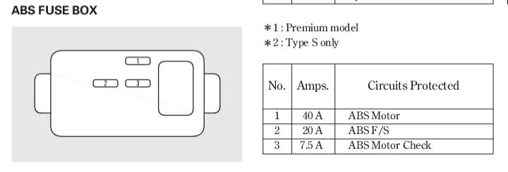

This is all I see from the owner's manual. Where will i be able to find ignition switch, fuse, and relay?
Originally Posted by RoyNeal
Make sure to check the Ignition switch and the Ignition fuses both inside the vehicle and under the hood. Also check the Ignition Relay Switch found under the hood.
