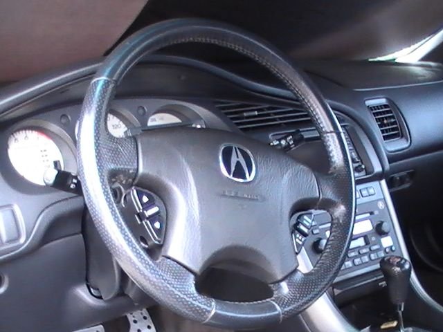

Here are a couple of pictures, one is of my steering wheel & center air bag cover, the other is of my dash air bag cover:
Believe it or not that steering wheel air bag cover was originally 'parchment' color not black. I bought a 2nd newer black
leather steering wheel, from a member on this forum, years ago because the parchment leather coloring had
worn away from heat & sun exposure on my factory original. I took the center airbag cover from my old steering wheel because it had
the 'updated' airbag inflator installed. As you can see, compared to the shiny black perforated leather, on the
steering wheel, the subdued black 'substrate' is not as shiny.

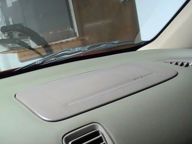

The passenger side dash air bag still has the 'parchment' coloring and has not yet become 'sticky'. This was the
original color of my center airbag cover on the steering wheel.

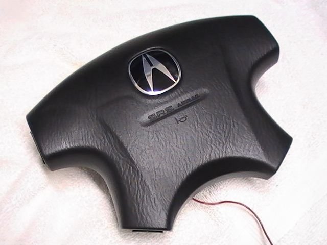

Here is a picture of the airbag cover with a 'test' spot next to the Acura logo. As one can see there are two different
shades of black. The sticky deteriorated OEM black colorant shows a lot of debris.
If you accidentally 'rub' up against this deteriorated sticky stuff, it will ruin and nice expensive dress shirt in no time at all!
The use of a terry cloth rag and the M39 removed all the OEM black colorant with ease. I found using a circular
movement with frequent application of the M39 worked fastest and the best. Just make sure not to flood the rear
components of the airbag cover or get it in the electrical connectors.
The finished airbag cover below.
Picture of rear airbag for those interested.
Up close picture of the 'grain' of the airbag substrate. If you don't get the deteriorated colorant out of these fine
areas, it will still feel sticky. The terry cloth rag 'loops' made for a sufficient friction material to remove.

Installed back in the car. It appears dull now; however, I still have to do the passenger side dash airbag and will
apply some armorall after completion.
