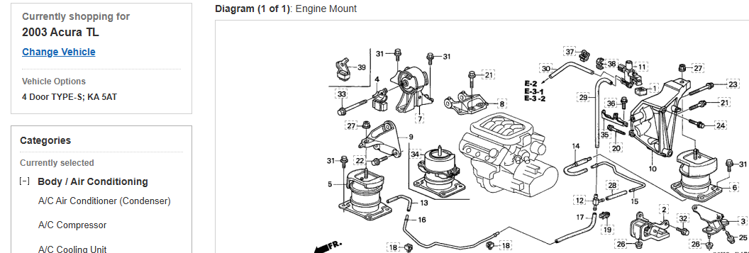

Surging may be due to a dirty or failing IACV or a vacuum leak as mentioned. It's important to check the smaller vacuum hoses to all the motor mounts and the #11 Mount Control Solenoid connections below for deterioration / failure.
When my '03 automatic CL-S through a cylinder misfire code, the VSA light always came on and it would turn off when clearing the code.

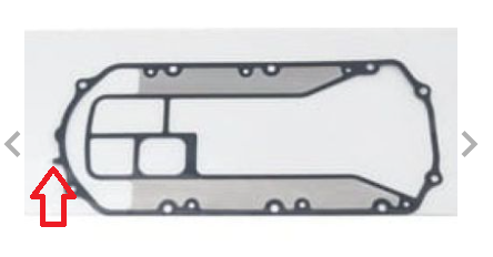

Also, make sure if you have removed the upper inlet manifold cover that you replace the metal upper inlet manifold gasket with the little 'tab' toward the firewall side of the engine for proper fitment.
