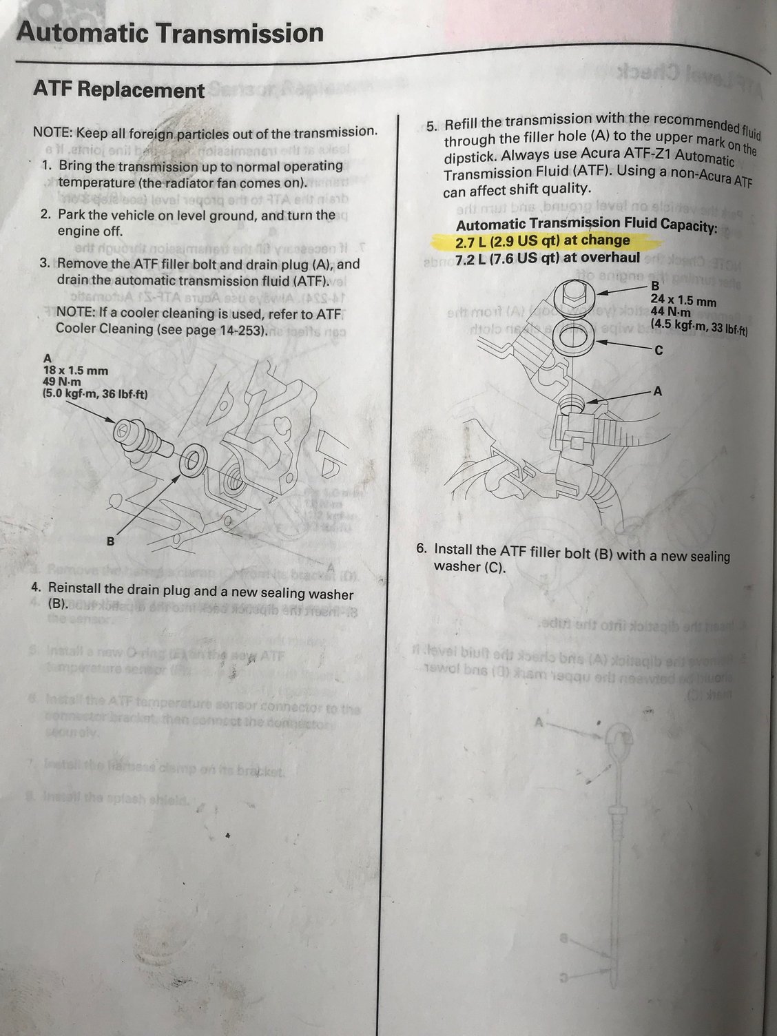

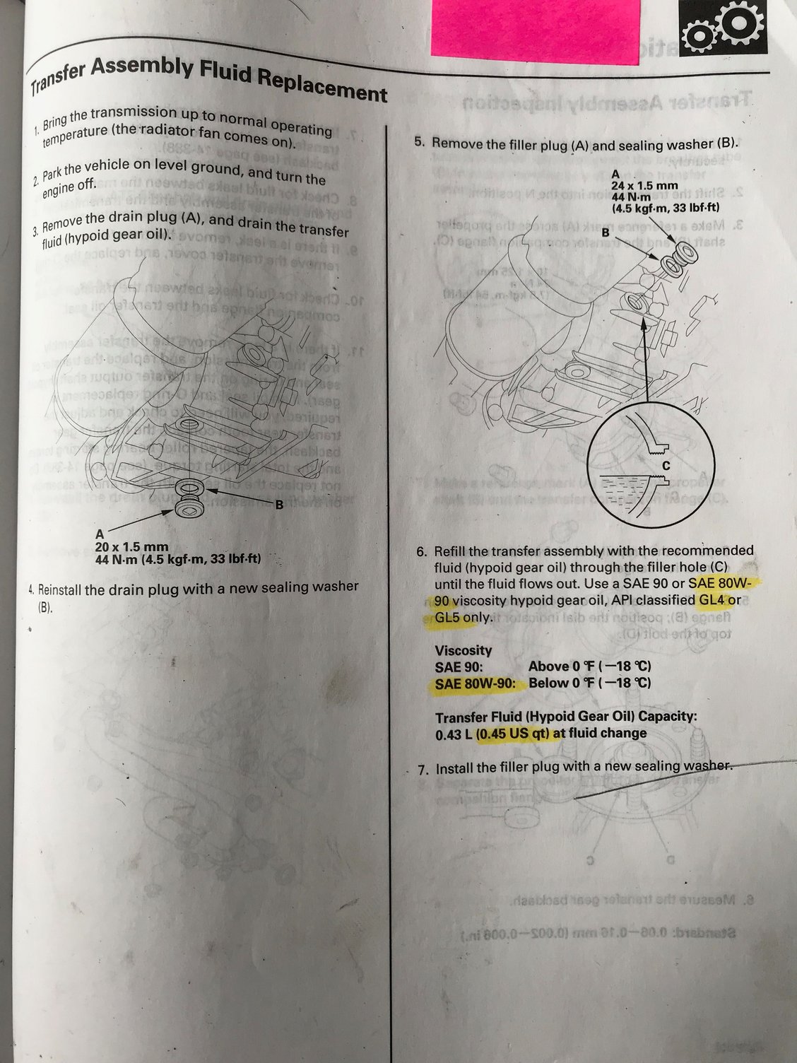

2nd Gen Acura RL Transmission Fluid / ATF Change
From the Factory Service Manual (FSM) below. There's no filter to change. Remember, there's automatic transmission fluid (ATF) to replace AND the transfer assembly fluid AND the rear differential fluid to replace. The FSM says to replace ATF at 60,000 and then every 30,000 miles thereafter. Rear differential fluid should be replaced every 15,000 miles. The front two mechanisms are also referred to as "clutch chambers," while the rear diff. is also referred to as a "Hypoid gear chamber." Fluids for each are specified below in the images.
ATF check
ATF replacement
Transfer Assembly Fluid Replacement

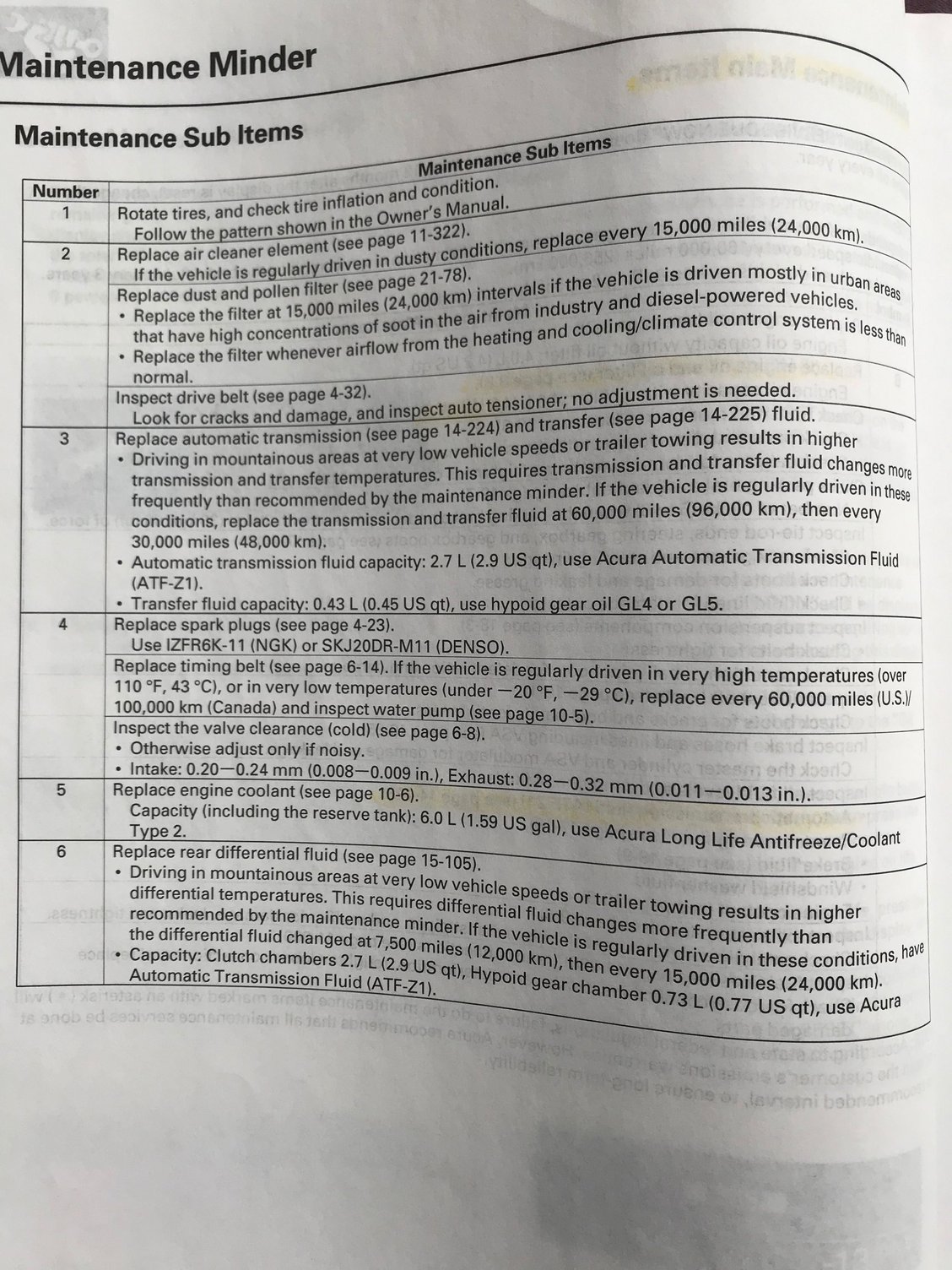

2nd Gen Acura RL Transmission Fluid / ATF Change, Maintenance Minder
2nd Gen Acura RL, transmission, transfer assembly and rear differential fill & drain locations.
B) Automatic Transmission assembly
C) Transfer Assembly
D) Rear Differential
2nd Gen. Acura RL, Maintenance Main Items.
2nd Gen. Acura RL, Maintenance Sub Items.

[QUOTE=huRLingsnow;16576384]From the Factory Service Manual (FSM) below. There's no filter to change. Remember, there's automatic transmission fluid (ATF) to replace AND the transfer assembly fluid AND the rear differential fluid to replace. The FSM says to replace ATF at 60,000 and then every 30,000 miles thereafter. Rear differential fluid should be replaced every 15,000 miles. The front two mechanisms are also referred to as "clutch chambers," while the rear diff. is also referred to as a "Hypoid gear chamber." Fluids for each are specified below in the images./QUOTE]
As I read that, it only requires the specified intervals if more severe driving conditions are present (mountainous driving, towing, etc.). Otherwise I think Acura recommends only changing when the MID tells you too. Right?
