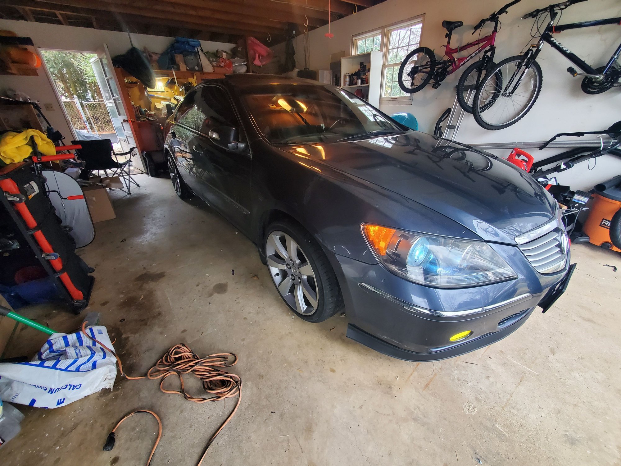

05 RL 99k Miles Picture taken (2/2/2022)
