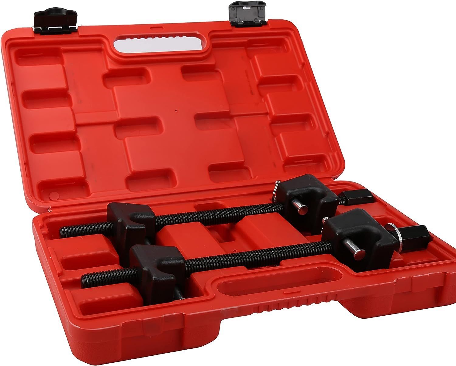

Sort of a side note: I purchased KYB shocks for the rear and the front some time ago, because they were available and there was a lot of talk about the clunking and other sounds. This last week I decided to replace the struts.
Spring Compressor
I 'rented' the spring compressor pair, but was utterly unable to compress the springs enough to be able to mount the shock absorbers inside them. In the process of spring compression, one of the two would inevitably slide, so the two would no longer be 180 degrees apart. After a considerable amount of unsuccessful effort, I took the first strut to a shop, where they assembled it for $75, then re-installed it in my car. I will drive there and have them do the other next week.
The diameter of the spring coil seems larger than in any of the examples I saw of the compressing tool's usage. It was very frustrating. In looking at the various versions of this tool for sale on Amazon, I note that some of them specify the largest diameter coil that they are made to work with, although nothing of the sort is ever mentioned in any of the videos *I* found about doing this job yourself. I also noticed that in any video or illustration, the pitch of the coil spring was much less than the pitch of the actual coil spring on the RDX, making the slipping I experienced more likely.
