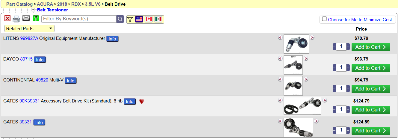

Take your pick of the selection below from RockAuto, they beat the dealer by a mile:

All you need to do is service the pulley and change the belt, my 2013 tensioner with 210k miles is in great shape.
No sense changes tensioners until they start jumping after the cutoff, which causes vabling noise.

Thanks i played safe and order the gates kit with both the band & tensioner
