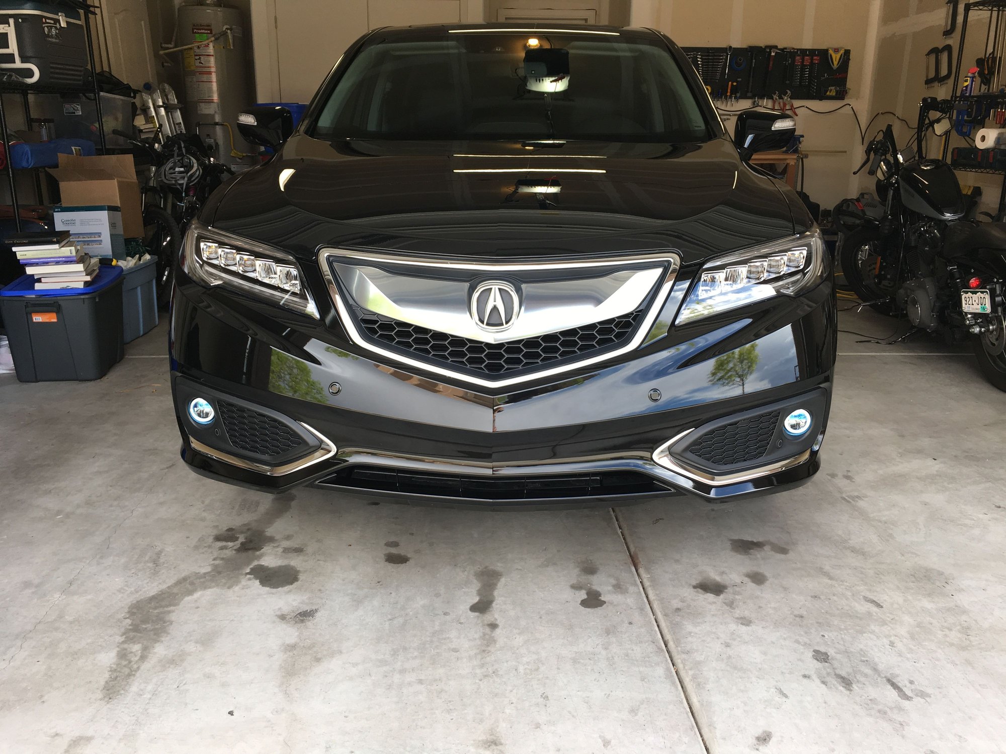

Just installed the OEM fog lights on my 2017 RDX, not a hard install. It's weird that the lights are blue, but they still look good. I chose to go this route after being disappointed with the quality of the morimoto fog lights.

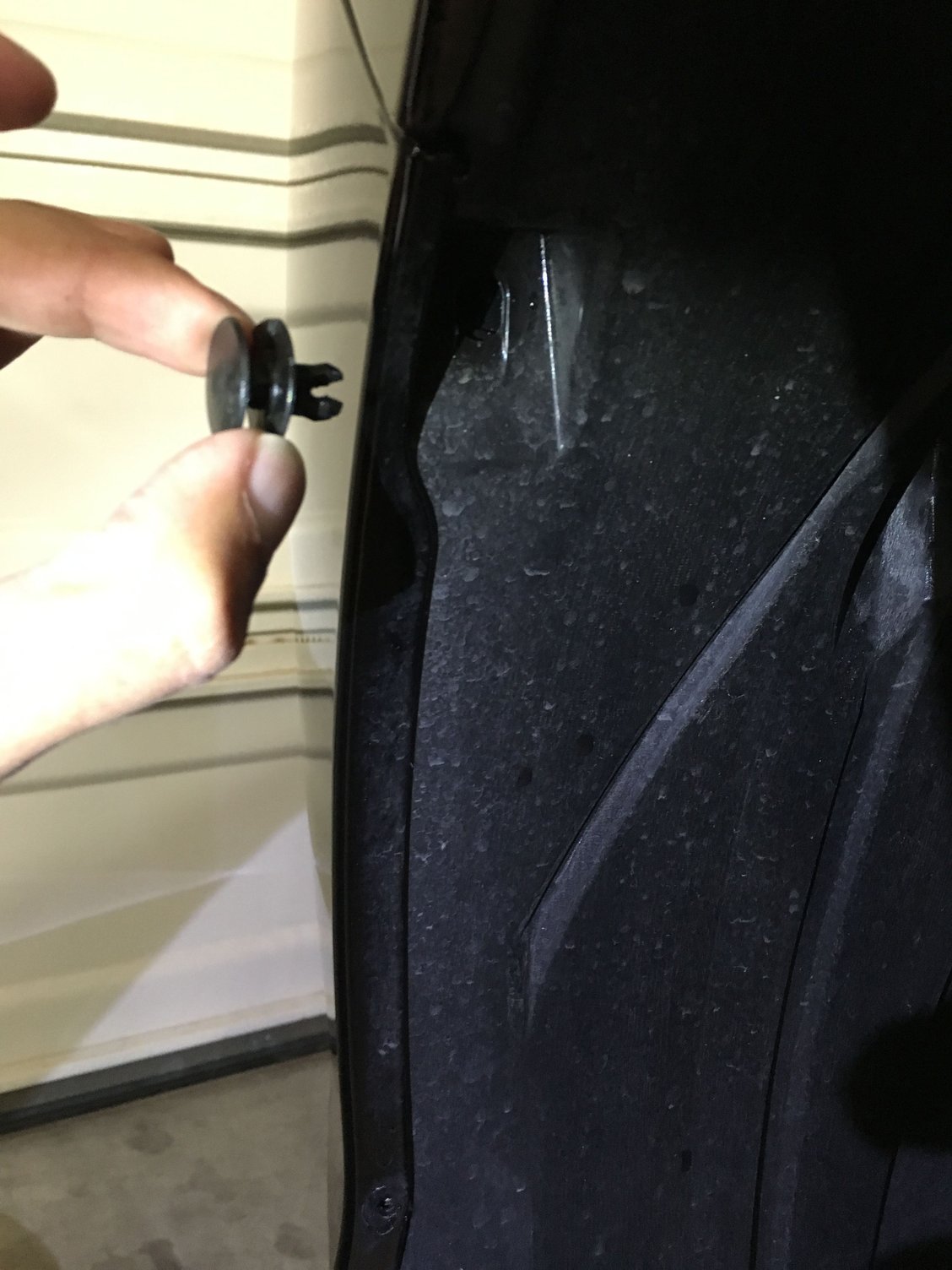

The easiest way to do the install was to first remove the 4 clips underneath the bumper right under the fog lights, a screw and clip in the wheel well, for each side of the vehicle.
Here are the stock lights vs. the LEDs installed.
Left side wasn't to bad but the right can be a little tricky, the windshield wash reservoir gets in the way of one of the screws. To get around it I used a small ratchet with a Philips head bit.
Here is the finished look.
