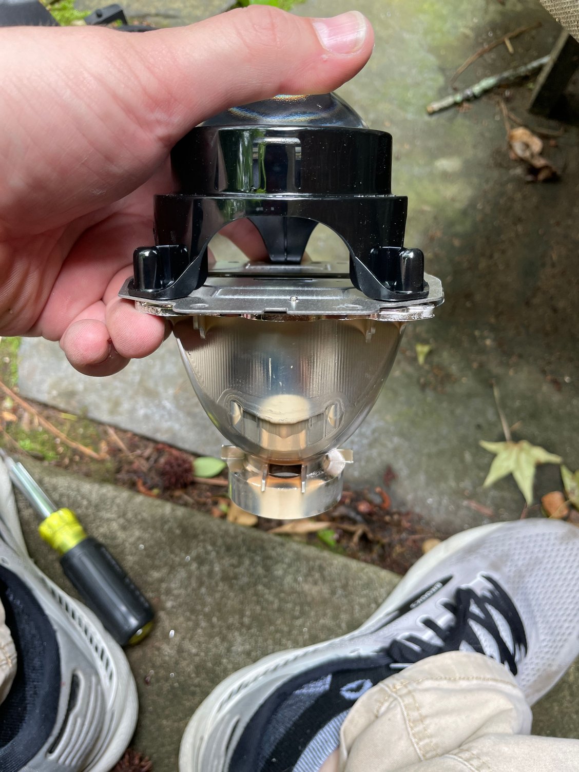

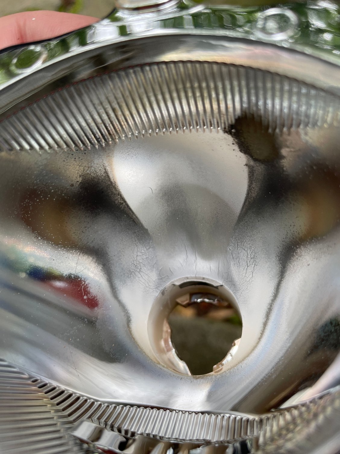

Hi everyone,
Recently I took it upon myself to replace the halogen headlight assemblies in my mom’s ‘13 RDX Base, after I drove it one night and basically had to use the high beams the entire time. I opened up the old headlight assemblies to inspect the projectors, and found that both sides had burnt reflector bowls. To prevent this from happening again, I’ve installed some high quality LED H11’s for the low beam projectors in the new headlight assemblies. I dunno about the longevity of the LEDs, but I’d rather be replacing those every few years than replacing the entire assemblies again.
Thoughts?

Likes: 9,163
Are you replacing the bowls in addition to the LED drop in bulbs?
Old May 7, 2023 | 11:25 AM
bpr97050's Avatar
8th Gear
Joined: May 2023
Posts: 8
From: Georgia, USA
I swapped in some new headlight assemblies and put LEDs in those. I took the old ones apart just to see where exactly the point of failure was, and to confirm my suspicions.
Old May 7, 2023 | 12:45 PM
Posts: 48,279
Likes: 9,163
Good man, was gonna say that the new bulbs in old burnt bowls wouldn’t do much with regards to luminosity.
