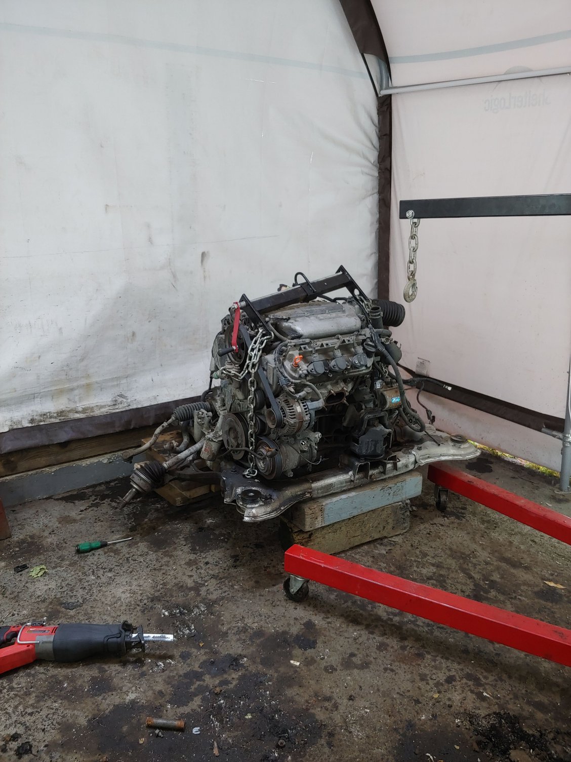

Out from the bottom
Some progress on the project

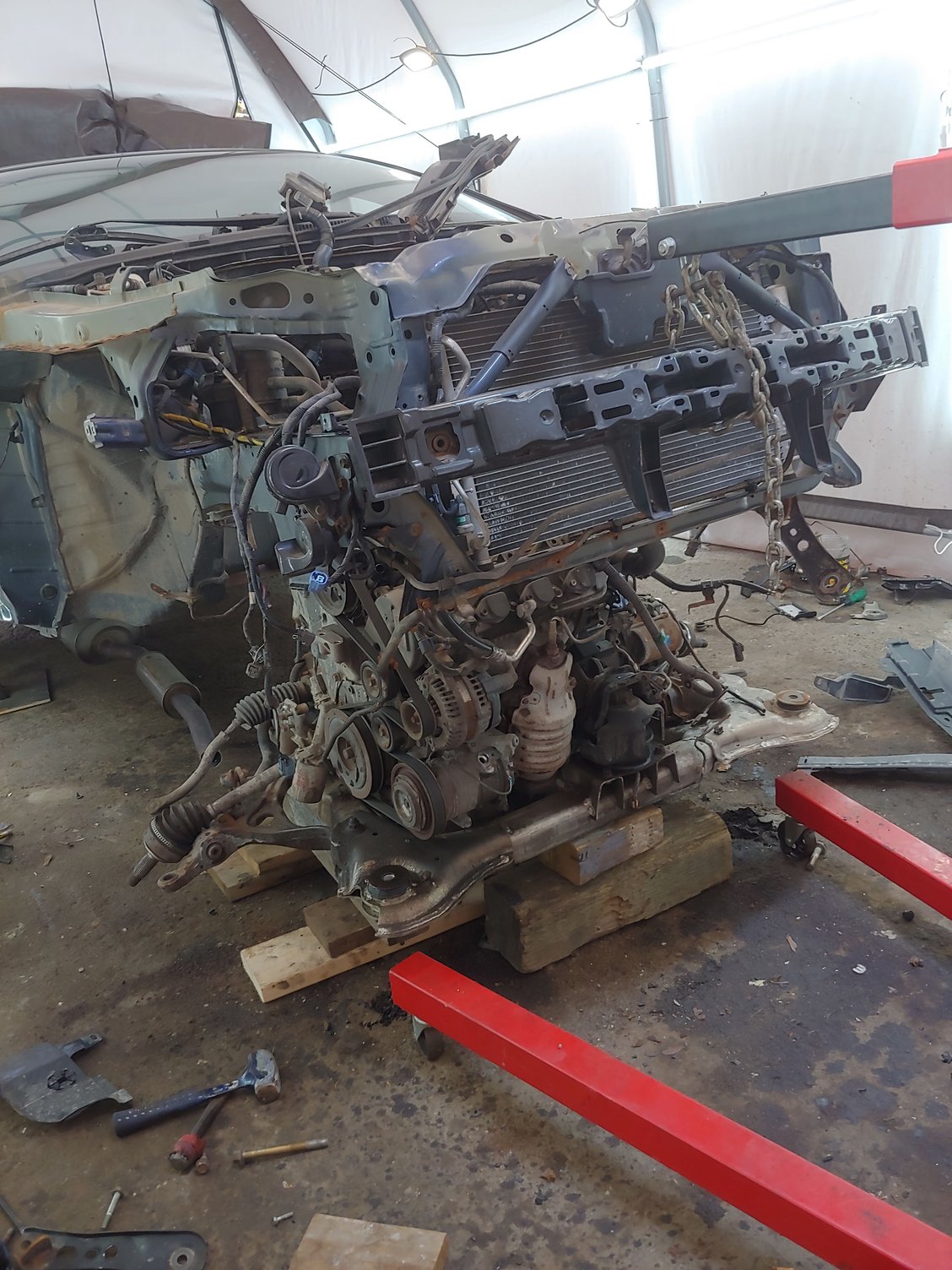

Some progress. I decided to dig right in yesterday.
List of things going on:
P2R big tubes
P2R poly subframe bushings all around
P2R poly radius rod
AC delete
Luk oem style clutch and flywheel
Civic CMC
AEM EMS
AEM wideband
Trubendz 3" ( stilll deciding on single pipe or dual.. i dont wanna buy 2 mufflers lol)
3" cat, resonator and muffler (s?!)
New fuel lines and possibly upgraded pump ( i got a gas smell i think my lines are rotted underneath somewhere)

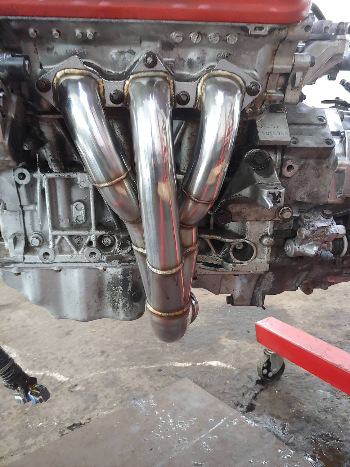

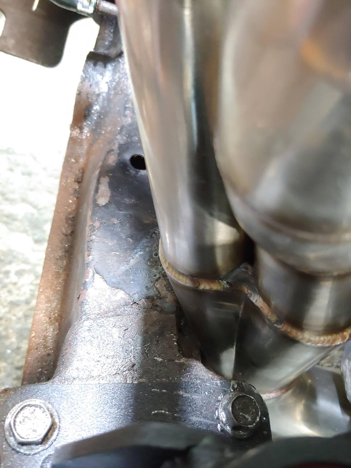

The front headers were hitting the subframe so trimmed a small tab off the 2nd layer and then made 2 small cuts heated and smashed in a small section. Weld the cuts after.
Thats it now with decent clearance. Im not worried with the 95a mounts.
Pictures arent the best to show the subframe clearly but it was JUST touching. Maybe a hair away.
Old Jan 31, 2021 | 06:14 PM
Posts: 6,911
Likes: 2,214
Those big tube headers look great.
You are going to have a nice sounding NA beast with that manual J35A3.

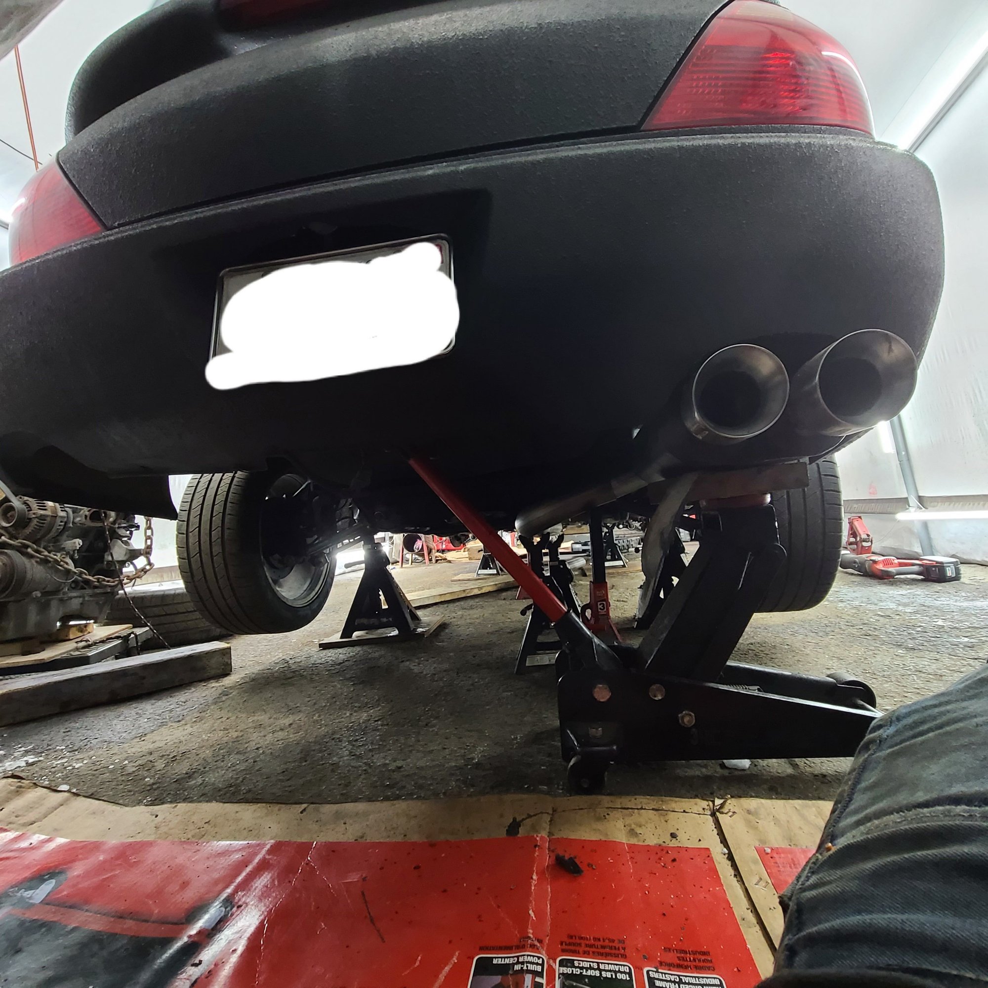

3" super50 Dual 2.5 out.
Ill have to do something to the empty side.
Ill post some sound clips after i figure out all the wiring for AEM EMS.

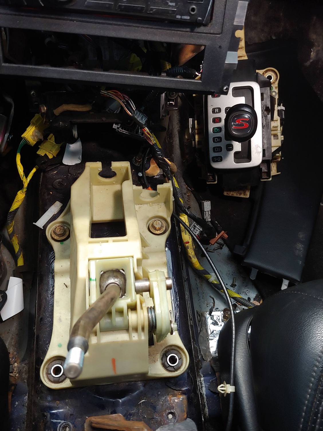

One question:
Since you are utilizing the 05 TL shifter assembly and lines, have you had a chance to see if the TL shifter assembly has a matching 'foot print' to the CL's chassis mount area? They are probably pretty close?
Can't tell from the vendor parts diagrams if they are close;
CL-S6:
Shift Lever for 2003 Acura CL COUPE | Acura OEM Parts
CL-S auto:
Select Lever for 2003 Acura CL COUPE | Acura OEM Parts
05 TL6:
Shift Lever for 2005 Acura TL SEDAN | Acura OEM Parts
Old Jan 31, 2021 | 06:39 PM
613CLS's Avatar
Joined: Oct 2017
Posts: 107
Likes: 35
2 bolts lined up the other 2 were drilled and the whole center console was shimmed up an inch in the rear the clear it with the boot on otherwise moving side to side would bang the surrounding plastic.
Old Jan 31, 2021 | 06:41 PM
613CLS's Avatar
Joined: Oct 2017
Posts: 107
Likes: 35
I also ended up purchasing cls6 pedals from ebay because the TL pedals lined up funny.

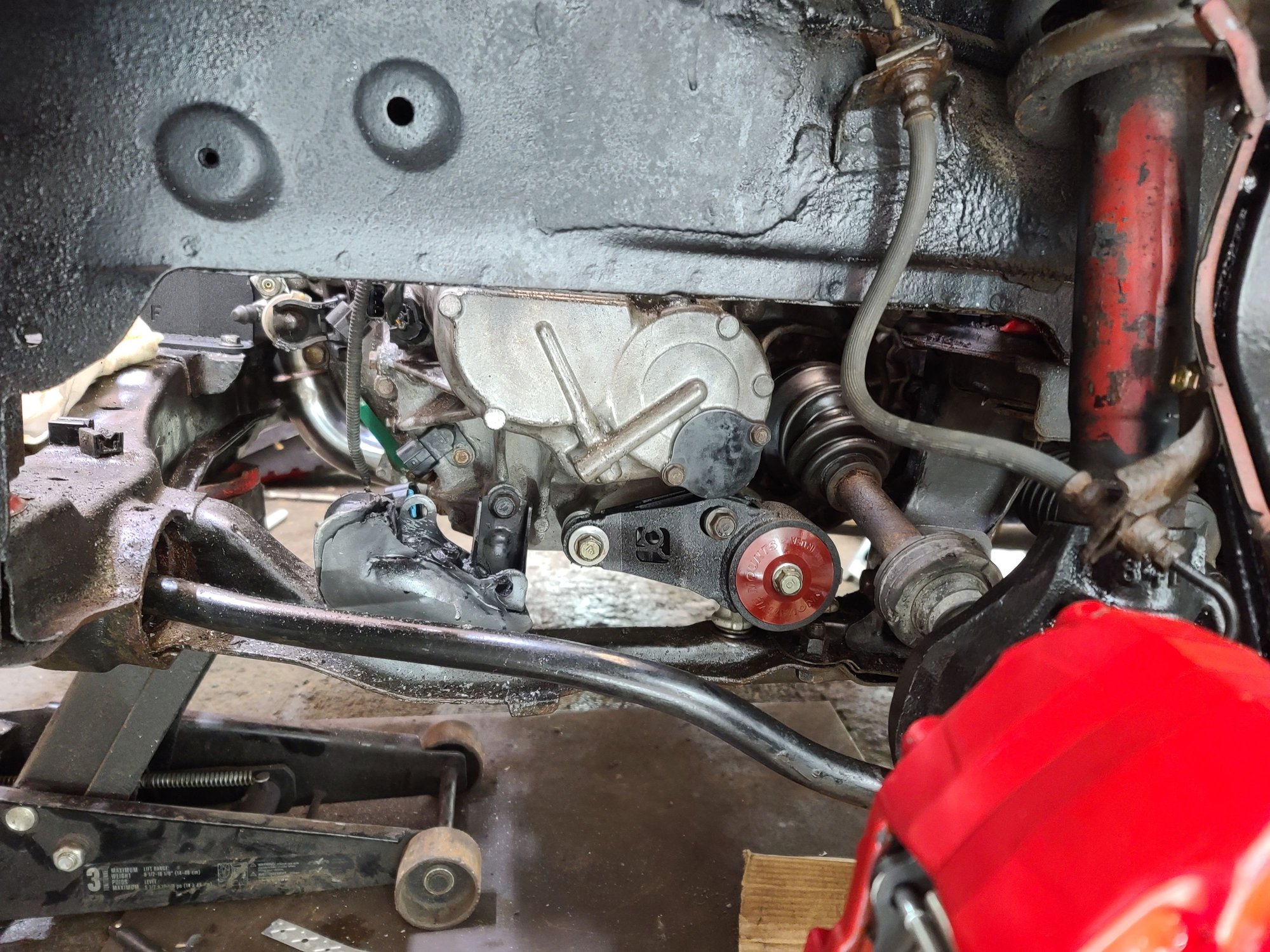

For the discontinued cross beam mount for transmission i used the 05 tl mounts.
Modified front mount. I cut that "ear" piece off my stock right side motor mount.
Innovative mount on the back. A few washers lined everything up square.
Rivnuts attached this mount to the frame rail. Battery relocated to trunk to make this work. You could still find a way to mount battery near oem spot but i decided on rear right trunk area for battery.

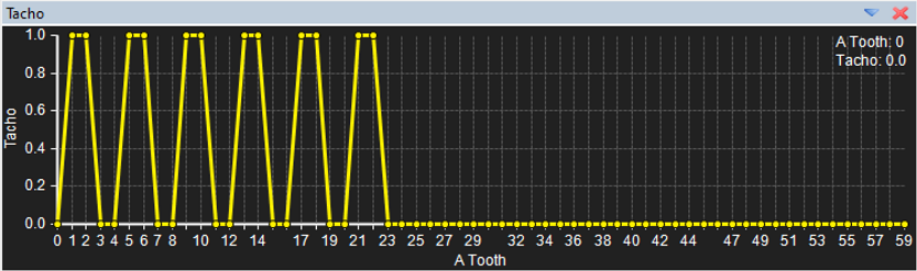

Here we go got her started first time on AEM EMS.
Old Feb 7, 2021 | 02:30 PM
613CLS's Avatar
Joined: Oct 2017
Posts: 107
Likes: 35
I had to complete the starting cut relay circuit by grounding blu/white wire where the transmission range switch used to hook up in engine bay.
ILl probably wire it into the clutch pedal switch after. For now its just looped on the connector.
this was the only problem i really ran into.
My rpm output is messed up probably because the Aem ems is wired for a civic dash?
Correct. The AEM is sending 4 pulses to the Tacho for every engine revolution (one for each cylinder) because it's tuned for a 4 cylinder cluster (which obviously expects 4 cylinders per revolution). This means that your RPM will be 66.6% of what it should be. Change your Tacho graph under the "Tacho-Speedo" tab to something like this:
This setup will have the AEM send 6 pulses per revolution, as there's 24 teeth in the timing gear I think. This takes all of 5 minutes, but some people still say you have to use a 4 cylinder cluster lmao.
