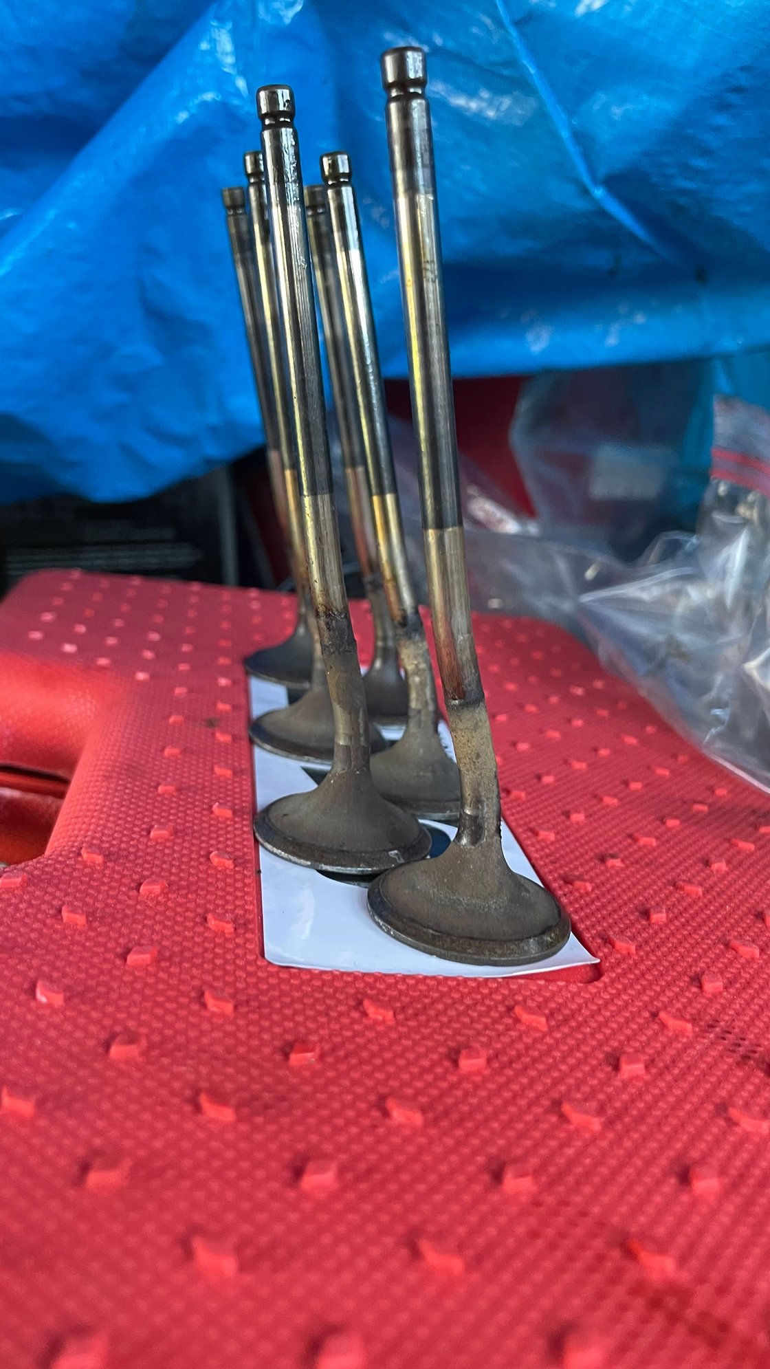

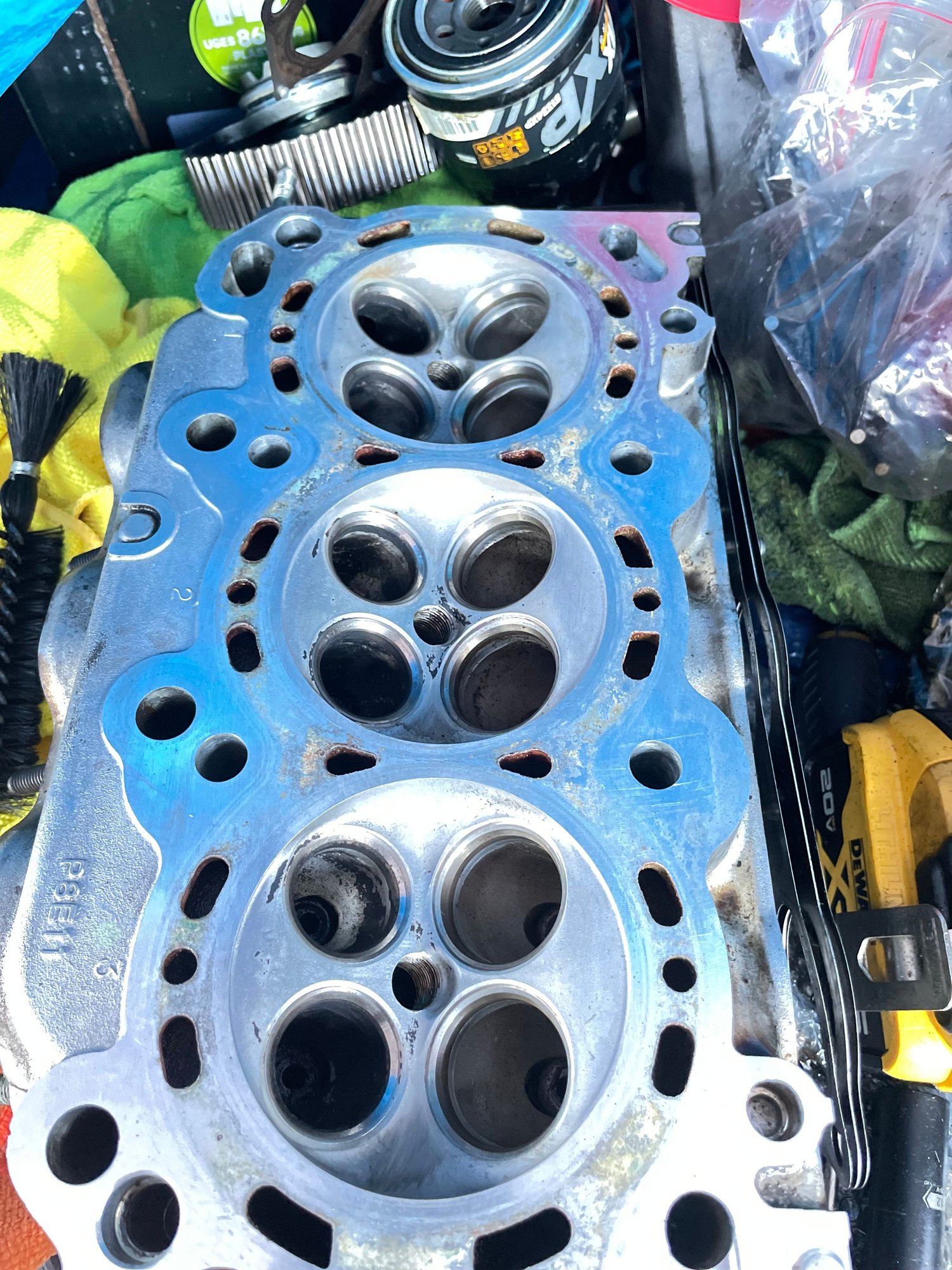

Hammered out bank 2 exhaust valves earlier today. Cleaned the head ports as best I could.
