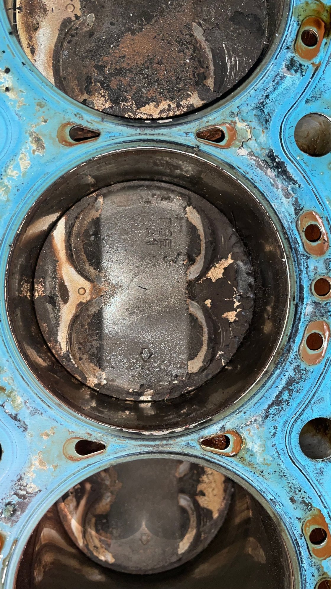

I needed some insight and knowledge on this rebuild/project soon to be underway. I have an 02 Acura CLS that at very least, needs a top end rebuild since the idler pulley bolt snapped while i was driving on the highway. Factors to include are that I need to get the car on the road asap, and I'm on an extremely tight budget. I'm considering things for the future as well , but if i can upgrade parts and can source them for cheap while i have the engine out and opened up, I'd like to entertain the idea of taking care of them now. I've been researching and trying to create a plan of action since this happened 11/28/24, and would like this to be done by the time the new year rolls in. A friend of a friend offered to help me out by extracting the bolt and rebuilding the top end for $1k (thats basically my budget -- hard line), but that'll be after New Years.
Aside from extracting the broken idler pulley inside the block, I know I need to replace the valves, get a valve adjustment, get new valve springs, regrind the cams (most likely), and resurface the heads. Is there anything else I need and are there any suggestions as far as the best approach?
I was thinking of picking up a used j35a3 engine from an 2001-02 Acura MDX and doing an engine swap, or picking up j35a4 heads from an 03-06 MDX for more power at a decent price. Additionally, I have some typical bolt ons and have been maintaining the car pretty well, almost every month doing something for my CL. Attached is a list of mods and maintenance that I've done since i purchased it. Lastly, I have a j37a4 IM I've been waiting to attach, with the adapter for my j32a2 throttle body. I have a j37a4 TB as well, but i believe they're incompatible with the j32a2 harness. I also have a j37a1 IM + TB, if that would work better for my 02 CLS. Any advice is appreciated. I just ask to focus on instruction, rather than opinions. This was my dream car as a kid so I plan to build this up and keep it running to a million miles and pass it down to my son.

Update

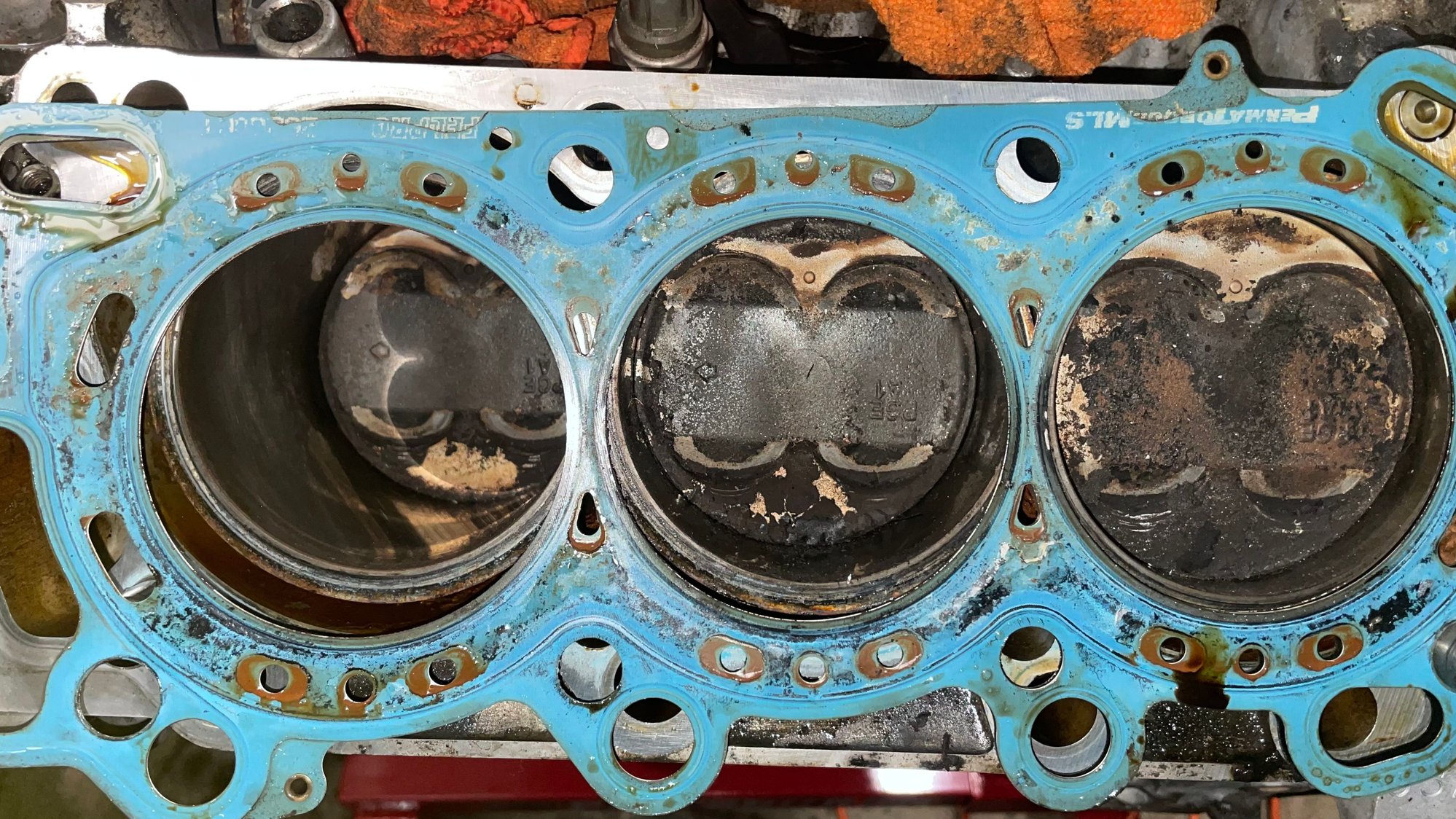

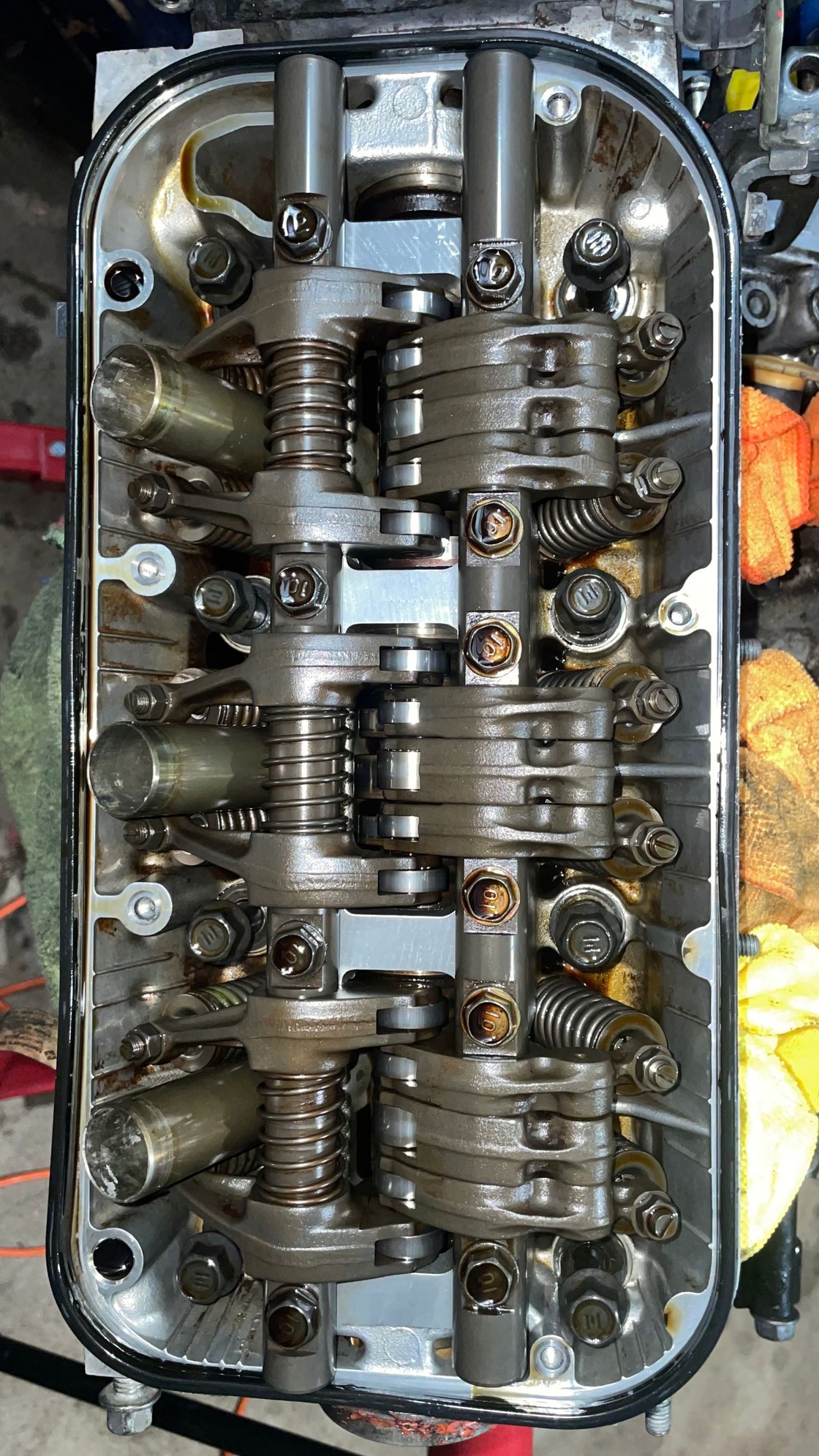

Just an update. So I passed on the $250 j35a3 bc they pointed out that there was another stock number written on it from another salvage yard meaning the engine was swapped out before making it to their yard so I didn’t wanna take that gamble. There was another shop that had it for $400 122k mi but im kinda skeptical of shops that post on car-part.com with an x as a part grade. Man sounded genuine over the phone but i don’t have the money buy the engine and transport it to my place. The other place sold the engine before I could get it so here I am rebuilding my j32a2 for now while I wait for a j35a3 to pop up on the market. Here are pics of the heads:
both sides looked like this. Under the valve cover looked good and both gaskets looked new (replaced August 2022).

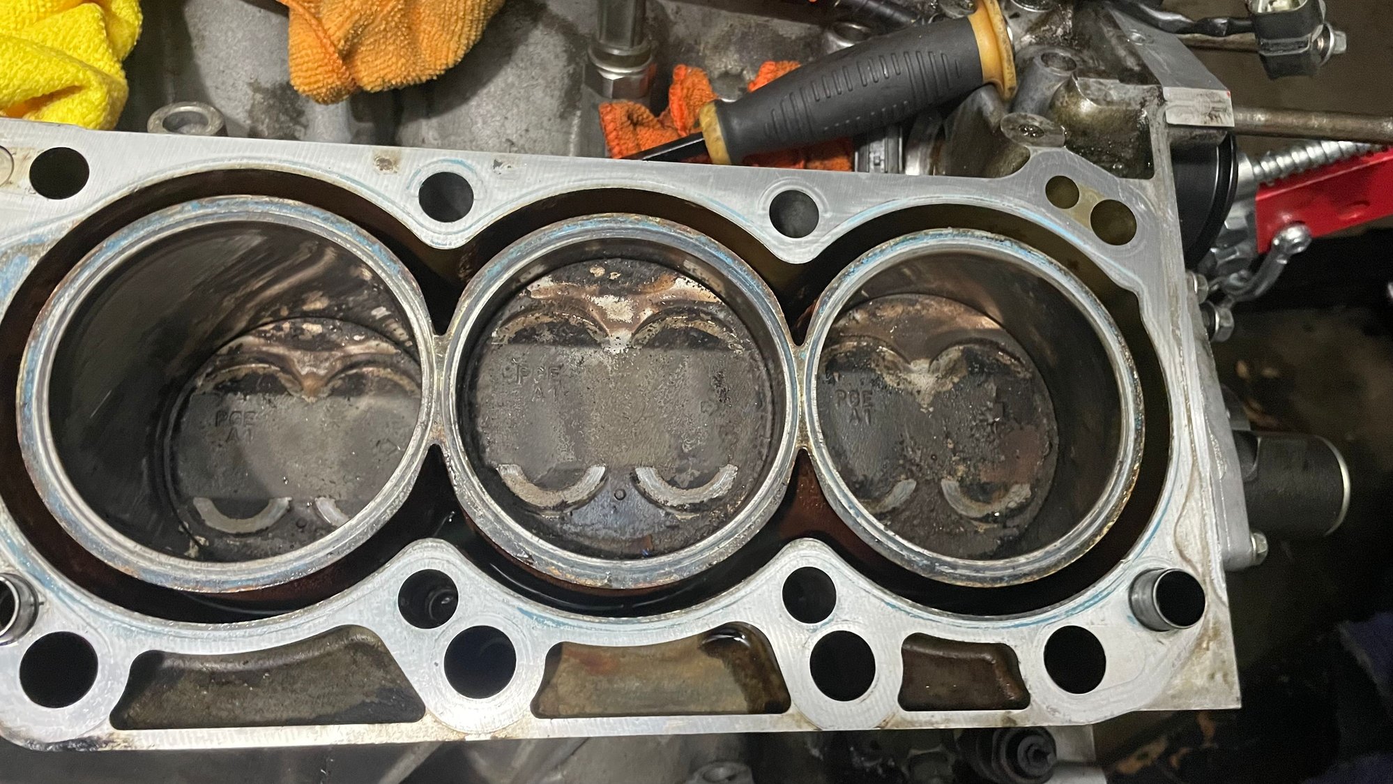

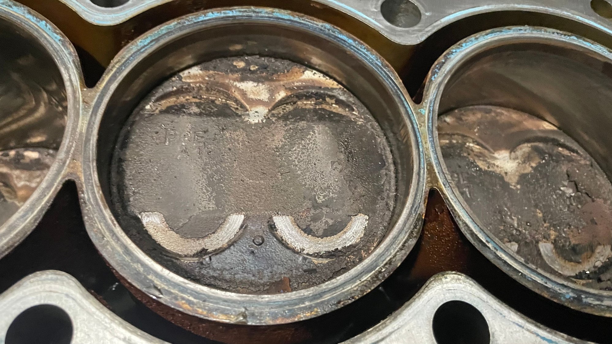

here’s a pic of the pistons. They don’t look damaged from the timing belt coming loose so I don’t think any valves hit them but maybe someone can give me a diagnosis on what they see. It just looks like carbon build up to me. If someone can give me tips on how to clean those up, I’d appreciate it. (Head gaskets done August 2022)

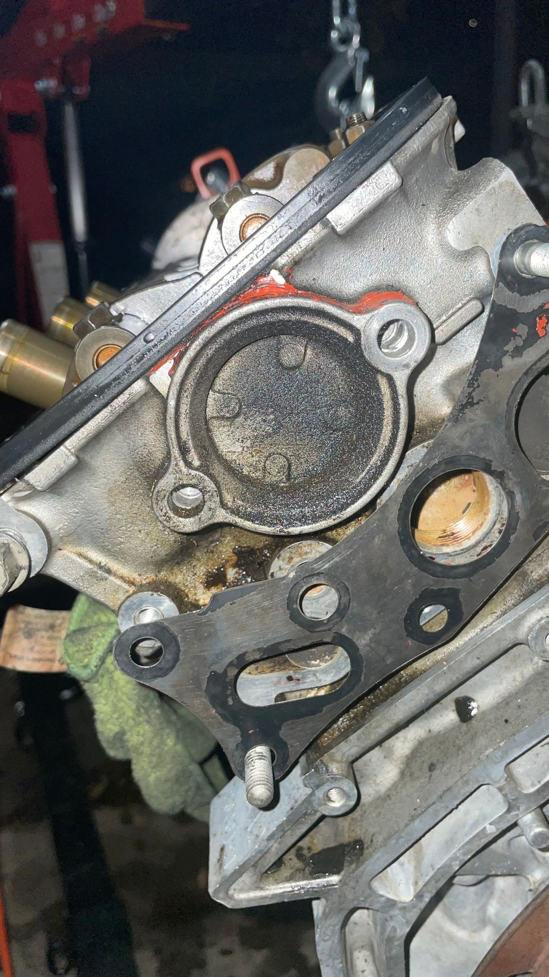

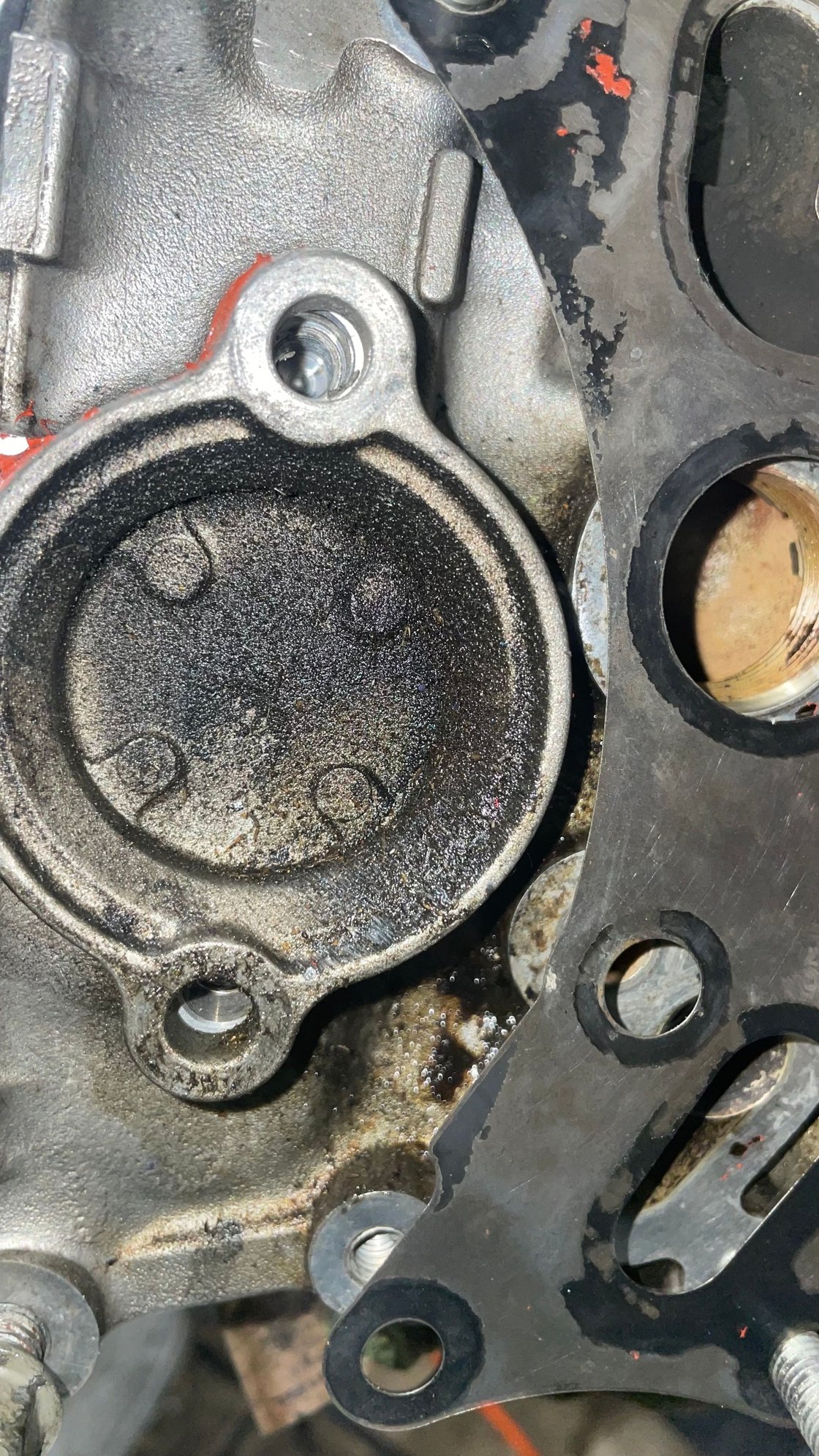

additionally: am I missing 2 bolts that go into this thing? (Ignore the red silicone)
notes:
water pump had some orange sludge (coolant oil mix??)
oil was leaking on the rear side and from what looked like the oil pump.
I should have taken pics but I was in the moment and decided to clean it up right then and there.
Old Jan 25, 2025 | 01:10 PM
Posts: 6,930
Likes: 2,218
Yes, there should be two bolts, shown below, that hold that camshaft thrust cover to the head. Though I suppose, it's possible the head bolt bosses could be stripped to explain why they are missing & the cam thrust cover is 'glued' on with RTV??
Not sure, though, it appears the carbon in the areas of the piston below appear to be suspect for possible valve contact???
Do you have close-up pictures of the valve side of the heads, versus the rocker / cam side provided above, to see if any valves look as if they had piston contact occur??
yup I figured the camshaft thrust part this AM. Going to order a new assembly and the bolts off acurapartswarehouse.com — before I do, would I be able to reuse my felpro head gaskets if they’re 2 years old? They’re not busted. I was going to hit Autozone and pick up a can of hi temp copper spray to coat it.
I will upload pics of the bottom side of the heads later today. Also will try to get clear pic from the intake view as well. They didn’t look bent when I shined a light to them a couple days ago but maybe yall would know more.
thank you for the quick response zeta
