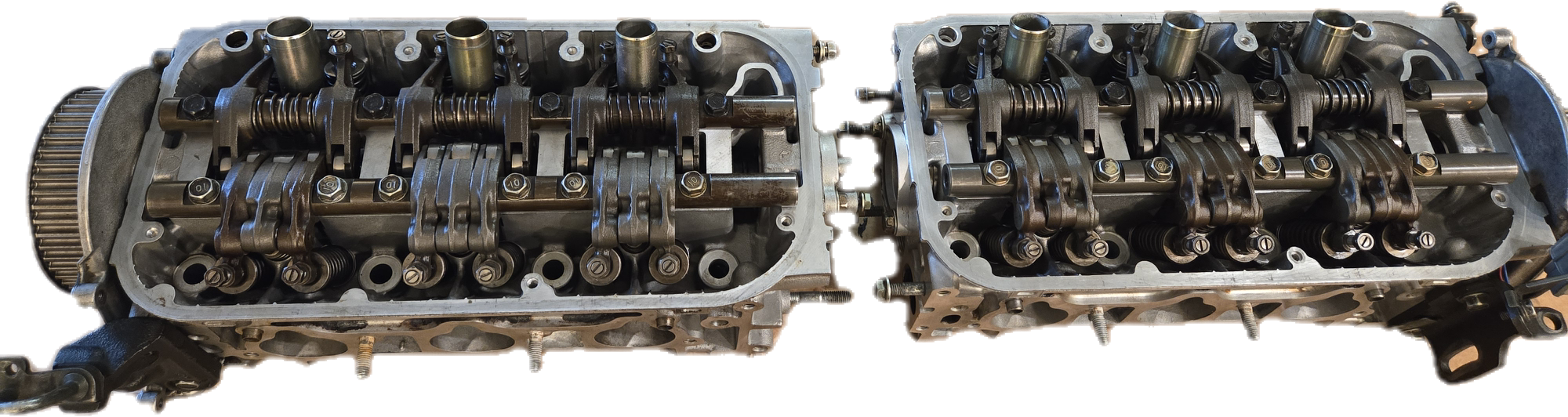

Hey guys,
For anyone who's not familiar, a few months back I rebuilt a j35a3 block, with oversized high comp pistons, j37a1 crank and j37 rods. However, due to issues with leaking valves I opted to swap the valvetrain from used p2r ported heads to resurfaced hand ported heads.
Now back to the point of this thread.... I recently took advantage of p2r's 4th of July sale to acquire new Ferrea valves, oem head gaskets and a few other parts.
Now for the dilemna. Unfortunately, with my v6 prelude project going on I don't have funds for a professional valve job. So, I'm planning to first clean up the chambers and valve seats. Then start lapping the new valves to the heads. Next check for leaks with water, then rubbing alcohol.
Couple before pics:
With any luck the cleaning and lapping will be enough to hold water. Wish me luck guys...

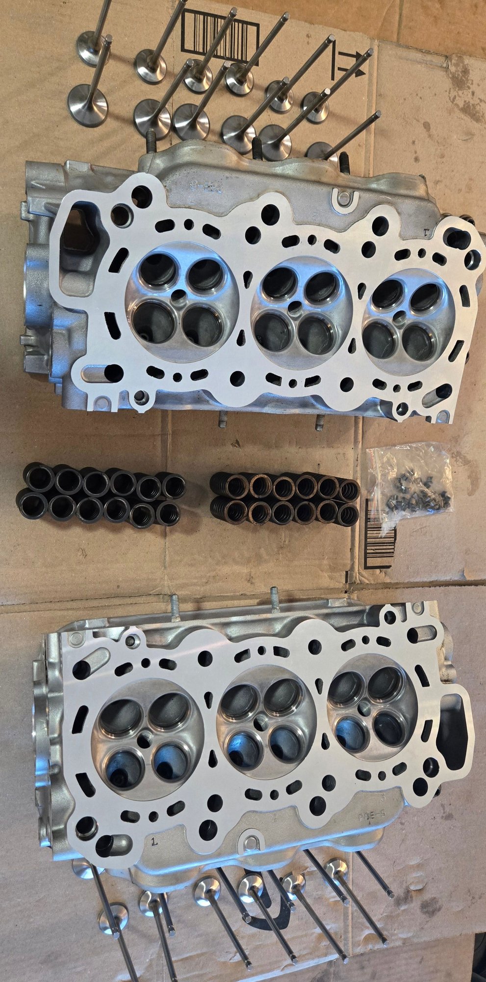

Well, got the heads back from the machine shop couple days ago. Machinist said the castings were really good condition, and the mating surfaces were not warped, so he only took off .002" - .003".
Overall, I think they turned out well for 20+ yr old parts. So, now on to the next phase, valve lapping. Lastly just to clarify, the new intake valves are 36mm, not 35mm.

Finally had a day off after working the past week. Valves are lapped, leak checks complete. Valve stem seals and cam seals were replaced. Also picked up a new timing belt and P2R spacers for the RL cams.
Quick progress pic before starting re-assembly.
For reference the heads will be for a j35 motor I built a while back: 03 CLS block, 05 RL crank, BC j35 rods, 12:1 comp pistons.
