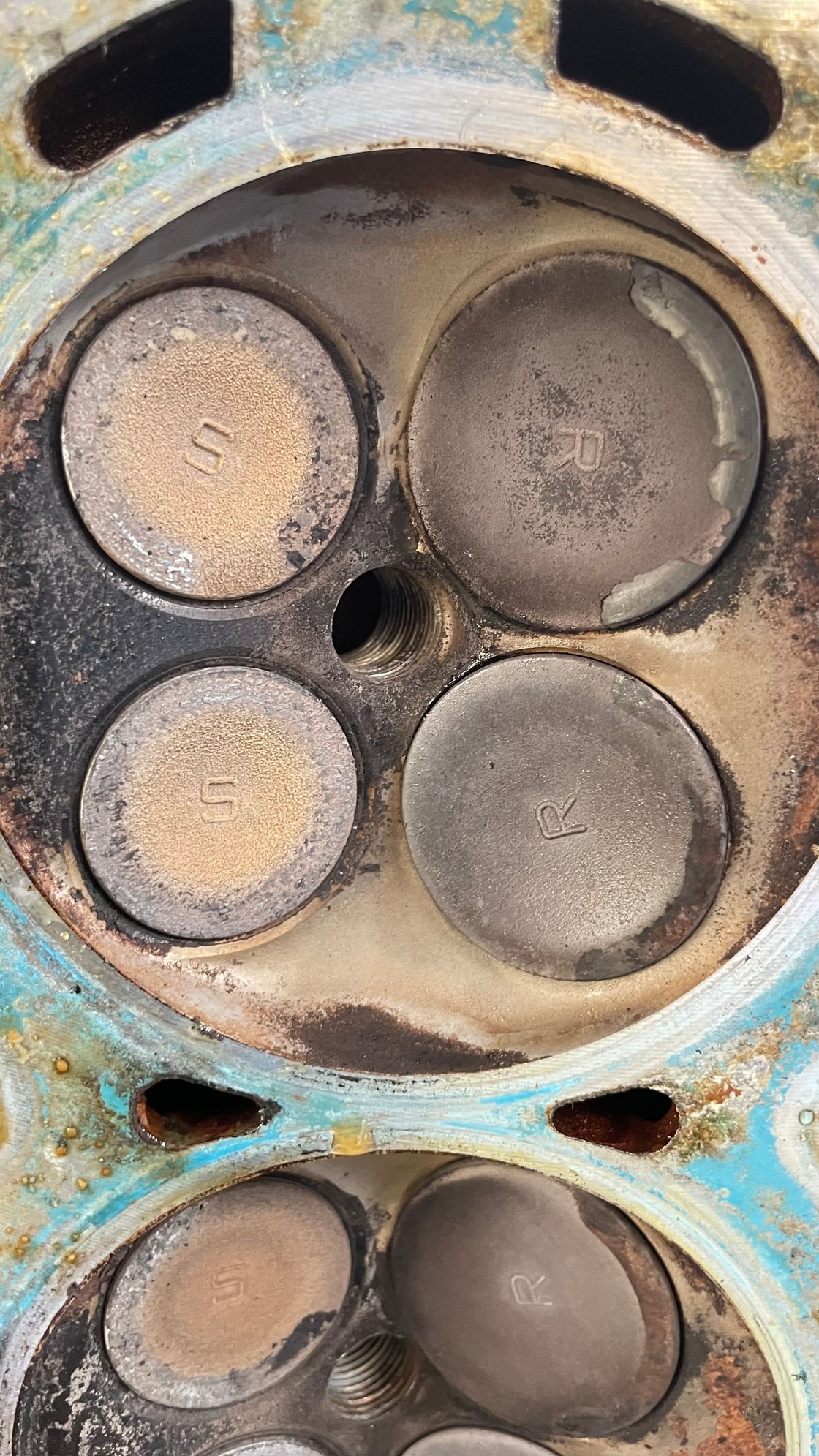

I'm just speculating on those potential contact areas of the pistons above. Hopefully, you & the pocket book escaped any possible piston / valve interference.
619rcr's experienced & trained eye would lend more credence in confirming or denying, though.
Roger that. I appreciate the insight. I shall wait for sensei to return with an answer. Thank you again zeta.

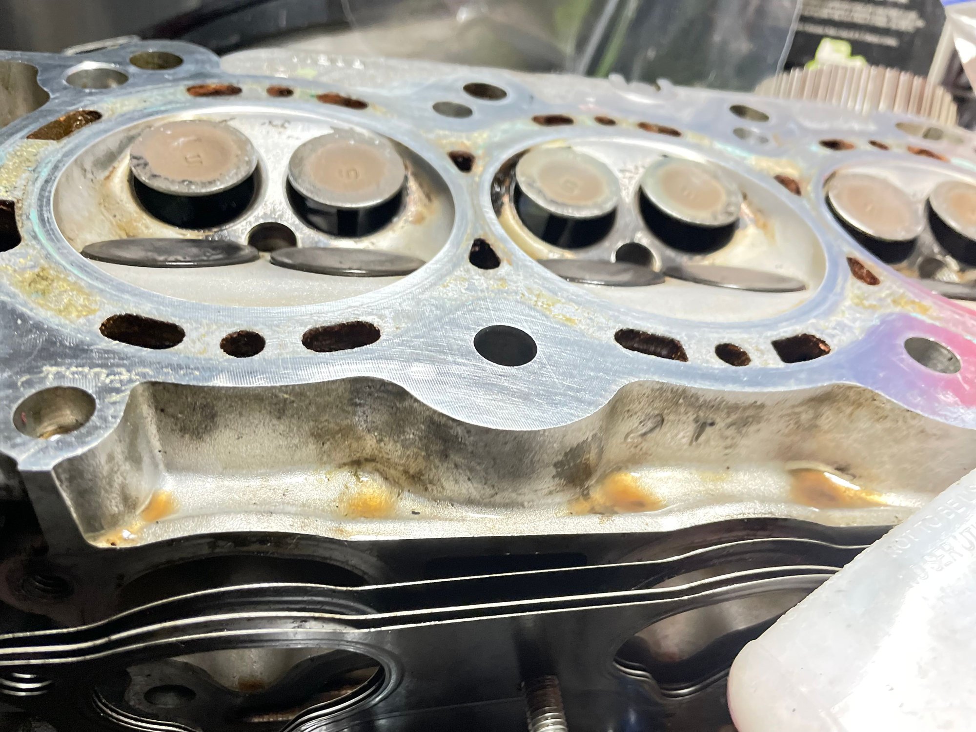

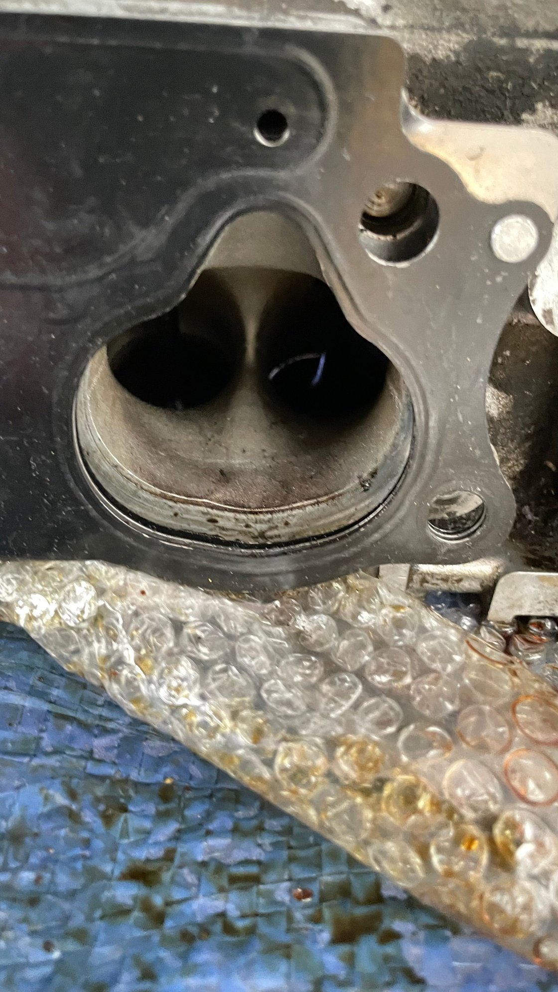

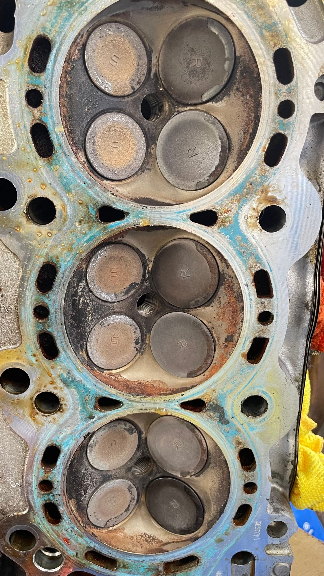

Valves

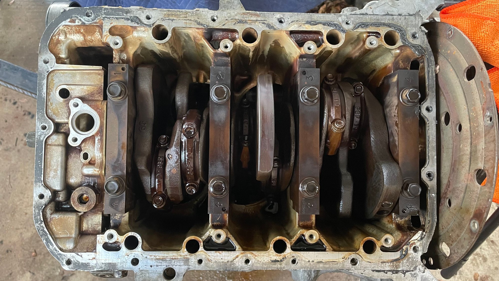

Oil pan removed

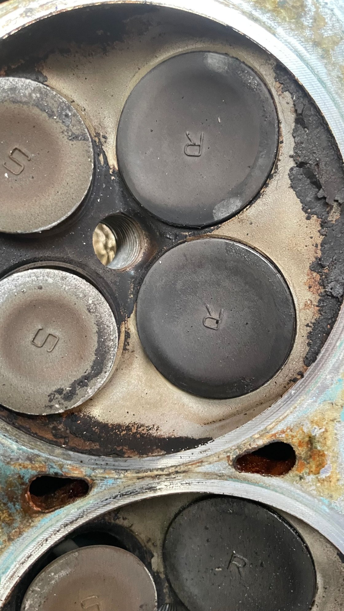

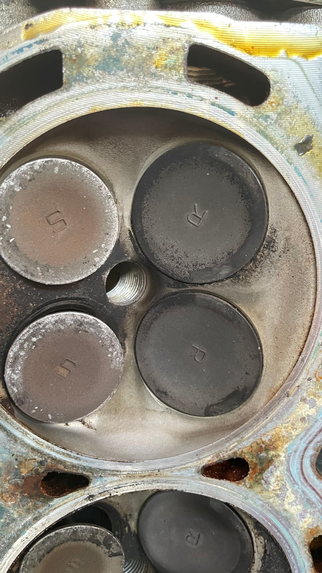

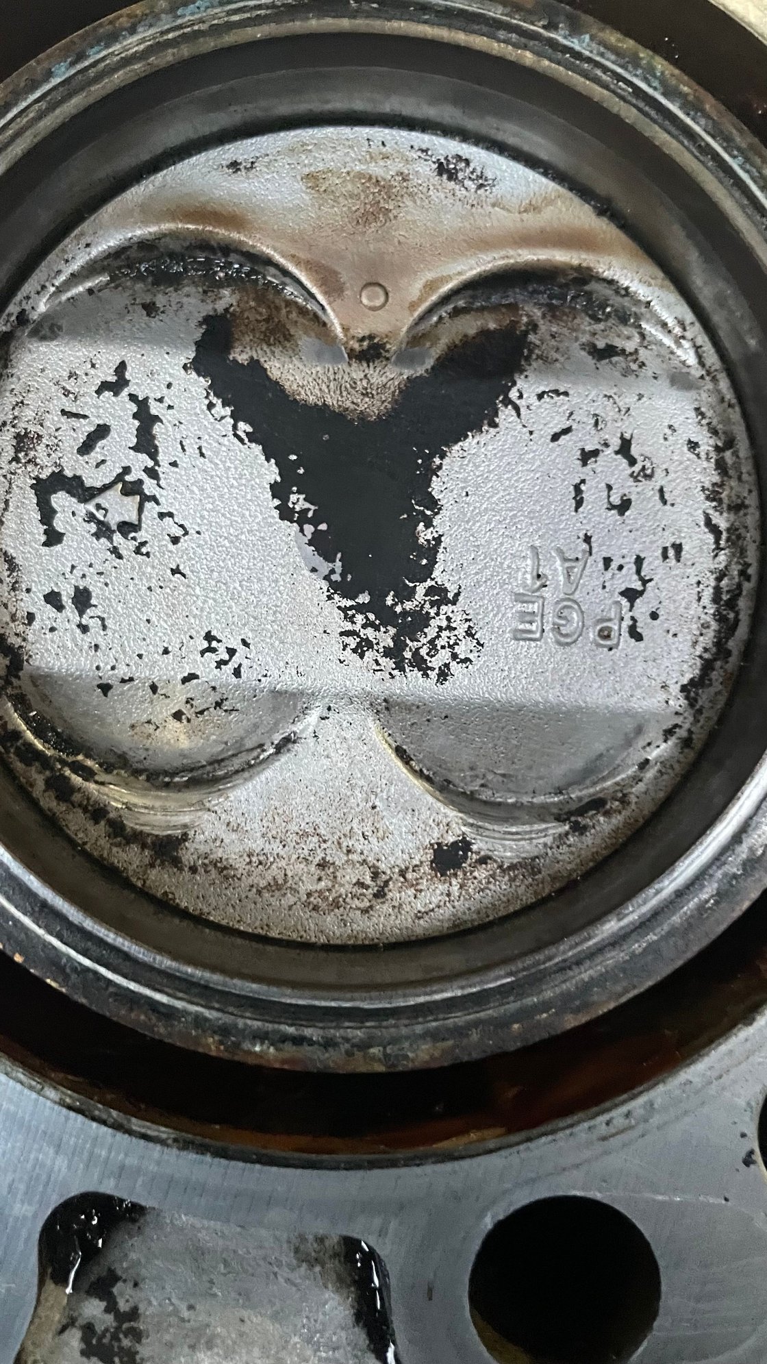

Used purple power and a brush to clean up the pistons a little there are some slight indentations @619rcr your expertise is needed sir

Old Jan 25, 2025 | 07:51 PM
  #46
Posts: 6,909
Likes: 2,211
Originally Posted by thousandcranescloth
They don’t look damaged from the timing belt coming loose so I don’t think any valves hit them but maybe someone can give me a diagnosis on what they see. It just looks like carbon build up to me. If someone can give me tips on how to clean those up, I’d appreciate it. (Head gaskets done August 2022)
They didn’t look bent when I shined a light to them a couple days ago but maybe yall would know more.

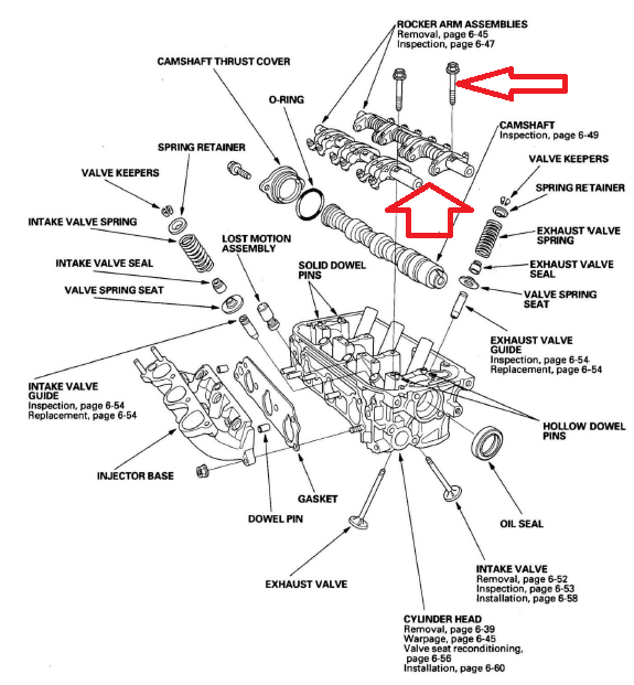

I've seen others on YT use a 50/50 mix of ATF & acetone to help clean-up the carbon.
With that said, theoretically, I believe you can easily 'liquid' test the valves to give you a 'quick & dirty' yes or no leak result.

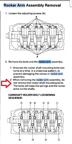

All you have to do is remove the rocker arm assemblies below, following the FSM instructions provided (especially #2 to keep everything together), lifting them (rocker assemblies) out of the head.
This will allow all the valve springs to fully seat the valves closed, as they sit in their current state, with valve spring tension.
Then flip the heads over, valves facing upward, making sure they look fully closed.
Of course, make sure the spark plugs are installed, then pour in some 'fluid' (water, alcohol, gas, lacquer thinner) to fill-up the space to the edge (red arrow) over the valves & observe if any leakage occurs from beneath.
Any leakage could be attributed to either slightly bent valves or perhaps pieces of carbon caught between the valve & valve seat?
In turn, indicating further scrutiny would be needed to accurately determine what is causing penetration.
Good Luck!
Good Luck!
when I do the liquid test, do I pour it in the case itself or where the spark plugs go? Also which liquid would be the least harmful to my engine?
The video below shows the use of water & will help give an idea visually on the test method:
My bad, meant to reply to this earlier. But, have been working on a side project of my own and haven't had time to respond.
It seems like you already figured out there was some valve contact. I was going to suggest what @zeta just said about checking for leaks.
But, don't skip over loosening and backing off the valve spring adjusters on all the valves, before removing the rockers. This helps to reduce tension.
The liquid test is good, but it can get messy. You can also check for leaks with a good flash light and a dark room (I normally do this before a liquid test). Simply turn the head upside down and hold the light over the valves while looking into the intake and exhaust ports one at a time. Be sure to move the light around so that you check from all angles.
Also, don't reuse head gaskets. There is almost always some indentations and degradation of the coating / transfer to the head or block. OEM gaskets are pretty cheap through P2R. Rockauto sells MAHLE / CLEVITE (which is an OEM manufacturer), but I believe the gaskets available in the aftermarket are .0040" vs a .0028" as would be found with an OEM. So you'll lose a bit of compression with a non machined head. Other brands are out there too, be sure to check the bore and thickness.

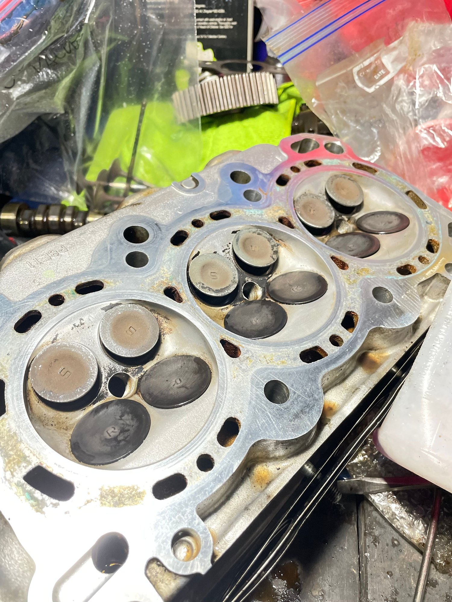

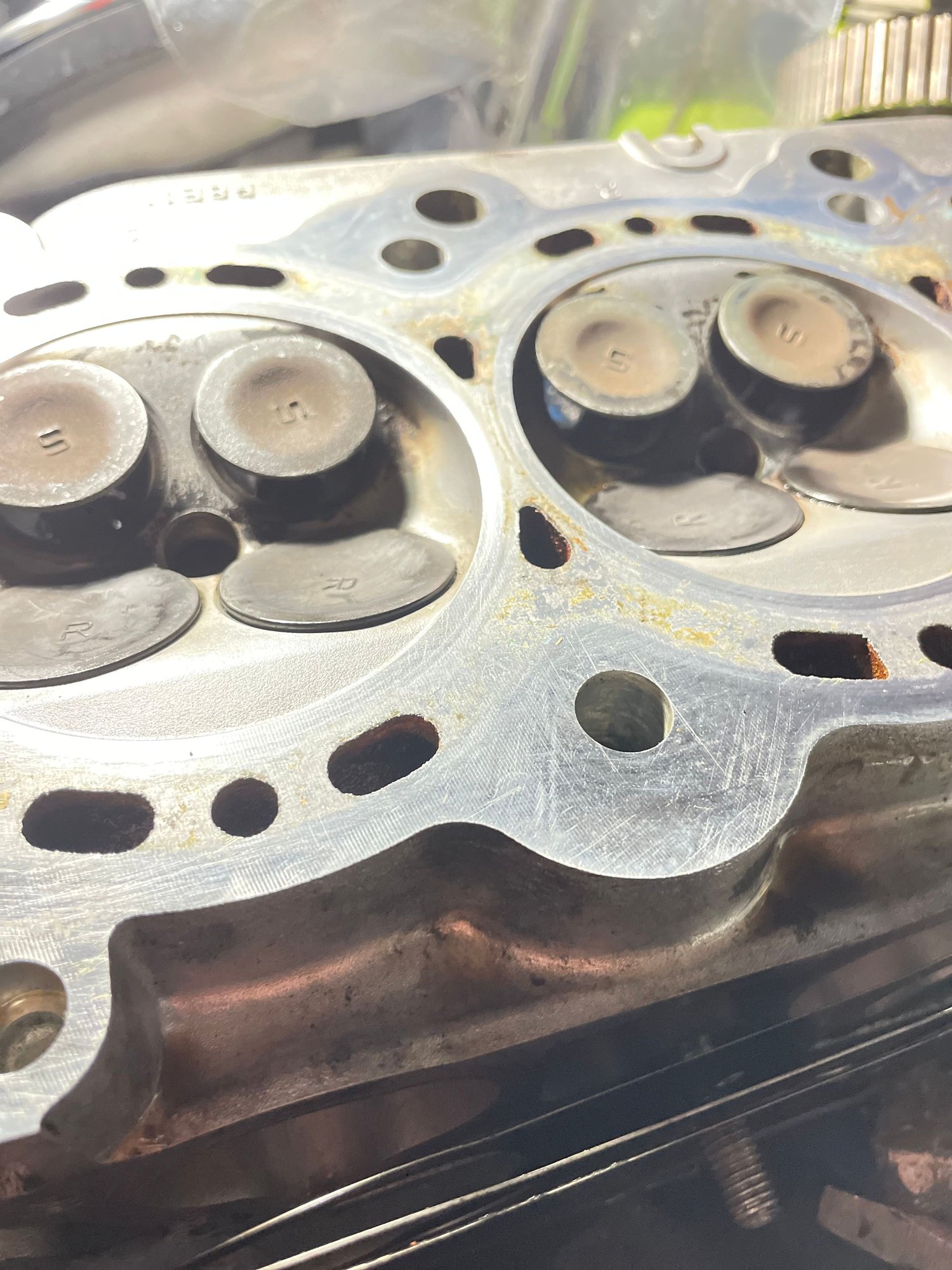

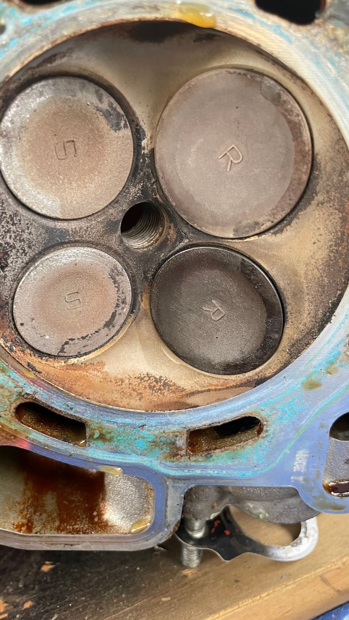

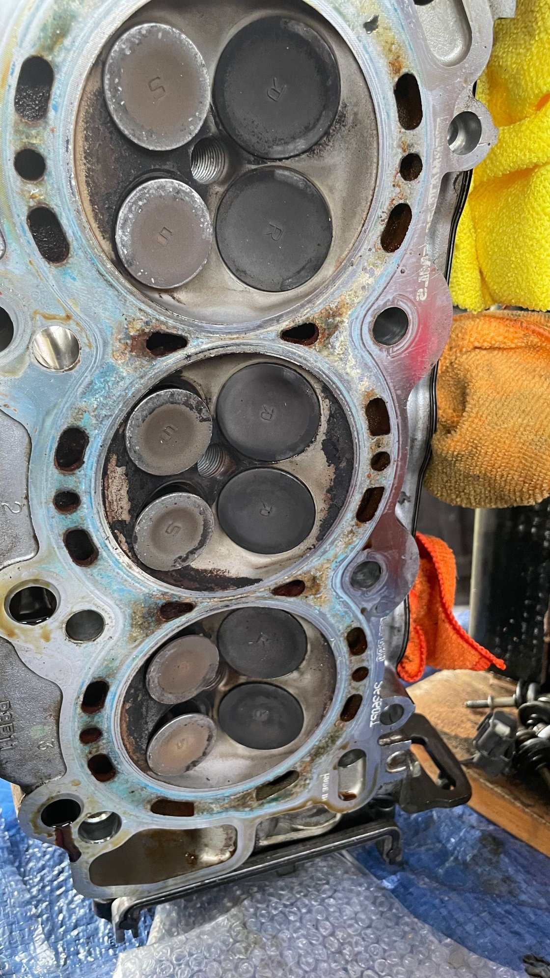

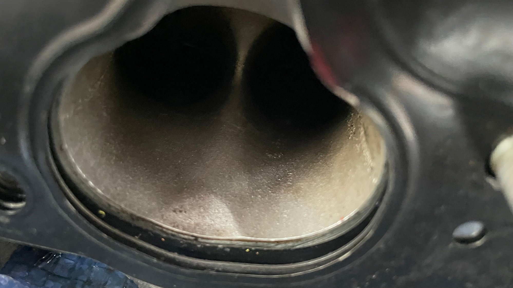

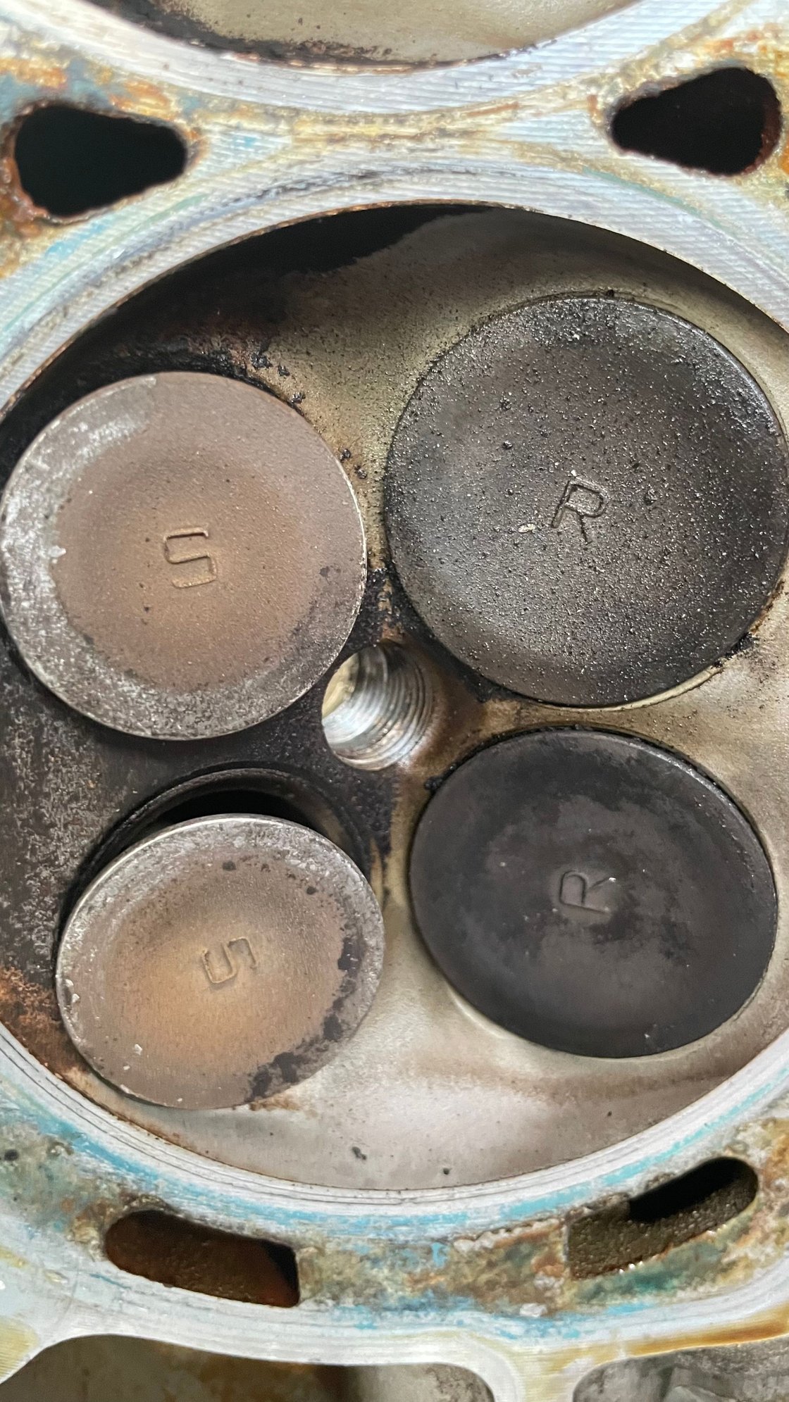

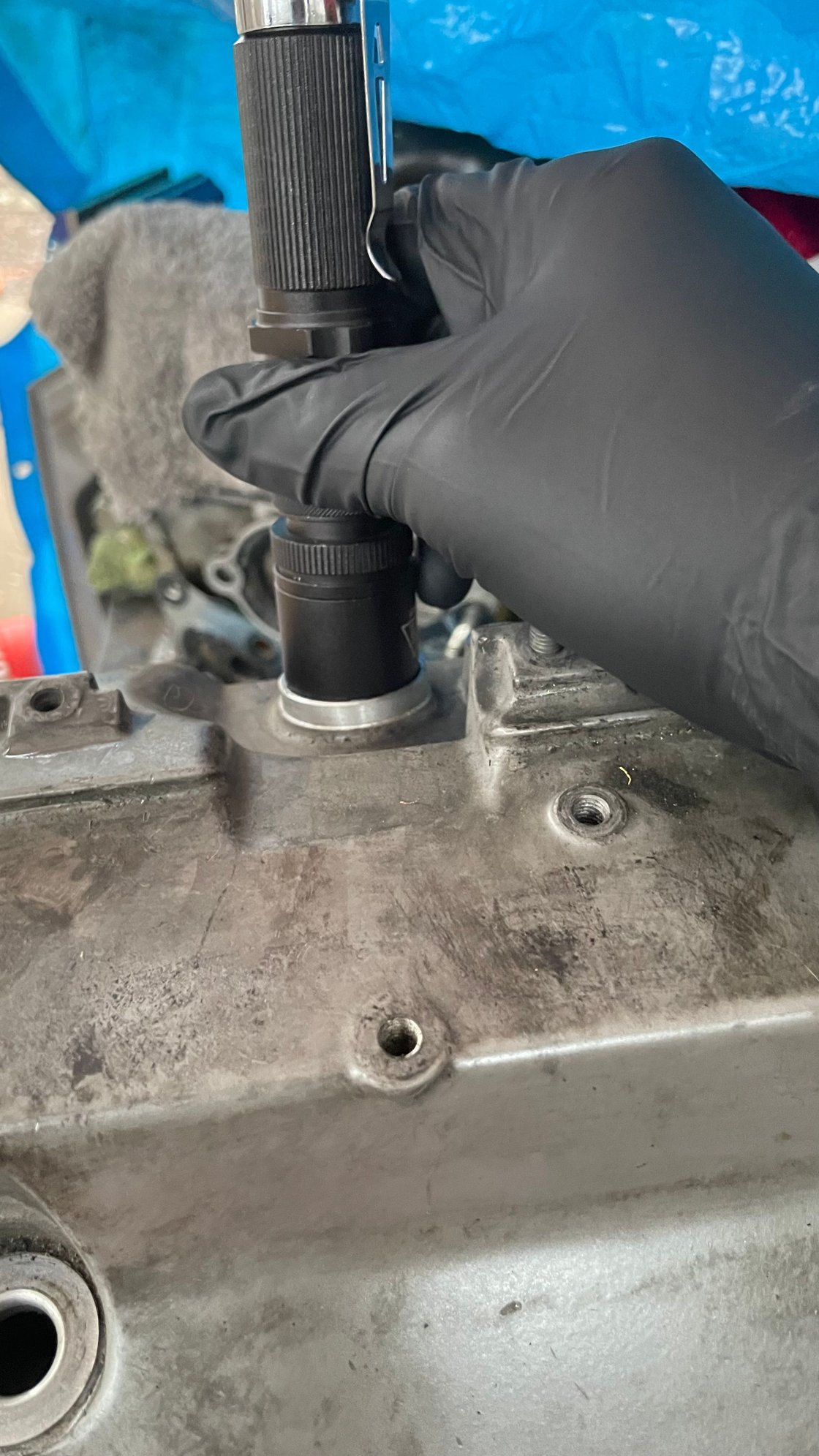

Just finished doing a light test first pic shows how I shone the light in. I started with bank 1, cylinder 3 first (rear cylinder). there was noticeable light seeping thru and none for cylinders 2 & 1 respectively. I then moved to bank 2, and all three cylinders has some slight seepage of light passing thru. (Pics attached). It is starting to rain so I will probably have to tackle removing the valve assemblies tmw, as I’ll be doing more research as well.
I presume I have to remove the valves and get a clear look at them before I know whether I need to lap the valves or just reseat them.
this is the first video for my introduction into part of my project
For reference, I’m just YouTubing “how to lap valves and reseat valves” and looking at different videos but this is just the first one (watching it as I type this out). As always, I appreciate the knowledge fellas
How I shined the light in the cylinder blocks
Cylinder 3
Cylinder 3
Cylinder 4
Cylinder 4
Cyl 5
Cyl 5
Cyl 6 — very slight leakage
uhhh, not quite. flip the head upside down and check with light from the valve side.
ref post #3 :
https://acurazine.com/forums/2g-cl-2.../#post16946848

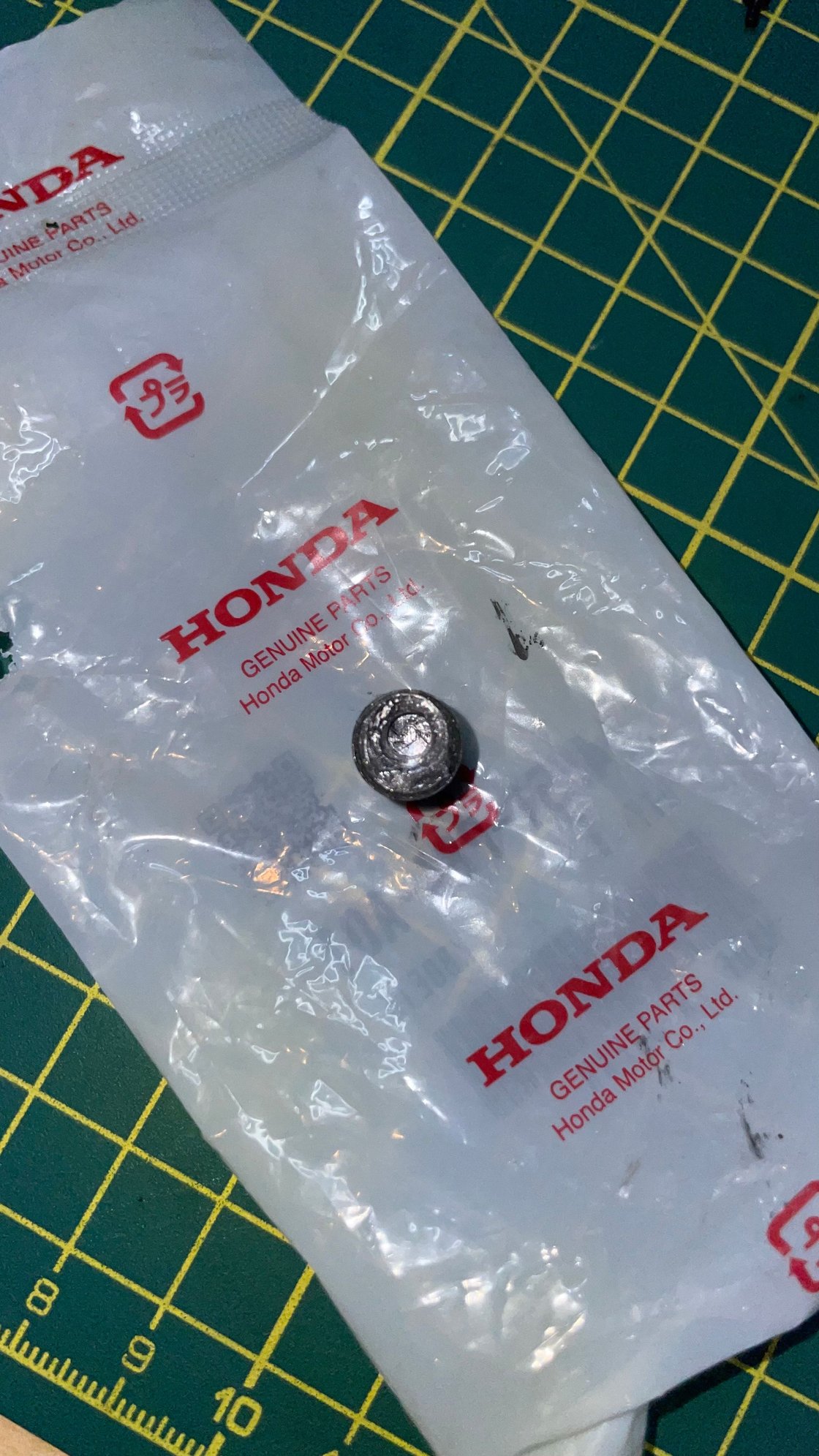

Pulled the part of the idler pulley bolt that was snapped in the engine block today.
1. Used a center point to mark it (difficult since it was deep in the block and couldn’t see it which is why the hole is off center)
2. started off with a left handed drill bit (in reverse) on the skinny side to make the initial hole then gradually increased in size.
3. Used decent pressure and would hit the trigger in one second bursts rather than a continuous pull.
4. Took about 40m in total — now waiting for my m10x1.25 tap to arrive so I can rethread it.

I discovered that all of my exhaust valves on bank 2 (front head) got bent. The intake and exhaust valves on bank 1 seem to all be good. I’m unsure of the intake valves on bank 2 because I’m unable to remove the exhaust valves atm and they’re blocking the intake valves from being removed.
Old Feb 10, 2025 | 07:34 PM
  #76
thousandcranescloth's Avatar
Joined: Feb 2024
Posts: 55
Likes: 10
From: Los Angeles, CA/Dallas, TX

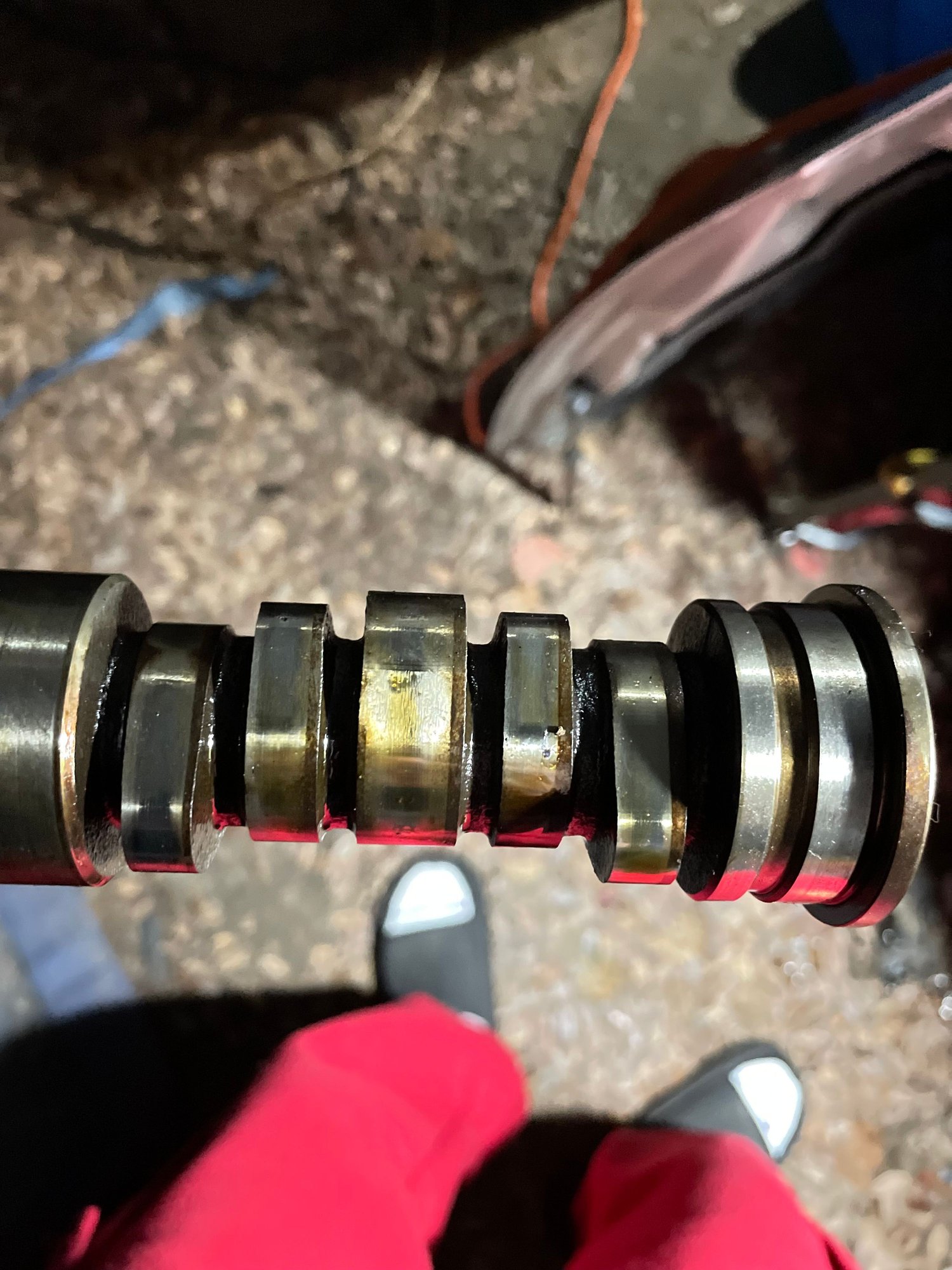

The camshaft on bank 2 also had some nicks. I wasn’t able to get all of them but i think there were three areas that had damage to them. I still need to remove the cam in bank 1 but I presume it’s in good condition being that the valves were fine.
Wow, def not ideal. What's the plan on the bank 2 head?

I just ordered some Ferrea intake and exhaust valves from p2r, along with seals. In addition, I ordered a new timing belt (continental), camshaft seals (mahle/clevite), exhaust manifold gaskets/head gaskets, head bolts (all from Victor Reinz), off RA. And i just ordered j35a8 cams off ebay so I'll be installing most of these, hopefully next wk.
I'm getting close to my budget for this rebuild but thankfully, I was able to use Affirm for my p2r parts which gives me breathing room. Not the most cost effective methods by any means but doing what i gotta do to get my car on the road while taking care of these components since im already this far into the engine.
How mandatory would getting upgraded valve springs and retainers be for this setup? Could my upgraded valvetrain still sustain with the oem springs? The upgraded Ferrea spring kit is $1k on p2r and that would push me well beyond my budget.
Just playing this day x day, week x week.. I know this project has been dragged out but god willing, i get this done by this month.

And i just ordered j35a8 cams off ebay so I'll be installing most of these, hopefully next wk..
Whoops, I prob should have mentioned I have a whole spare j35a8 RL motor. I stopped pulling cams from the junkyards because it took me over a month to sell the last set. Oh well.
Technically the 05 RL(j35a8) uses the same valve springs as the 03 CLS. What is different is the lost motion assemblies. So, you could get away with CLS springs if you're still on the stock limiter. I have 05 RL cams, rockers, valve springs, retainers and LMAs on my j35 prelude and its seen up to 7500rpm. I actually turned the rev limit down because torque falls off after 7k anyways.
You could get away with CLS springs if you're still on the stock limiter. I have RL cams and valve springs on my j35 prelude and its seen up to 7500rpm. I actually turned it down because torque falls off after 7k anyways.
GL with the new parts.
Lol, all good man. I got them for a little over 100 so not pressed about it.
Noted, yea i'm cool with 300-350 hp if i even get there. Not tryna do anything crazy to it. maybe a supercharger in the long run but no time soon. Just want a little extra kick and punch off the line and something to hang with the hemis for a couple seconds. but not interested in racing or maxxing out the car.
