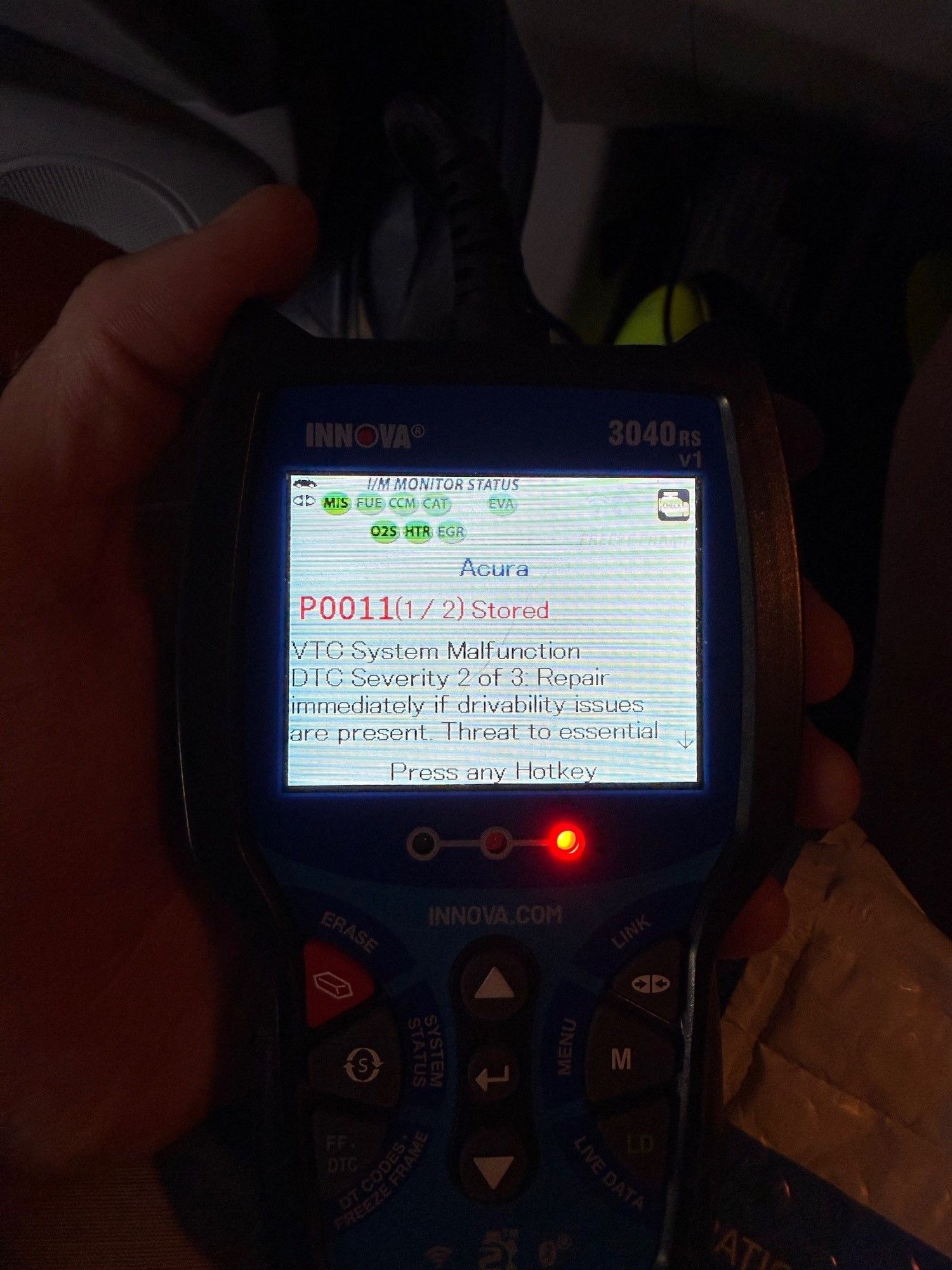

Exclamation 2012 RDX Tech P0011 VTC System Malfunction

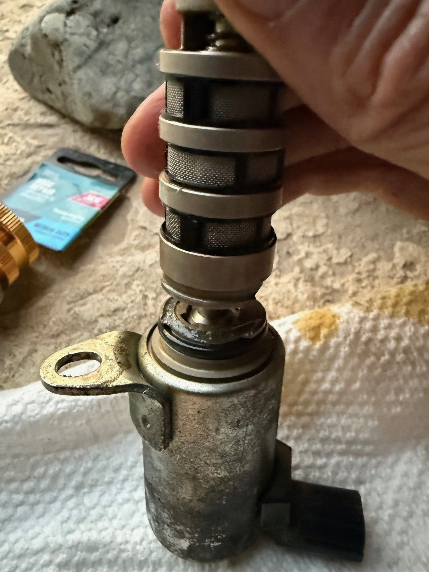

Hey everybody, I searched for this P0011 thread - apologies if this is a repeat. I've got a P0011 code showing up on my daughter's 2012 (148,000miles). I searched google and found the normal stuff to check (check / change oil, clean the oil screen, then check check VTC actuator, etc)
. I replaced the VTC Actuator - which was broken so I thought that would clearly take care of it. Unfortunately the code returned so I replaced the cam timing sensor (one of two), and it was weak at best, again, figured that was the key, but no, code shows back up after driving 25 miles or so. I have also been cleaning all connectors as I go and adding dielectric grease. It seems to run fine, but aside from replacing the other cam timing sensor, I'm not sure what my next move is (aside from taking it in to a dealership). Anyone have any experience with this? Thanks in advance.

When you mention cleaning the oil screen, do you mean the VTC strainer?

Yeah, I cleaned the VTC Strainer, and actually replaced the OTHER cam timing sensor to no avail. I guess I'm going to pay a dealership for diagnosis...

If going with the parts cannon method, seems like the next thing to replace is the VTC oil control solenoid.

Easy - I really appreciate the help. I actually already changed the VTC Solenoid (and it was broken - so I obviously figured it was the problem) - but no dice, still having the issue. I could have got a bad new part, but seems like a long shot.
