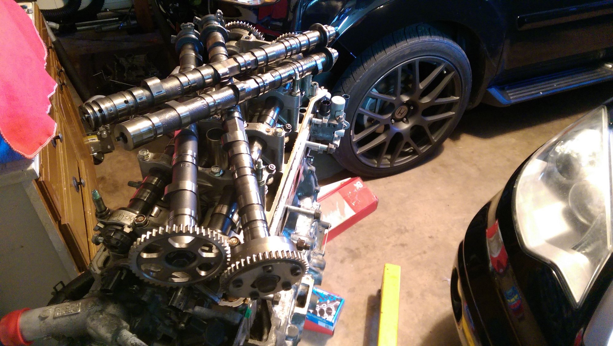

I remember these single valve spring

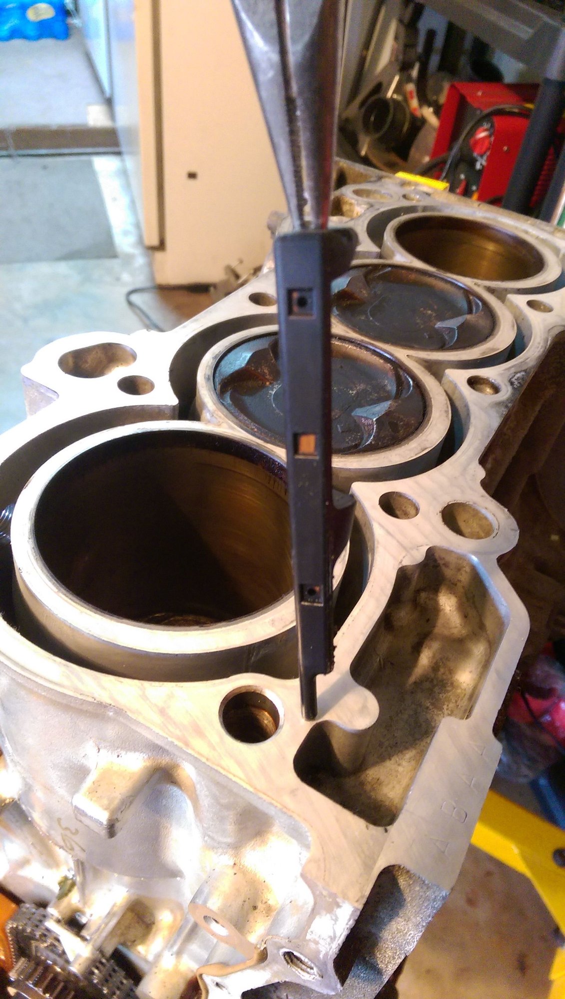

what was that thing a flow restricter?
What the head?
If you're talking about the block, I think it's to force the coolant to flow around the cylinder walls instead of just sitting there. I could be wrong. I don't see how else that bar would enhance anything else.
Yeah, I don't know... Here we have more photos of it up close.

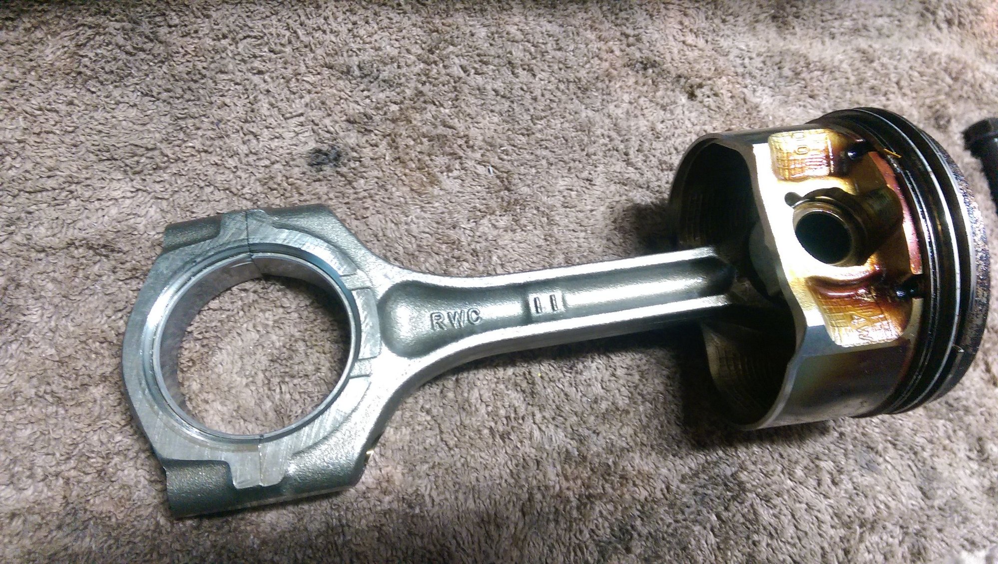

Tsx rods.

so TSX rods = off the shelf upgrades, right? and the bore is an off the shelf piston so drop in parts are good to go. or not so much?.?

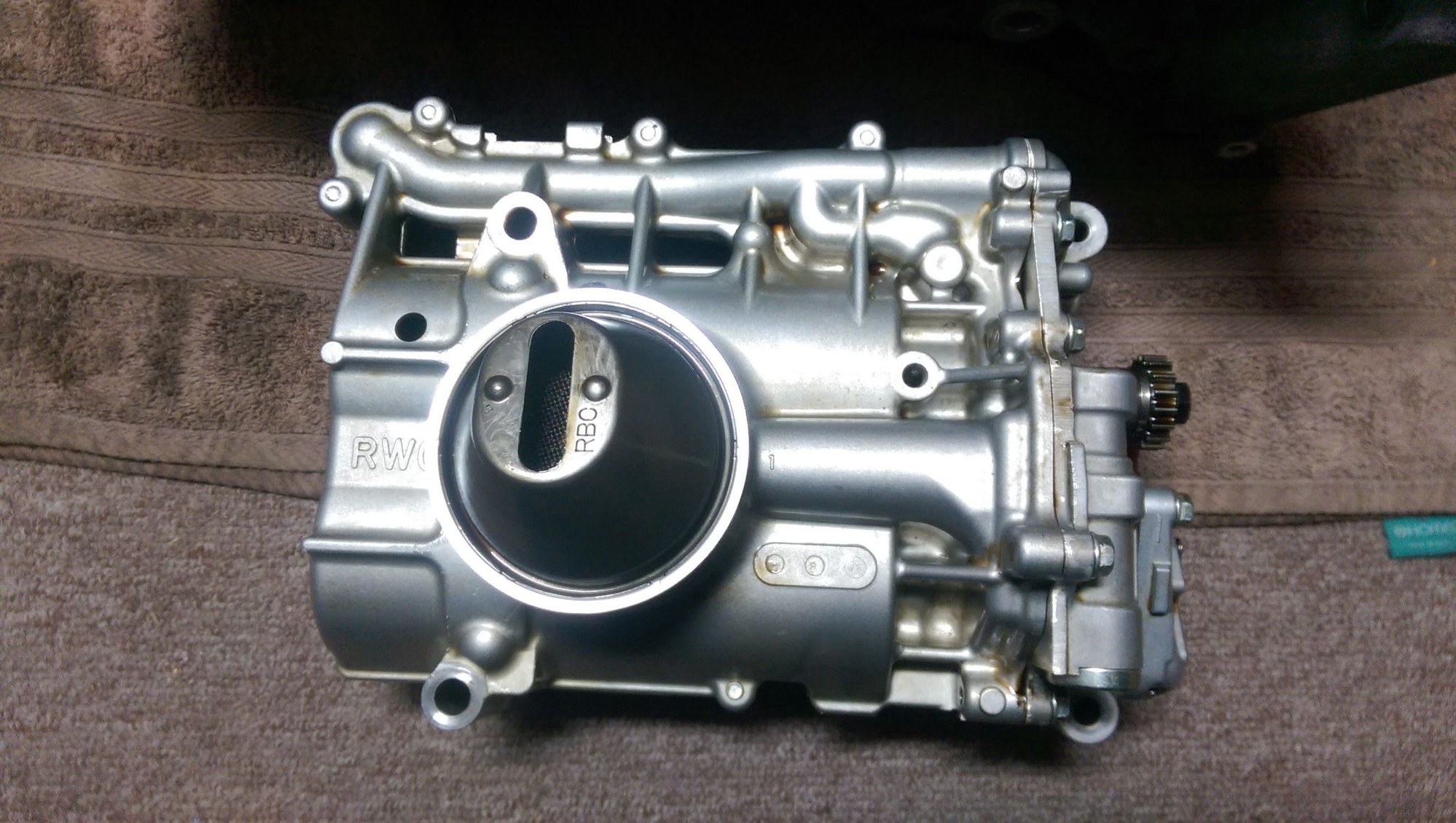

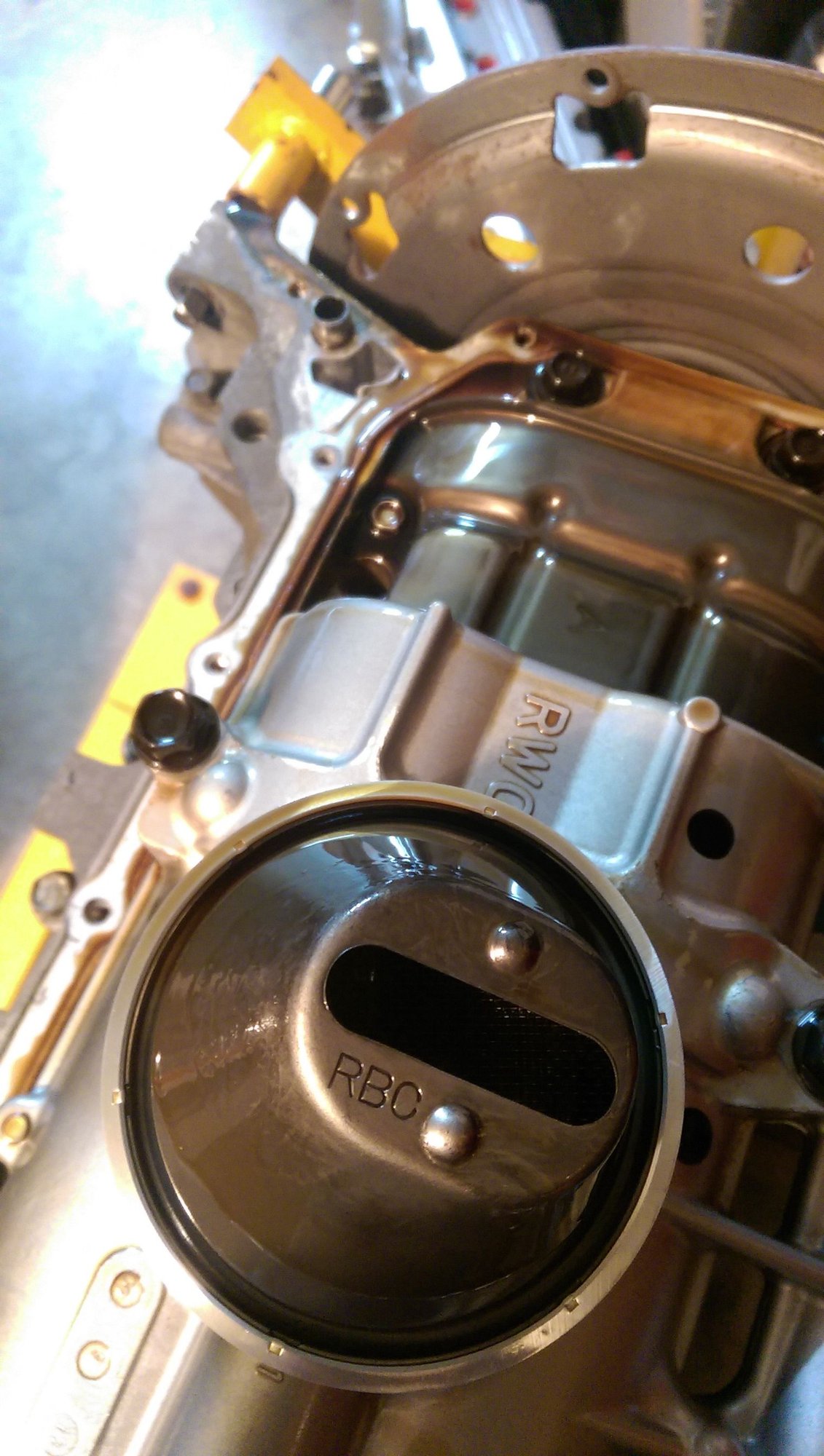

That is some oil pump
A view of the bare block with the oil squirters
The girdle
I guess it's a hybrid.?!
I'm going to take the block to get hot tank and cleaned up tomorrow, before sending it out.
I'm not to sure. There are so many RBC..RBB..RWC.. that i see when taking about the engine. There is a little of everything in this K23a1 for sure. It has the same stroke as the RBB (99mm); however, the bore is K23a1 67mm.

Those arent tsx rods. Different part numbers. And bore is 86mm

It would be a good idea to look into a type s oil pump. Most of these twin screw type pumps don't flow oil enough in higher rpms. Or look into a K20z3 oil pump. They're the same type as this rdx pump. I know they've been to 8600 on them. No sense in having a built motor and only going to near stock redline.
From the research I've done, it's a modify/bored type-s pump. I'm not sure that will fit. I have at least 3 months to look into oil pumps though. I don't think you have to rev to the atmosphere in order to get power from this thing, gauging off of my current set up.
But, I will no long be running 86mm. It will be 87mm with the sleeved block, so with that I'm thinking I'll have a 2.4l after it's all said and done.
Some sort of hybrid I'm sure. I know about the 86mm bore and that is most likely why it's a 2.3 instead of a 2.4.

Not really a hybrid. Rdx has its own parts others dont use. Honda more than likely chose 86mm over 87mm to have a thicker sleeve being boosted.

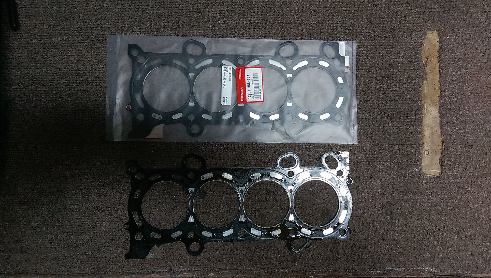

Just ordered a tsx head gasket, also looking at the S2000 oil pump, K20 head.....

You should order a gasket for the rdx. Not all gaskets are the same. Coolant cutouts are different on some. Always a good rule of thumb to order the gasket for the head you'll be using. S2k pump will be overkill. Type S is almost half the price and will be just fine to 9k. Might run into clearance issues with the oil pan. I believe the 9th gen Si's deal with this issue as well and have to modify the pans.
I'm aware the prices of everything that I research my man and I know the modification that are needed. Thanks though.

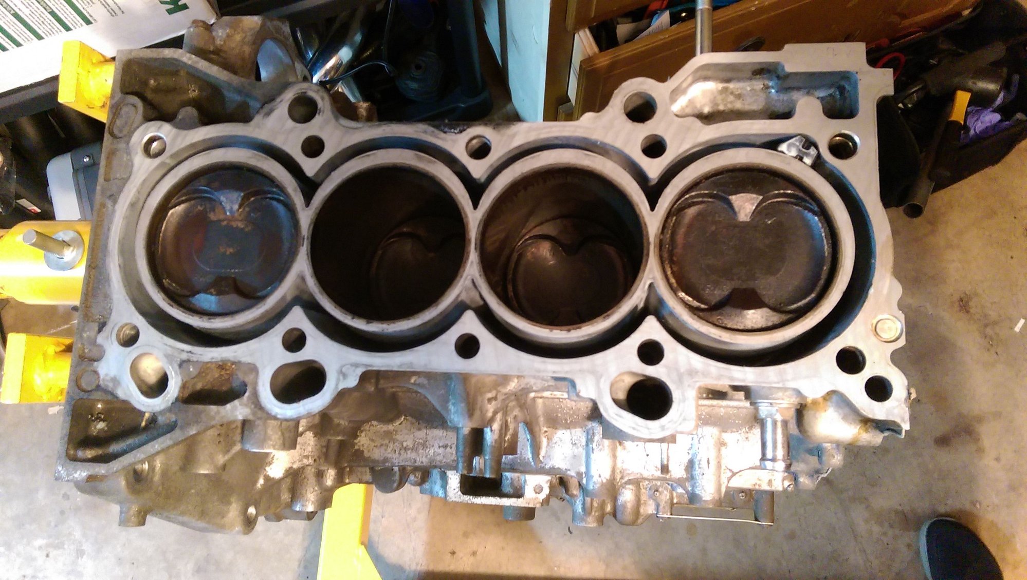

First stage of cleaning. The reason I say, because Drag Cartel will be cleaning it again. I just wanted to ship a clean leak free block to them.

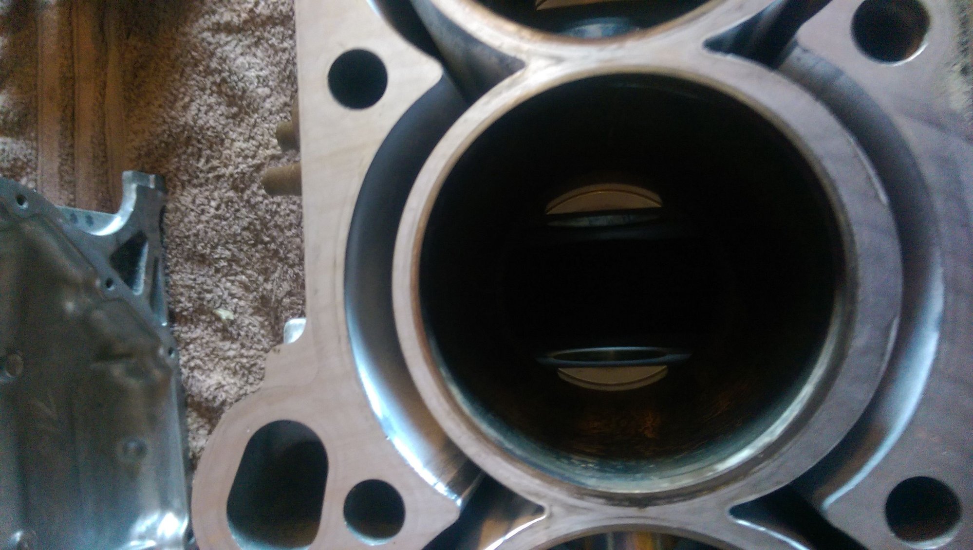

Sent over these pictures to Drag Cartel so they could confirm that the block is open deck. Things are looking good so far!

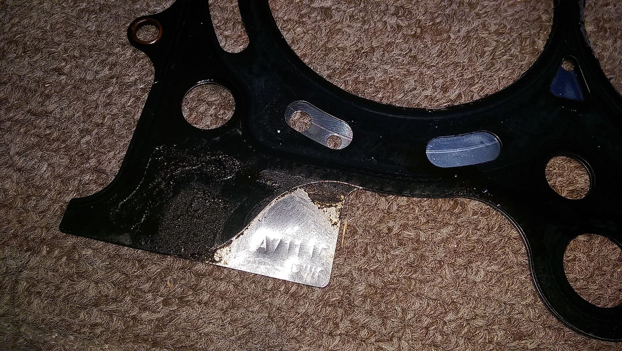

They are pretty much identical; however, there are two extra holes in the water passage on the two middle cylinders (rear of gasket). I would assume that is for the turbo manifold cooling. Other than that, it's going to be a good match.
