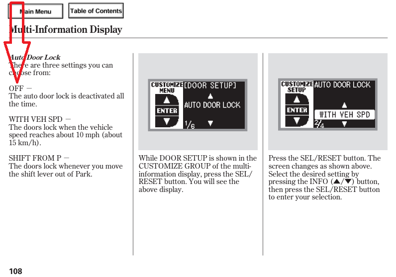

Maybe experiment by deactivating the 'auto door lock' system functionality entirely first in the car's computer; thusly, only using the key, not the fob, for opening or locking.
That way the systems thinks you will only be using the keys for locking / unlocking?
Since the car alarm functionality is disabled with the battery power disconnected anyway, at this point, all you need is to get the car locked, for the night, and hopefully keep the alarm from going off upon morning battery reconnect & start-up.
