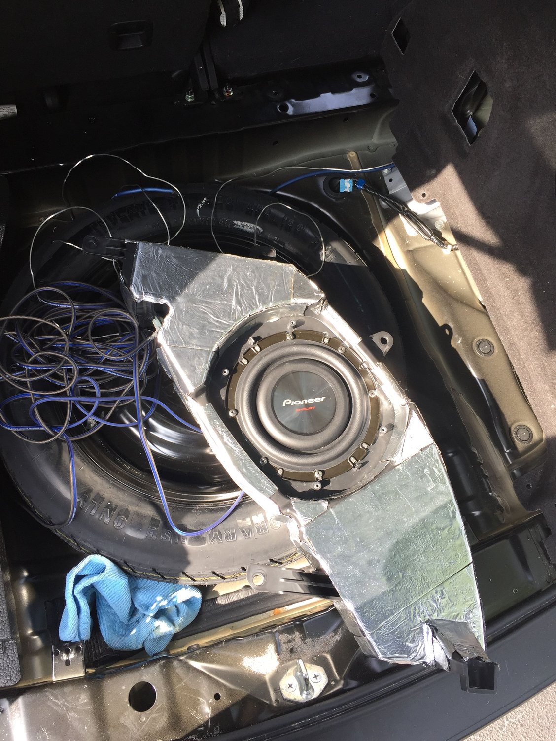

xxiaze's Avatar
Joined: Apr 2016
Subwork
Pioneer ts-sw2002d2 is a direct drop in except for new mounting holes being drilled with self tappers.<br/><br/>Just completed an audio makeover. <br/><br/>Sounds great.
