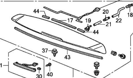

No its not the WHOLE TAILGATE!!! It is the part that has the brake light and hole for the back windshield washer fluid like the picture below. The part that SITS AT THE TOP of the window!
That part is this:
Clear as mud now?!

ahh so the tailgate spoiler... not the tailgate itself
https://www.oemacuraparts.com/v-2008...ning--tailgate
533 here

so in the back of the car above the headliner is the AM/FM antenna amplifier unit (part no 8):
https://www.acuraoemparts.com/v-2007...ntenna-speaker
You have to remove a little bit of the headliner to access it. Follow the wire to the the tailgate end and you'll find the broken wire/antenna. You can probably replace it from that part or plug it into the antenna amplifier.
