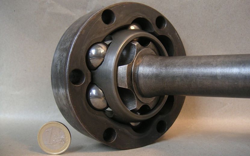

Cannot say without looking at the bearing, but usually "click sounds" = permanent damage to the bearing journal..

axle bearing inside the boot?

Yeah the ball bearing inside the CV:
