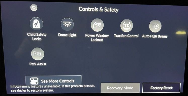

Chiming in from Southern California to share that I'm living with a bricked Infotainment system right now as well. Dealer was able to do Vehicle-Wide Programming update and the K73 Telematics update, but the A11 Radio update kept failing. Sent me home with the car until Acura HQ gets it fixed on their end.
According to this Reddit thread, there's a rumor of a corrupt software file from GM. https://old.reddit.com/r/AcuraZDX/co...stion/ngraob6/.

Sorry to hear this, so is the infotainment completely dead and not even showing the Acura animation? Or is it stuck in the recovery mode page (the one that shows up during rebooting by holding the hang-up switch on the steering wheel)?
I suspect the root cause is a recent change on GM server that delivers different infotainment software based on infotainment part numbers. On the AC Delco TDS website, there is now a drop-down list when selecting infotainment update. From what I can see, MY24-25 have SQBR5/April 2024 security update, but MY26 has something else, either SQBR6 or the latest UQBM.
I don't know if technicians need to manually pick the infotainment part number when updating through SPS2. If the answer is yes, it is highly likely that someone chose an incorrect part because there are quite a few choices in the drop-down list, at least on the AC Delco website. MY24-25 seem to be 85xxxxxx.

Sounds to me your infotainment still works, just that the update couldn't go through, right? I hope your service department has contacted Tech Connect for help. Usually they start by ruling out simple things. For example, make sure the USB drive is formatted into NTFS. Other formats don't work.

The Infotainment is stuck in the recovery mode screen. Tapping Factory Reset doesn't do anything but the other functions on the screen still work. Rear camera still works, although at times it gets washed out and colors distorted pink. Not sure if related. Wireless phone charger doesn't work at the moment as I imagine it's tied to the Infotainment system.
The service department had my car for 8 business days and supposedly spent numerous hours with Acura HQ to try to resolve. I mentioned Job Aid 26913 that was updated recently. Technician said something wasn't working on the Techline Connect side. They gave my car back because the dealer was relocating. Waiting for them to reopen to take it back.

Originally Posted by swannyva
I hope this is my last update on this thread I started - I picked up my ZDX today on day 40! The dealership was told on 10/21 to order a new radio unit and program/update it. I was told on 10/23 that the programming was "incomplete," in that "not everything was there." They were then told by Honda that the process for updating had changed and that an Acura Tech would visit the dealership today, the 27th to program another radio that the dealership ordered and installed. Kind of like the bomb tech telling the guy in the field "cut the red wire, after you cut the blue wire!" Seriously after bricking the second unit, the dealership was told that the update process had changed. BTW, nothing was happening until I put pressure on Acura Client Relations! Due to previous commitments, I was only able to drive the 18 miles home today, but everything seems to be working!
John
Although somewhat unrelated to the reason I started this thread, I thought I'd provide the latest issue here anyway. I took my ZDX in on 11/7/25 as I noticed the day before upon entering a street with poor visibility (road curvature) a thump in the rear as I "punched" it. (This car has incredible thrust!) I immediately noticed loss of regen braking and a couple pop-ups in the display, like "One-Pedal Driving Unavailable - Use Brake for Stopping" and "Service Brake Assist." I also lost cruise control, rear emergency braking, Speed Limit Sign displays, and who knows what else! Note this happened 10 days after getting the car back after 5 weeks in the shop!
As for this repair experience, it seems there is trouble at Acura in that folks can't seem to get out of their own way! Although I was reluctant to drop the car on a Friday, it wasn't deemed safe to drive by me or the dealership, so the fun began. Primary ZDX mechanic doesn't work weekends and starts at 1:30 Monday. As of Tuesday morning, 11/11 he hadn't finished doing the work the Techline folks required even though Code C2A22 had been logged - checking all cables, hoses, and connections, because they had replaced the Brake Simulator (previously known as the master cylinder) in February. After finally submitting the required reports late Tuesday and waiting 2 days for a response, I was told the Service Manager authorized the part replacement as the DSPM (district service parts manager) was on extended leave (She or he was supposed to make the decision)! BTW, I'm quite sure that happened due to my calls - we're all on a first name basis by now!
The car is back and seems to be working fine. Meanwhile, while the car was at the dealership, Acura had a contractor replace the JuiceBox from Enelxway with a highly rated 48 Amp unit from Emporia! Who saw Acura doing the right thing there? They surprised me, but I'm sure there is more to the story!
John
