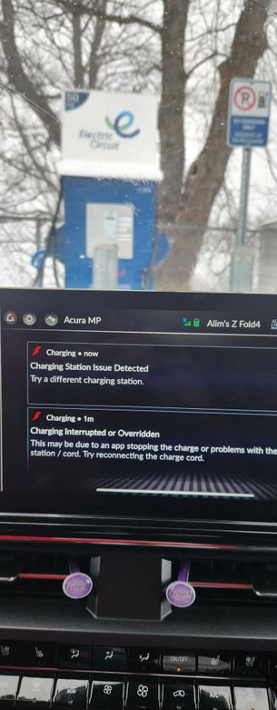

I had similar issue (started during my trip from Ottawa to Toronto during a storm). Dealer couldn't solve it.... but they reset all the codes and wash the car. Problem solved. Technician said that there is a sensor at the bottom of the car where manages breaks and regen, if that sensor gets dirty, it will block things in software for safety reasons. To be honest, I started to wash my car properly (touch less carwash ) and I haven't had that error since.
I can only HOPE it's that easy...
Good thing for me then, I wash my cars weekly, wax every other week.
underwashing is the key and make sure that all raised codes has been removed.

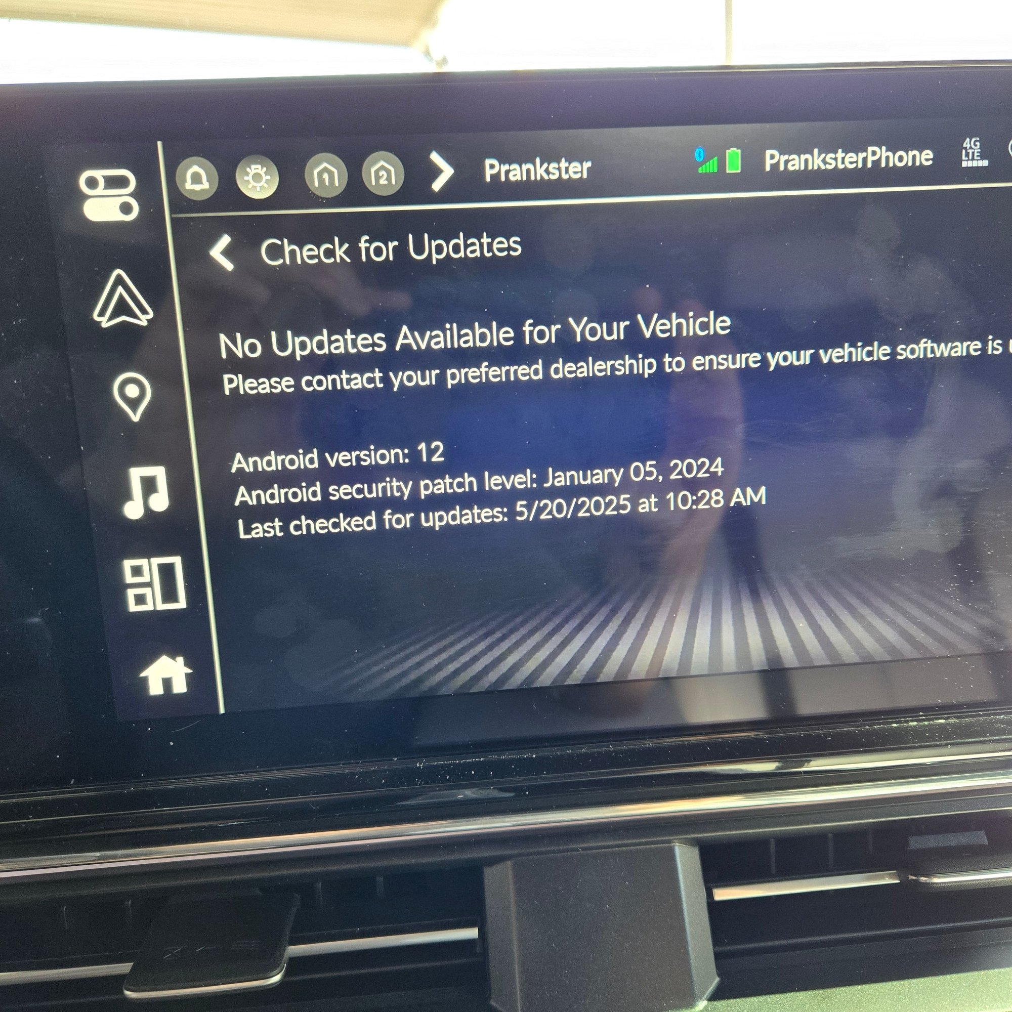

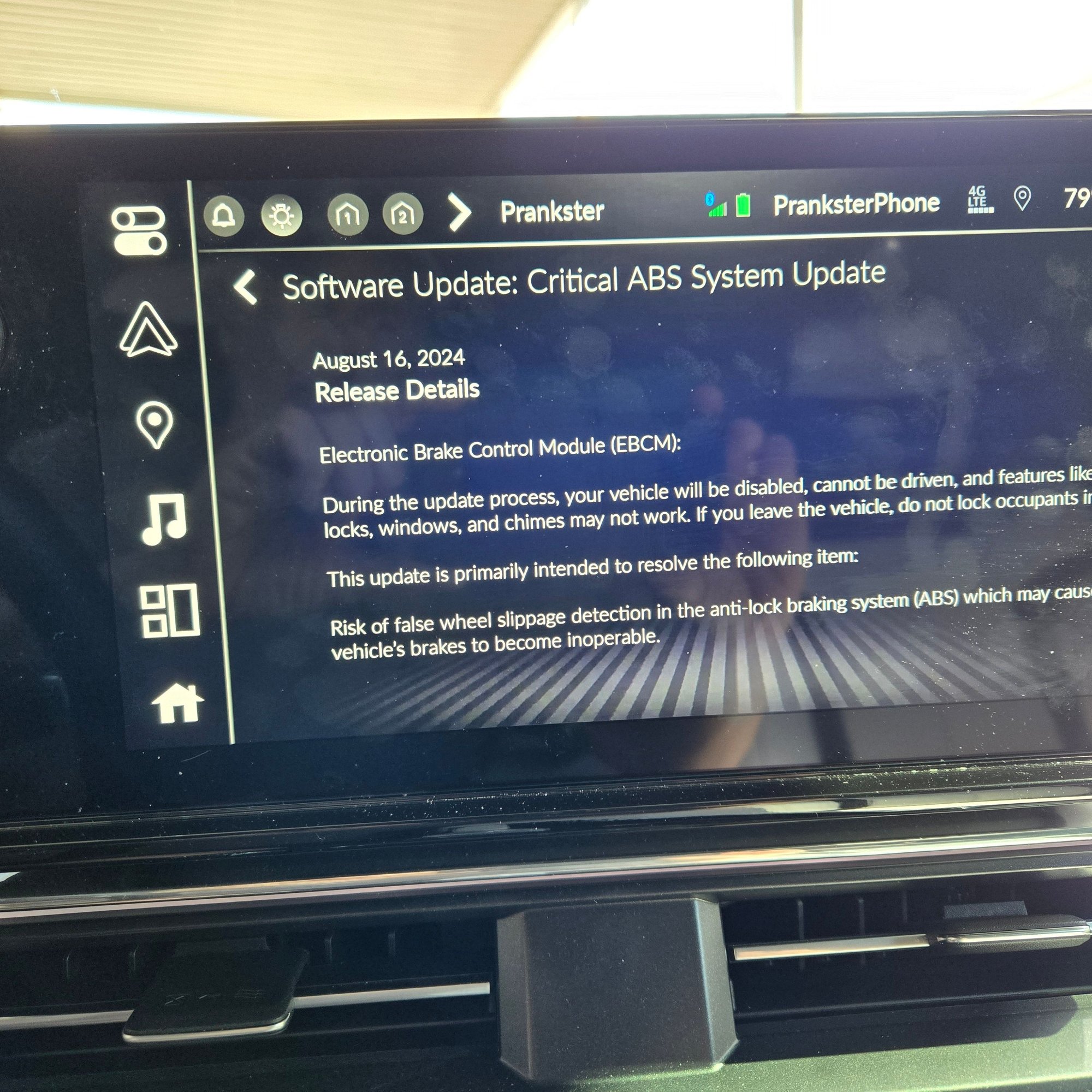

Have your car received any OTA update? FYI there are reports from other Ultium cars that after BECM OTA update, the car ignores charging limit/schedule until the settings are toggled again.
Hope this incident is just that. Good luck!
I have no idea if it did or not. How do I check?
I escaped on a mini vacation and the charging worked the whole trip, although is was all DC fast charging along the way. .
I have no idea if it did or not. How do I check? I escaped on a mini vacation and the charging worked the whole trip, although is was all DC fast charging along the way. .
Go to Settings > Updates > Updates and History. OTAs are listed as "Software Update: xxx."
Looking at the images I posted, the update was long before I leased the ZDX.
