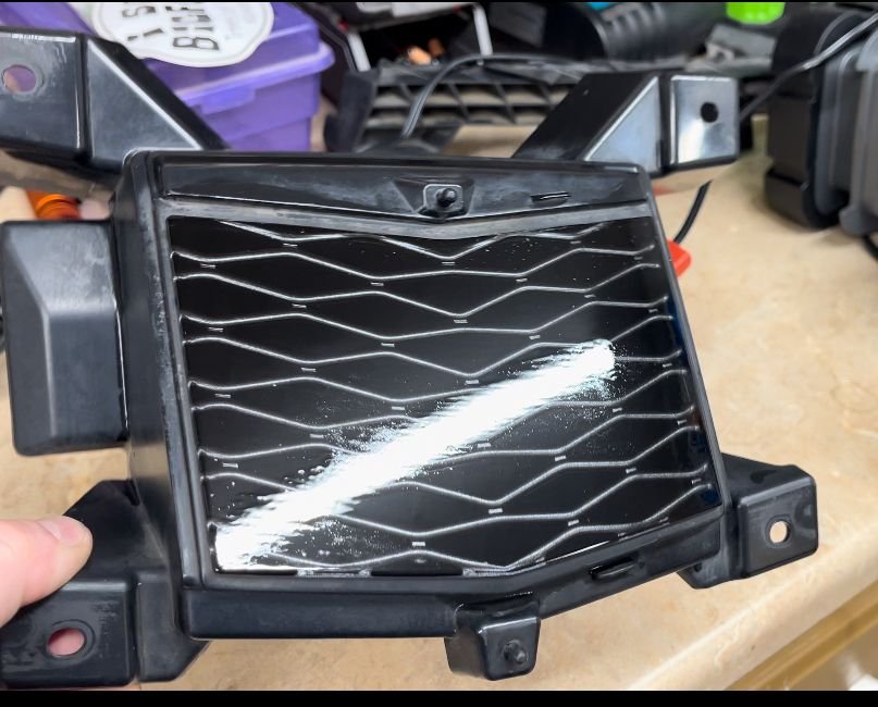

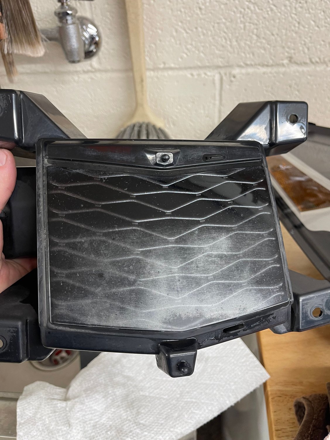

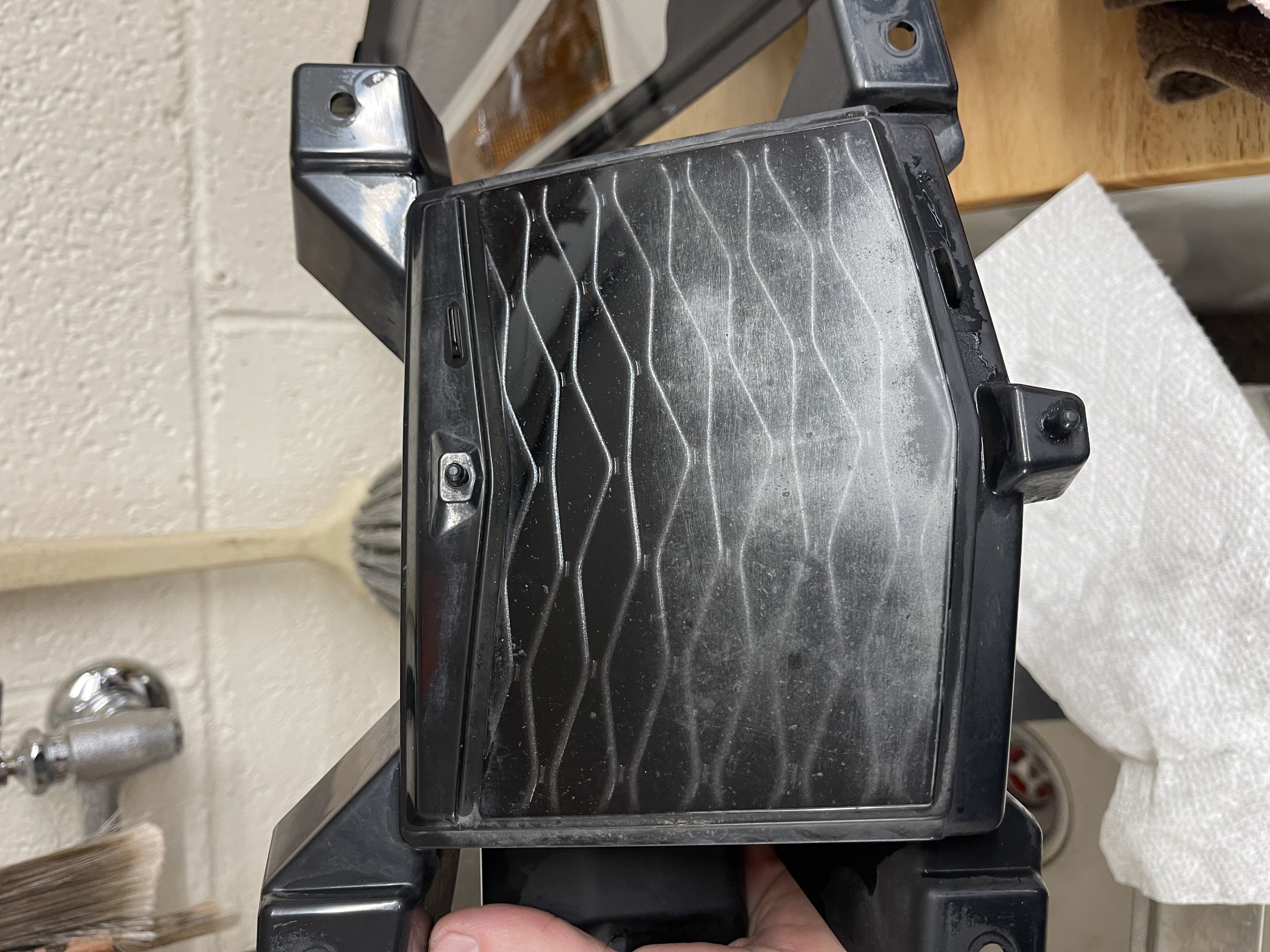

Restoring the front radar
Here’s a before and after using the Sylvania kit
File Type: mov

Thank you for the video/photo. I'll try that as a fix first.
