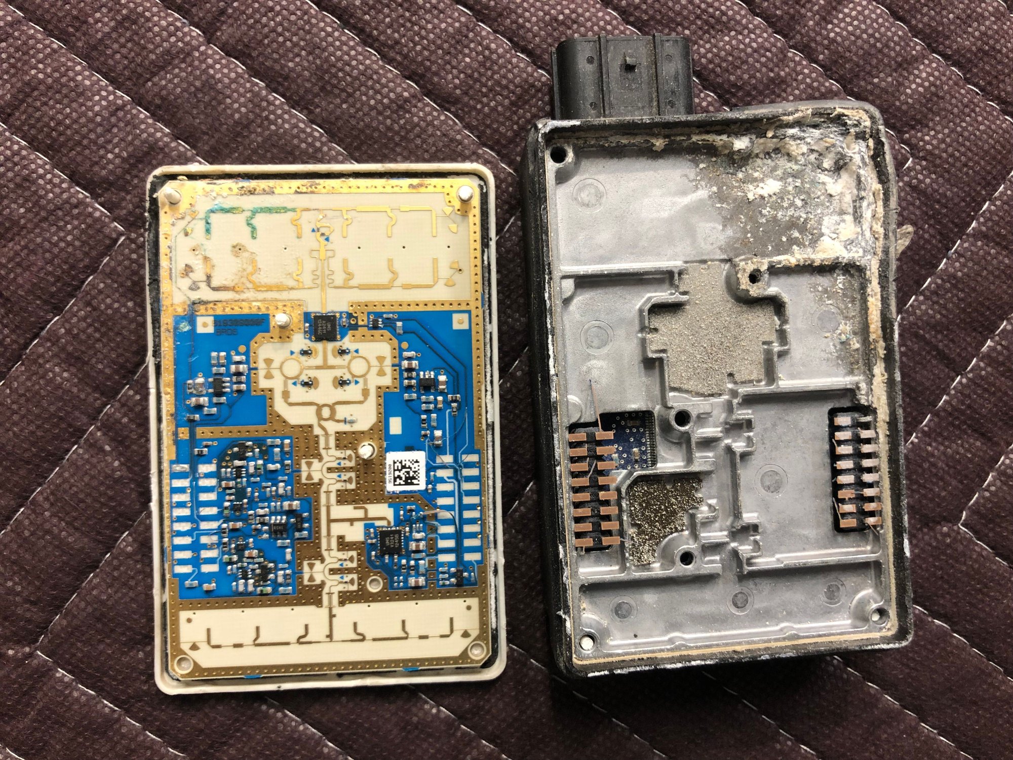

changed bsi radar, everything works. Thank you all for your help.

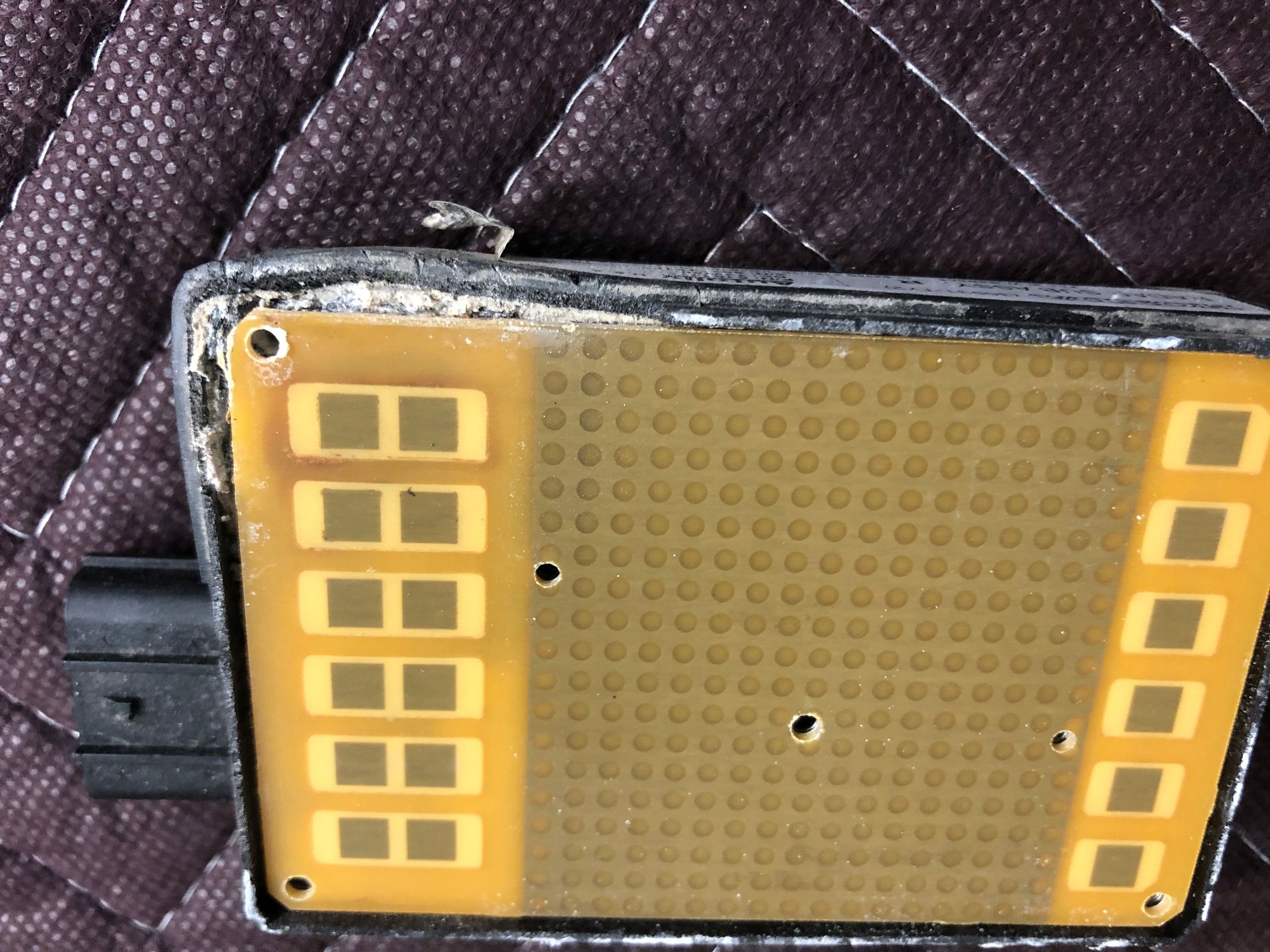

Did the unit just fail or was it some other problem like corrosion, water, or road salt issue with the unit or connection(s)?

It was corrosion, water, or road salt entered into the box.
